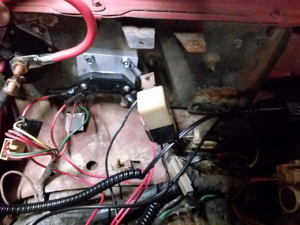

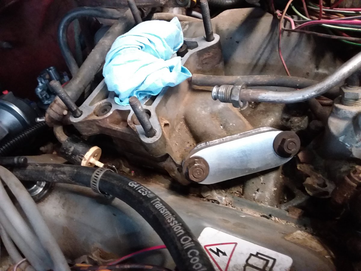

Also snapped a couple of pics of my HEI mount on the fender and my EGR block off plate.
