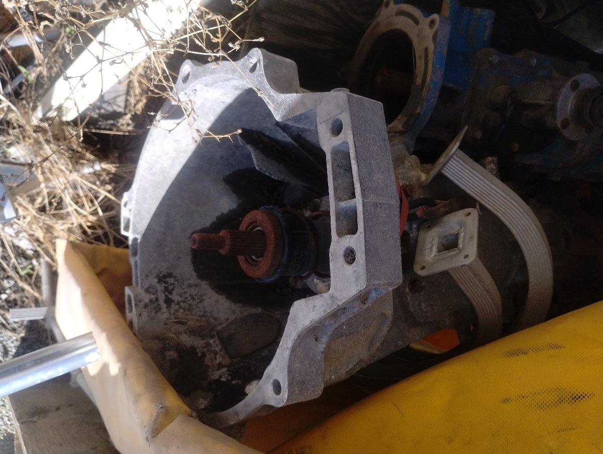

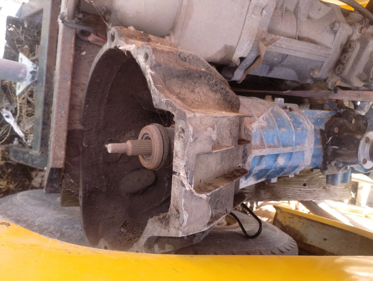

Hey All ... This is Ukuva "stuck" in Cape Town South Africa with a 1984 LHD Bronco II 2.9ltr ... and ... a "smashed" Bellhousing and ring gear with the Bellhousing stamped code of E47A-7505-EA ... does anyone know of anyone that i can buy and have shipped the 2 items to Cape Town South Africa ??
Most of the members on TRS are based in North America. You may have some luck and maybe cheaper shipping costs trying some forums and business based in the UK. I'll take a look at what I have shortly and post back.
Where do I find the code? I have 2 possibilities. See pics.
When I looked up that number, I got a few references to the TK4/TK5 with an external slave. I suspect that's what the OP needs for their 84.
Can OP post a picture of the transmission from under the truck? Also confirm 2.8 or 2.9? Here 2.8 would've been standard for 84. IDK about overseas though or if OP has a franken-truck.
Also, if shipping from UK is desirable, it might be possible to consider parts from a Ford Capri. I can't find much on the transmission options available for them but, considering some were sold with the 2.8 and manual transmissions were more common in Europe...
Interestingly, this thread is the 7th result for that number on a Google search.
