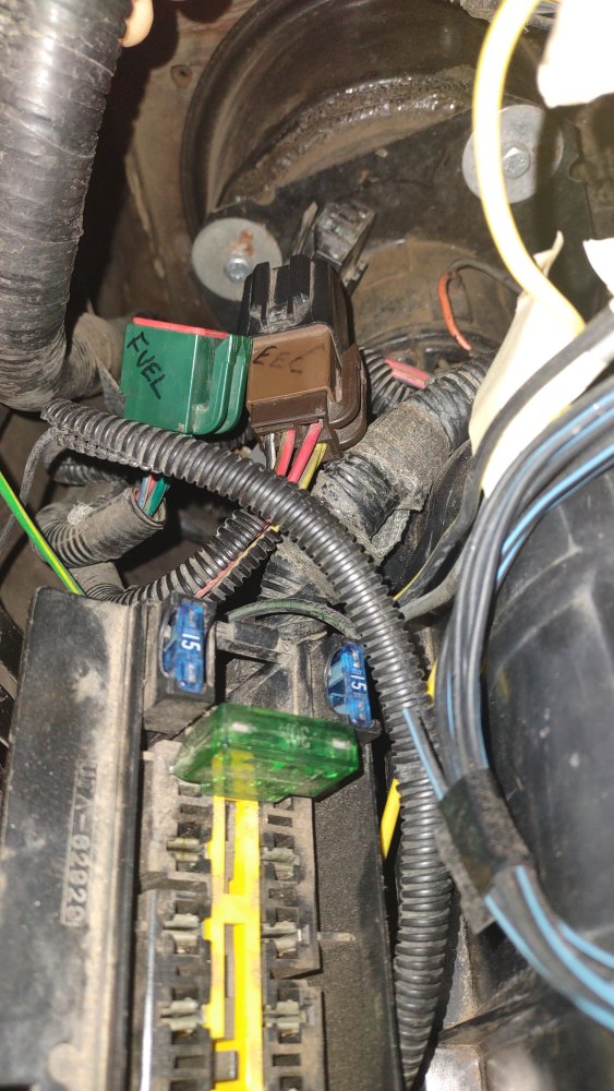

I've gone back a few steps - the fuel pump relay isn't closing. Eec relay is closing and sending voltage to the fuel pump relay, but voltage isn't going through it.

Fuses are good. Even with key off I'm getting 12V to the fuel pump relay on the yellow wire, as I should. I pulled the relay out and put a jumper in the block, and the fuel pump kicked right on. So why isn't it closing when triggered by the power from the eec relay? I would think it's a bad relay, but I've tried another known good relay, and no change.

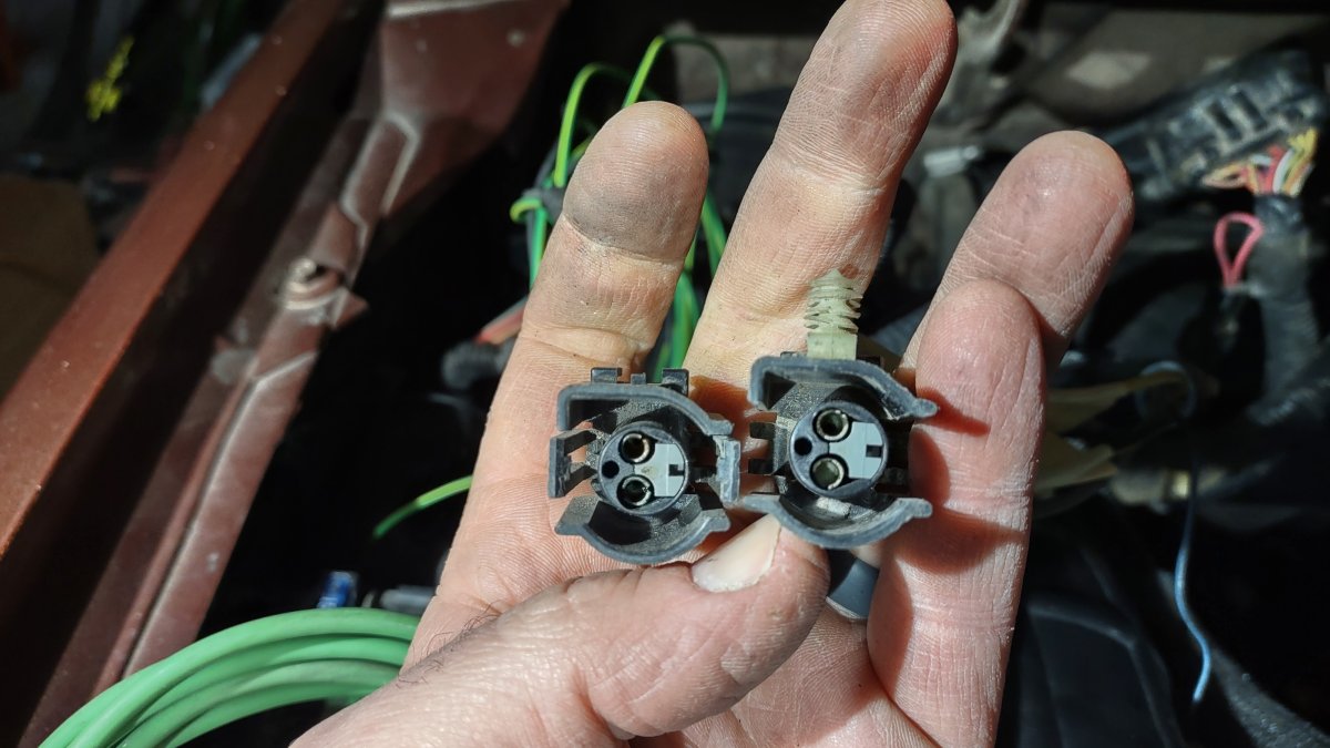

So my relay problem ended up being a ground issue, as you all led me to. Specifically, PCM ground.
So who's up for a game of "Name That Connector"? Discovering that these two connectors are identical led me to the solution.
