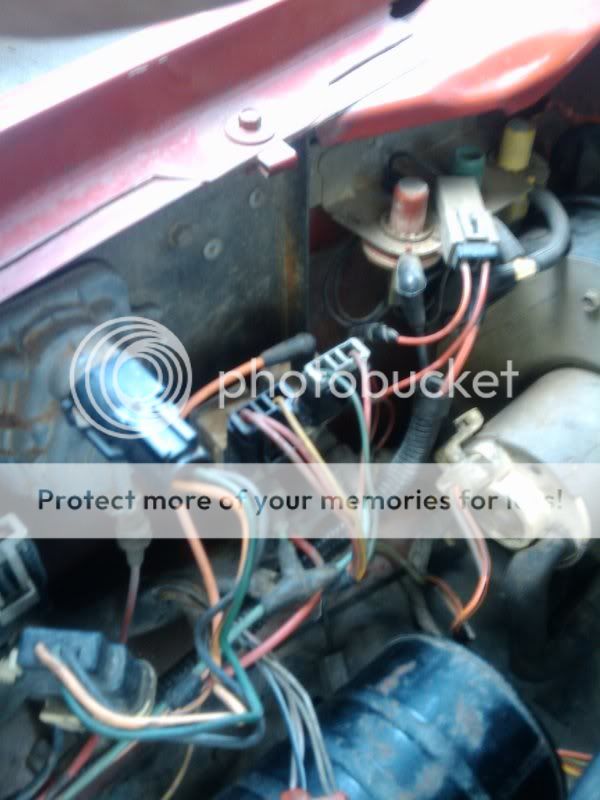

3.Noticed a clicking noise near the vac/electic stuff on the left
4. Found the source area its the 2 plugs and 1 vacum line on passenger side aboive the labeled Sol V above the egr vac stuff (Not EGR) iits the one aboove that...
5.Unplugged and the clicking disapeared... and only click while engine is on...

i dont know what it is i pinpointed the noise coming from the picture below..
83 Codes?
The two clips in the middle (solV)
It clicks like crazy and makes effects on my odb cycle and the idle of my engine im sure !!!
Any tips how to fix... it souonds like it arcs? and gets warm?

Thats the same place where my dads relays click. And I mean they are loud when they click but they seem to be doing their job. The relay that clicks for him is the one that comes to/from the black can. But ya from the sounds of it you might have a computer/electrical problem. When I put my 2.8 with TBI in ill have to mess with relay like those (im not looking forward to it but if I can get free to work).
That orange vac line goes to the backside of the carb.. and the green ones below go to egr... i did the vac test on them everything is ok...
