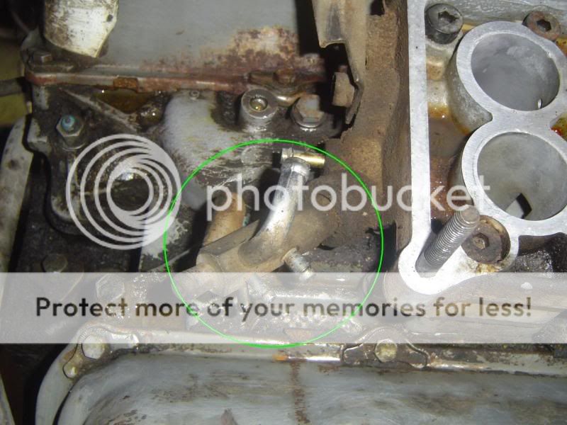

This is the idle screw that i had to adjust in the McDonalds parking lot.

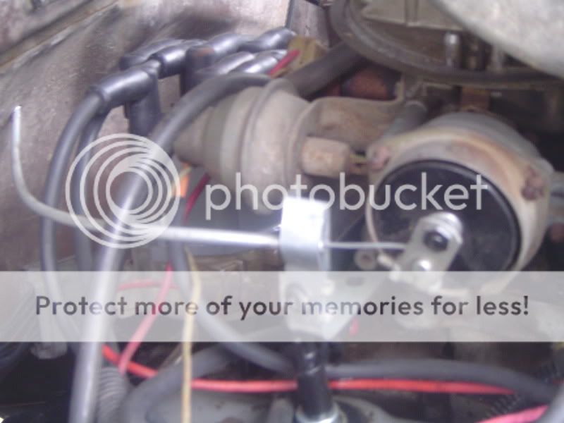

And here is my dads manual choke. This carb. came this way.

Have you guys read over the Motorcraft 2150 rebuild guide in the tech library? You can skip most of it but read the part about tuning your carb. 1.5 turns out is a starting point. There is no specific place the idle mix screws should be set, it will be different in every car and every carb.
For idle adjusting, try this:
Using a propane cylinder (like a plumbing torch) let a little propane into each side of the carb and there should be around a 50RPM gain in speed. If there is a gain way over 50RPM, the carb is too lean; if there is no gain, the carb is too rich.
On the California test, it is done on a dyno and the curb idle has little or no effect.
That screw in the circle above (on a stock carb, with the computer) is for stetting the minimum idle when the motor backs off.
