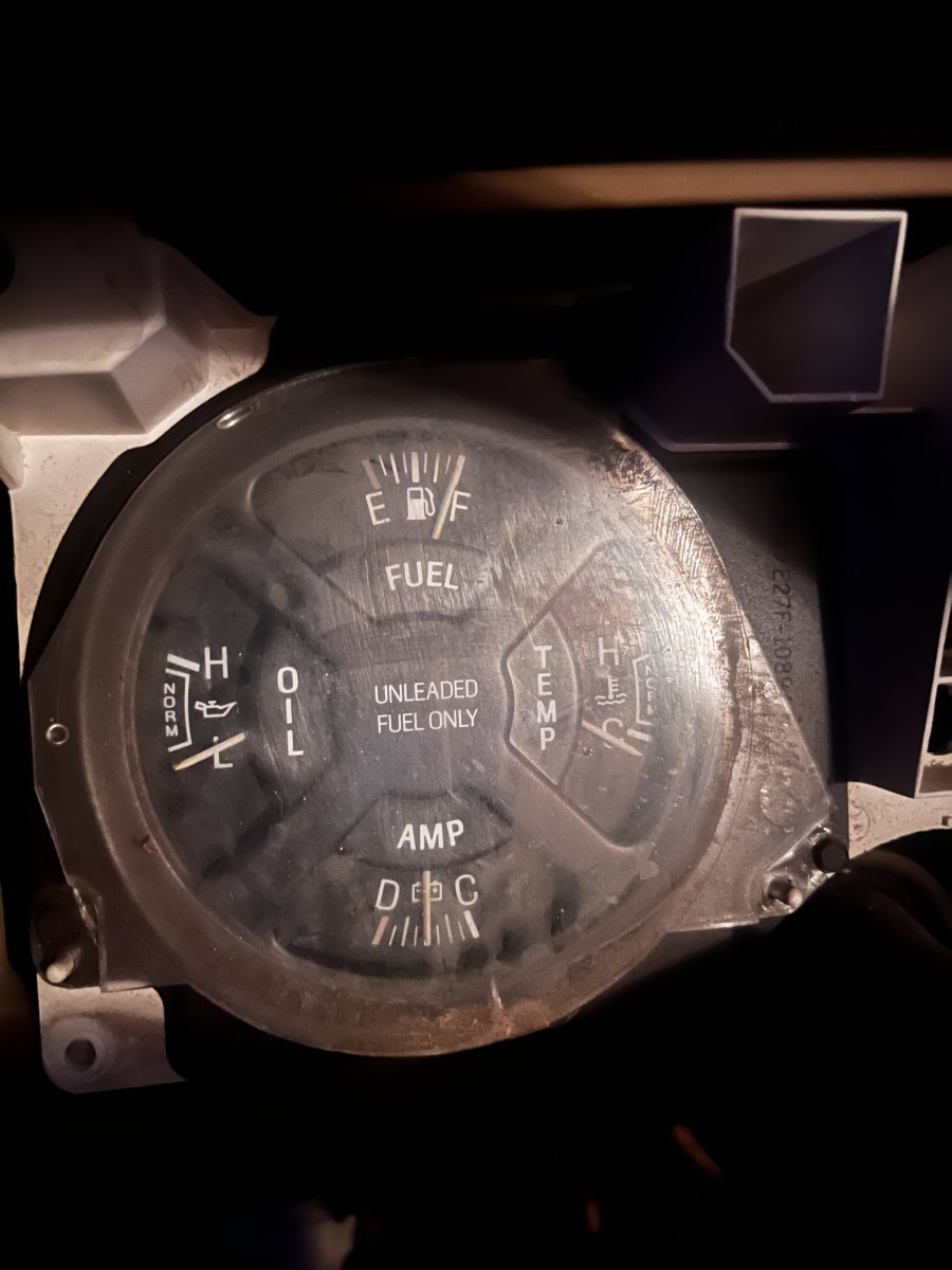

My sending unit packed up shop and is no longer giving me a reading at the gauge.

I don't have any issue with sending fuel. My fuel gauge is dead.
After grounding out the pigtail to the tank, the fuel gauge shot to full.

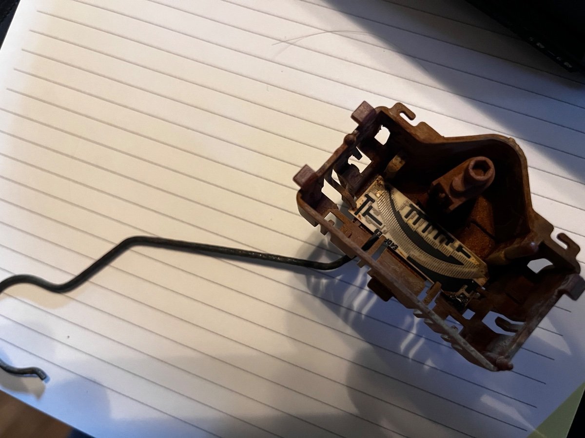

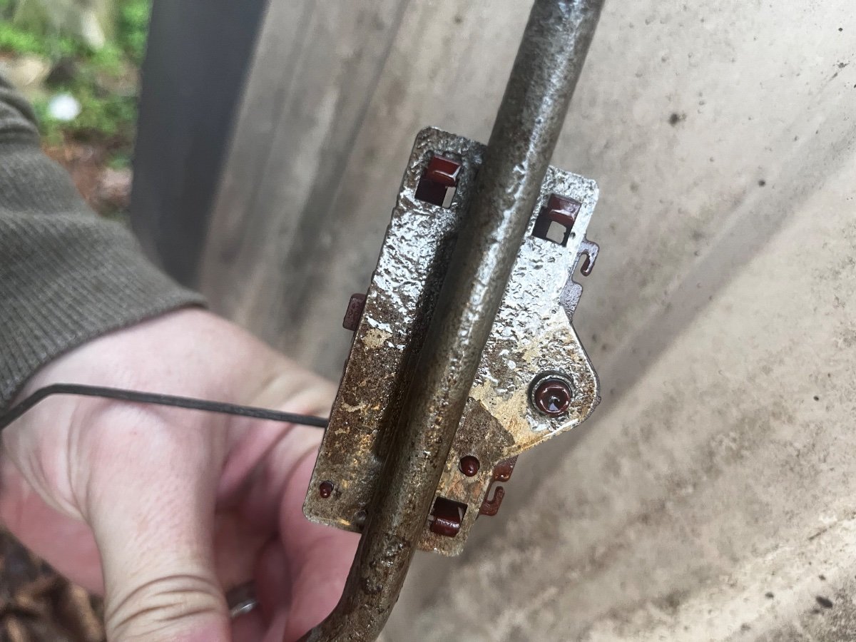

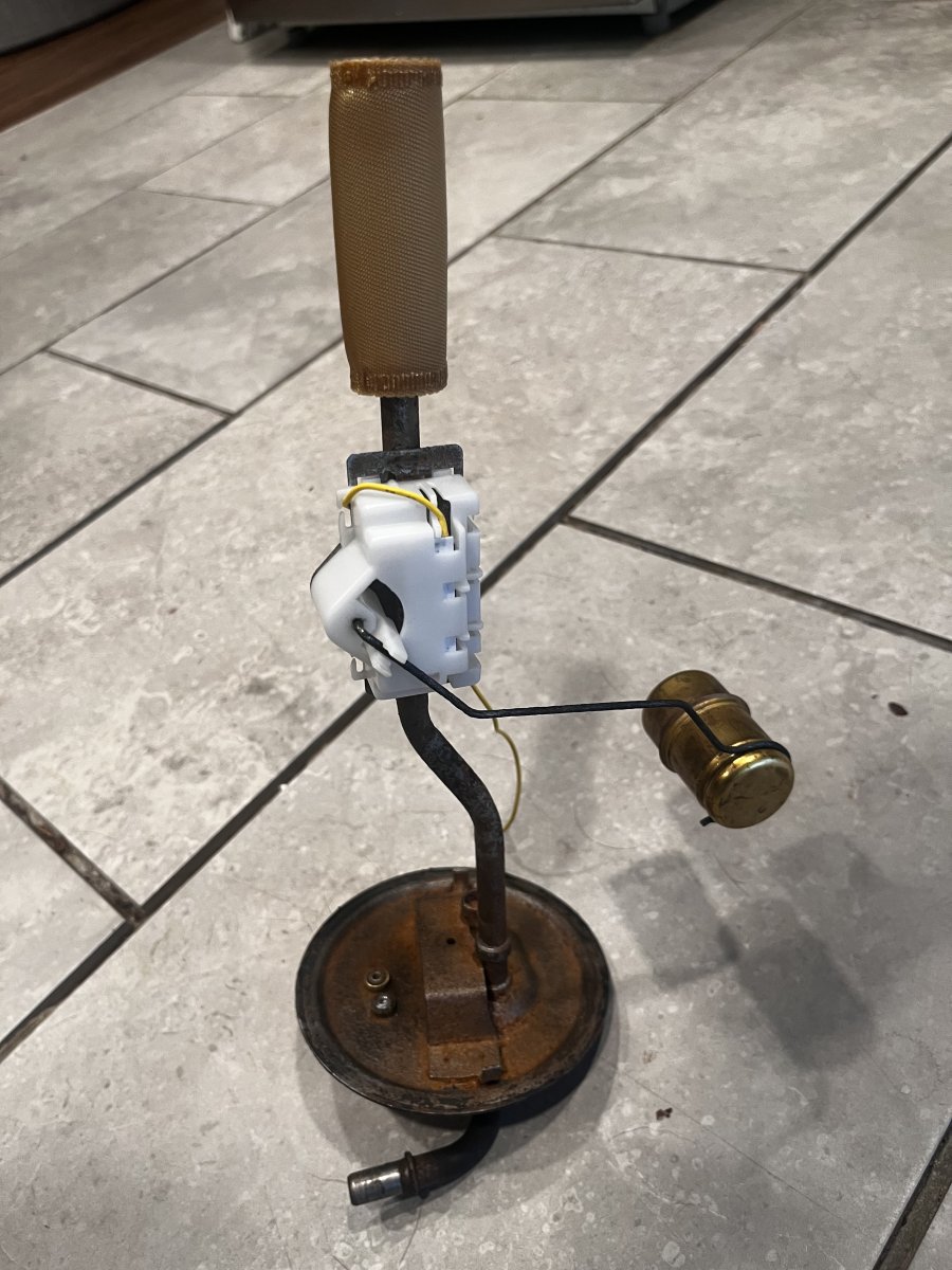

Literally all the wiring was eaten by years of bad gas. Silver lining - the pickup tube and mount plate were not super corroded so the actual hardware is salvageable.

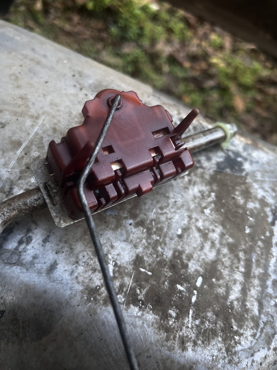

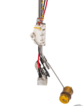

JEGS was having a clearance on some senders for $35. They operate in the same ohm-band and the pictures looked similar. Why not. Grasping at straws anyway.
There's some chopping, drilling, and frankenstein-ing that occurs. I'll post pictures of the process later if there's any interest.
But everything bolts up to the Ranger sender nice and factory-like.

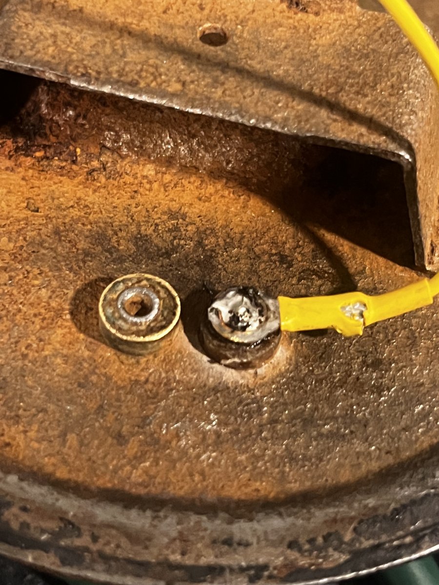

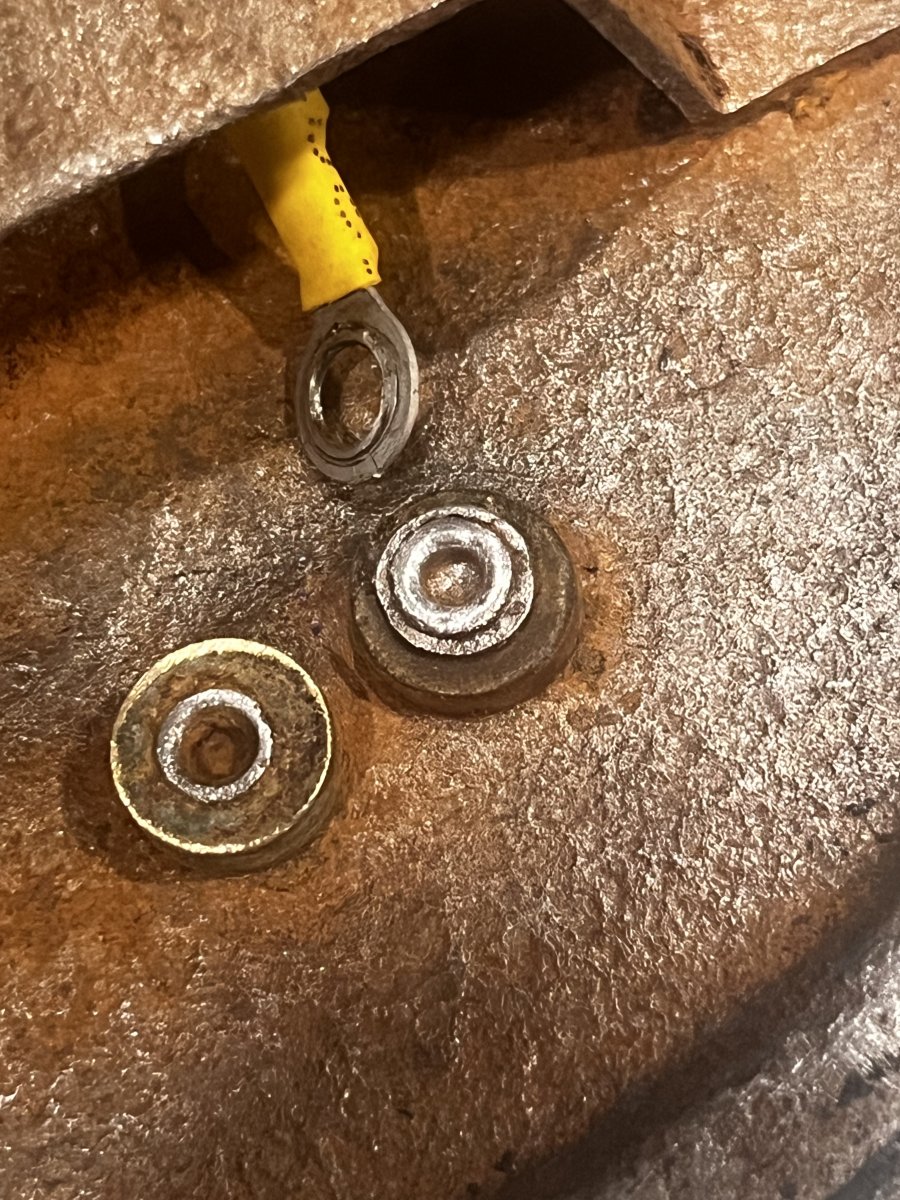

Downside and hopefully the final challenge: the old signal wire eyelet went the way of tube TVs and the terminals are swaged/pressed in.
I drilled out the eyelet diameter in hopes it would fit around what was left of the terminal but the metal started to get too thin for comfort.

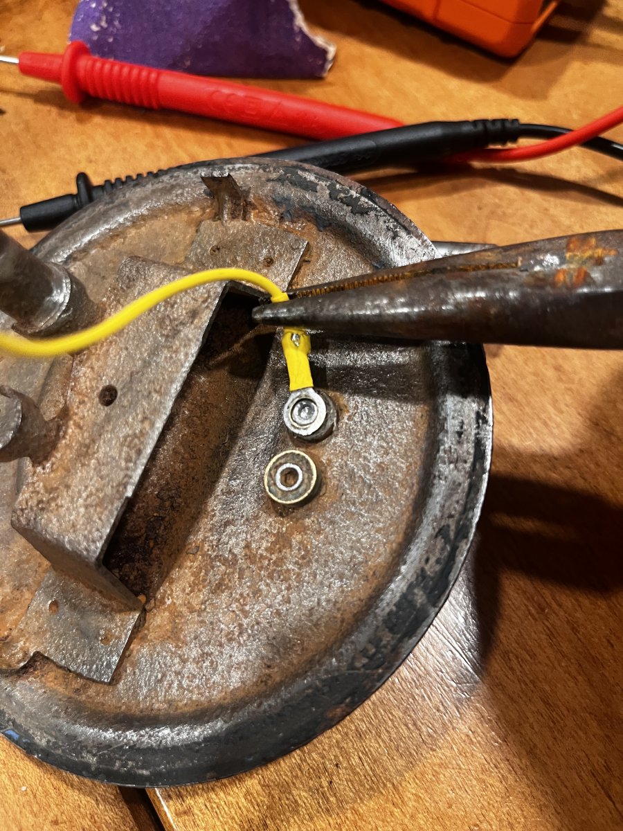

I'm considering a few options:
1. Soldering the new eyelet on then dumping copious amounts of Seal-All as a stress relief.
Problem is, after an afternoon of amateur soldering, I couldn’t get a healthy enough contact for consistent signal.
I would get a valid number but only with constantly applying hand pressure.
2. Tapping a micro-thread and using a very small bolt to tighten down the eyelet for better contact.
Copious amounts of thread locker included.... and then the Seal-All.

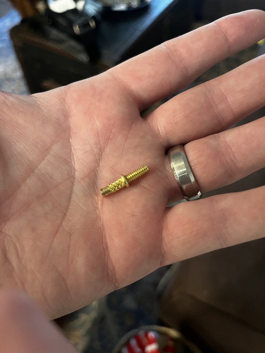

Downside is the pins are tiny. Here’s the one from the new/donor unit.

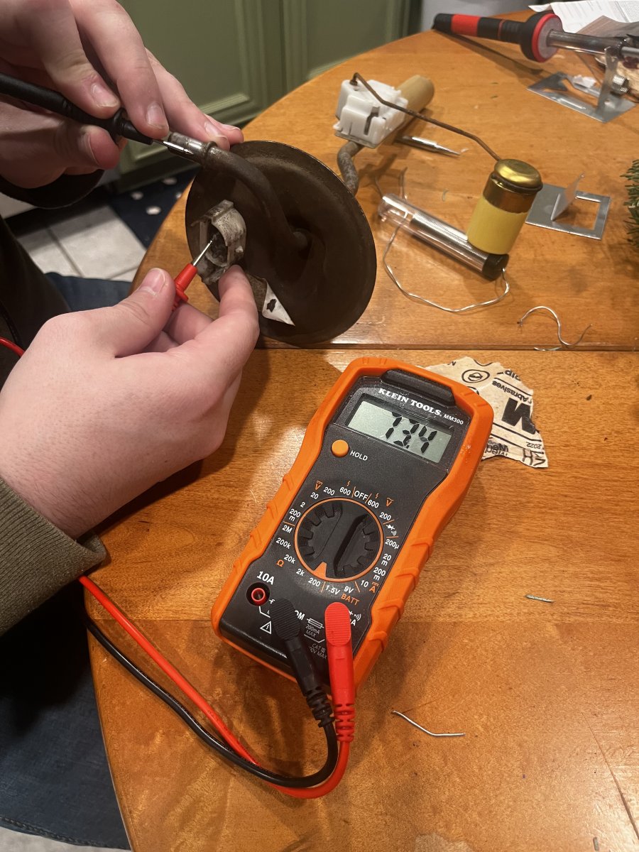

Had some free time yesterday to rework a couple of issues with the donor parts, namely the potentiometer mounts.

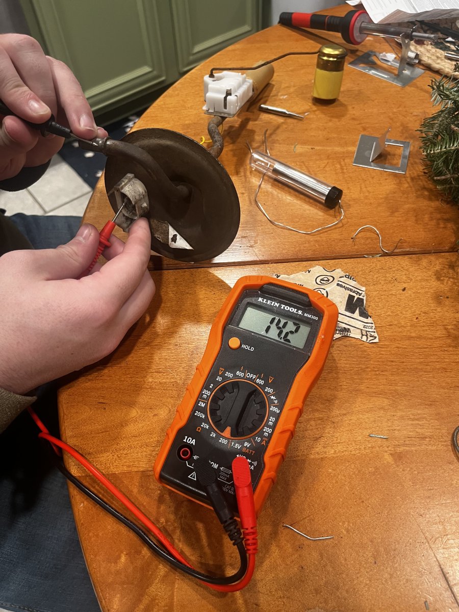

A little finagling and Option 1 succeeded thanks to a more powerful soldering iron!
Not pictured: the copious amount of curing Seal-All to insulate.
Got an operating range of 10-75 ohms.
Lift off. For the first time in my life, I drive an RBV with a functional gas gauge.
