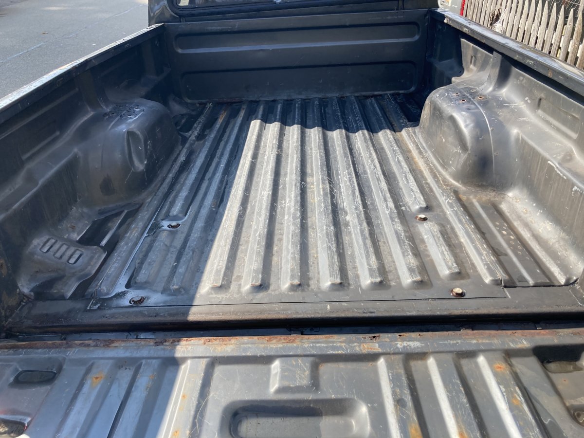

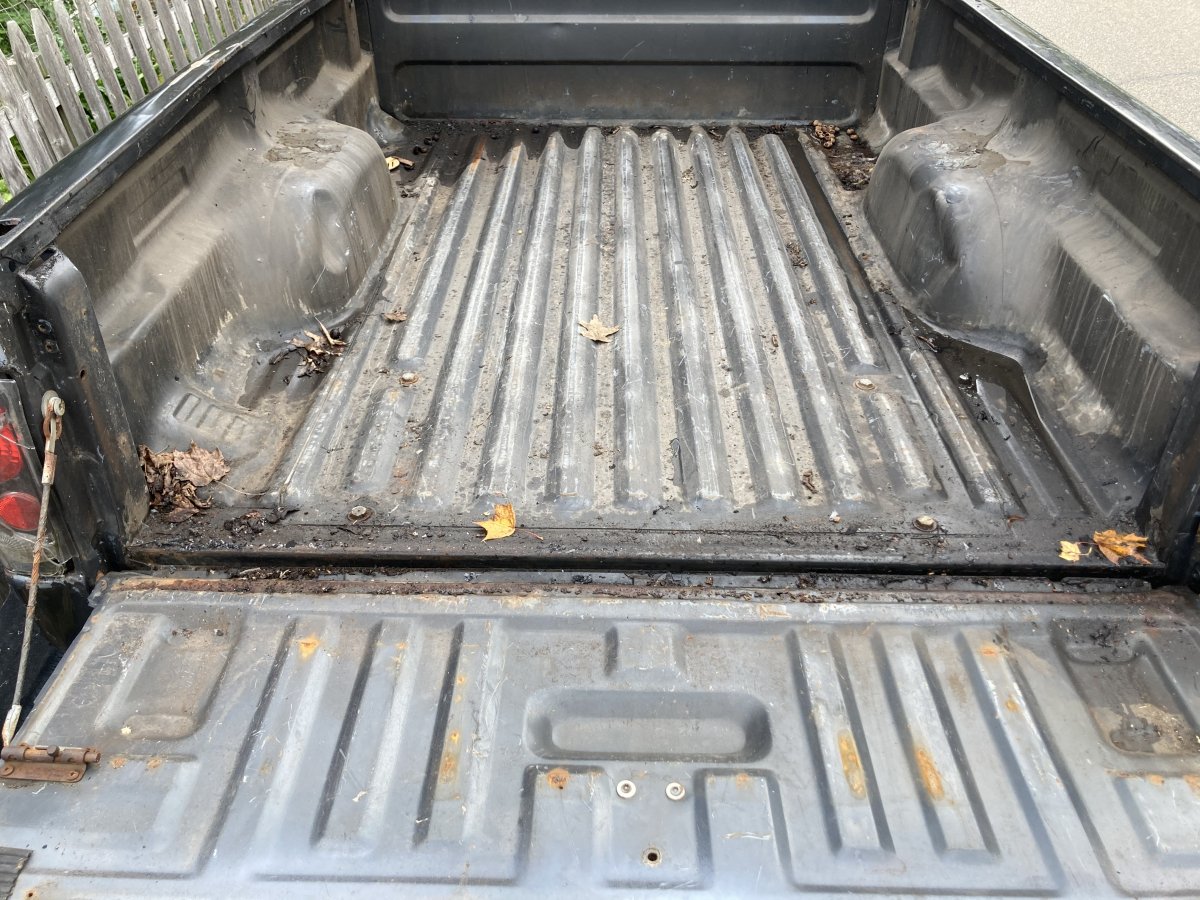

Did some bed work this morning before work. Couldn’t resist taking out the bed liner insert. Will keep it because it’s very nice, but I am interested in enjoying the truck for what it is for now. Definitely like the old beds. The bed is actually in decent shape! Only small spots of rust and a couple dents in the wheel wells. There also used to be rubber matting along the top of all the trim which I removed and then had to power wash the adhesive. Found a lot of the other black paint under the edges as well of course. Things are cleaning up decently. Will want to hammer down the left edge too.
After and before pressure washing...

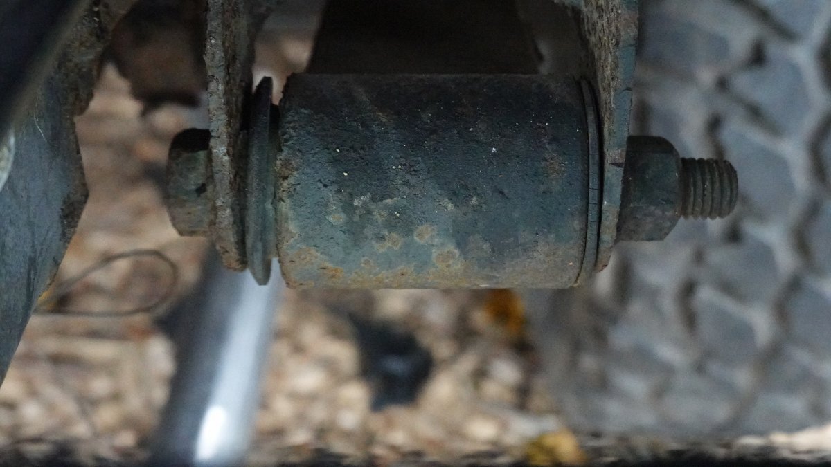

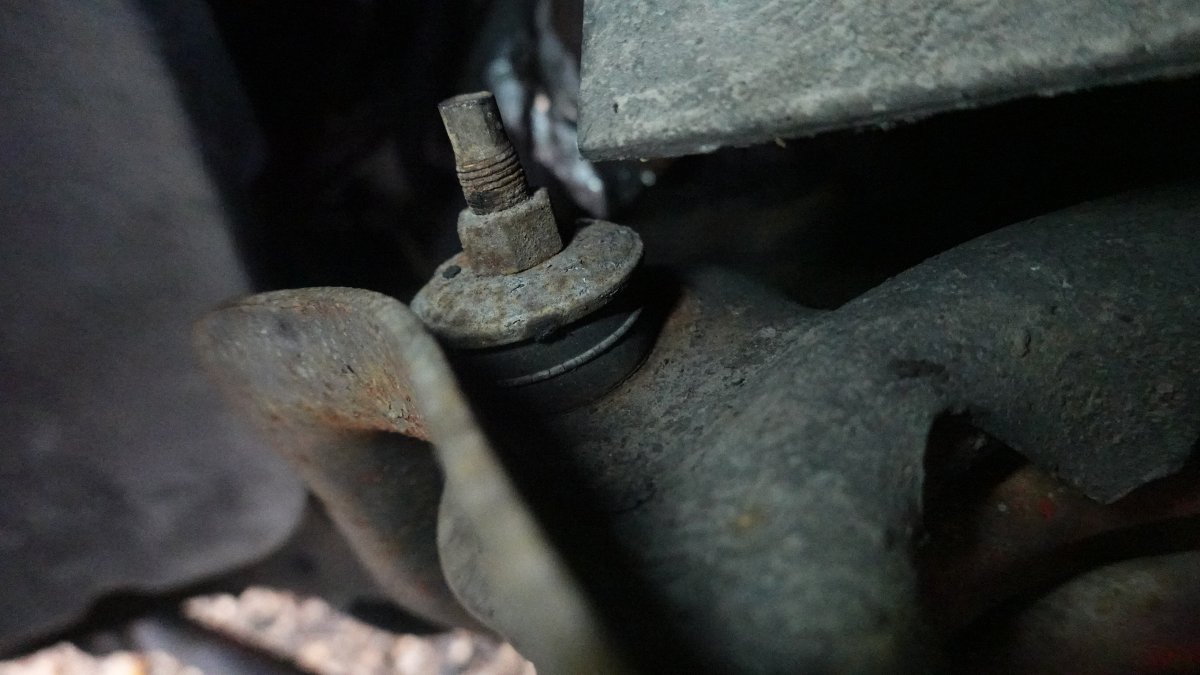

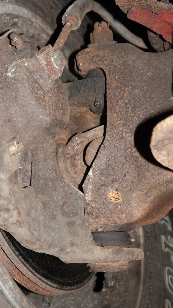

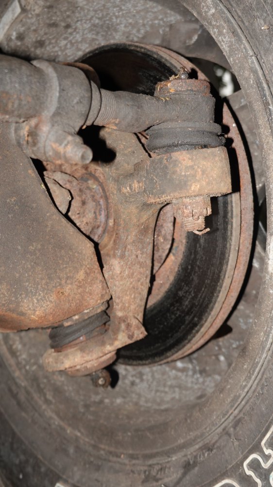

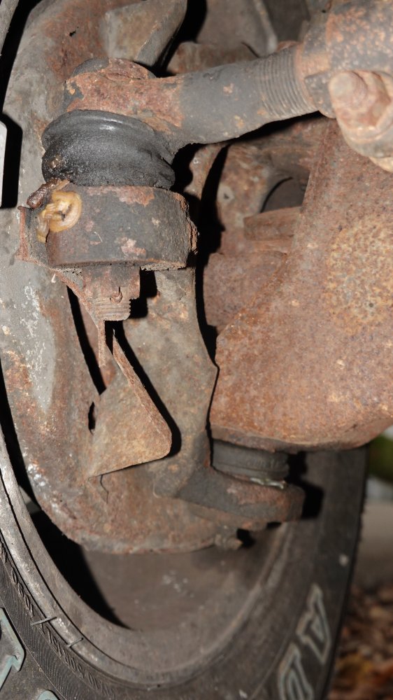

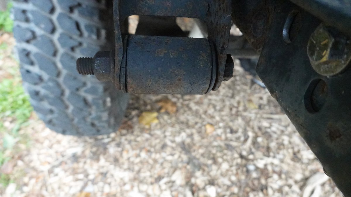

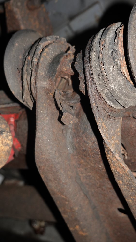

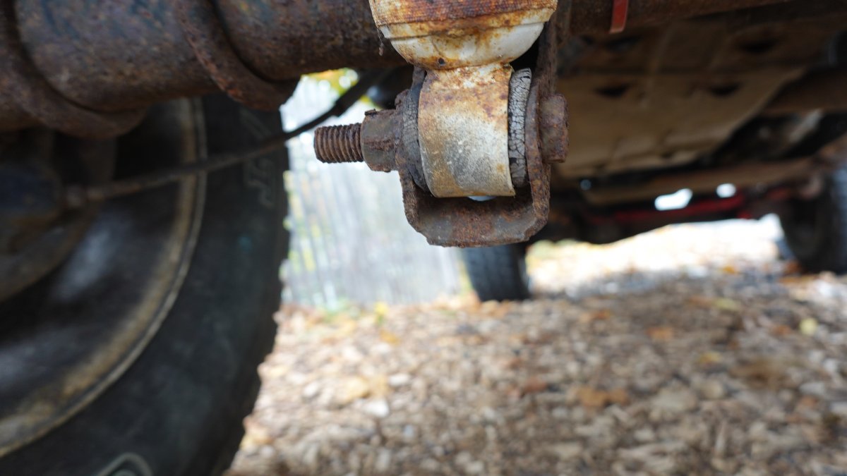

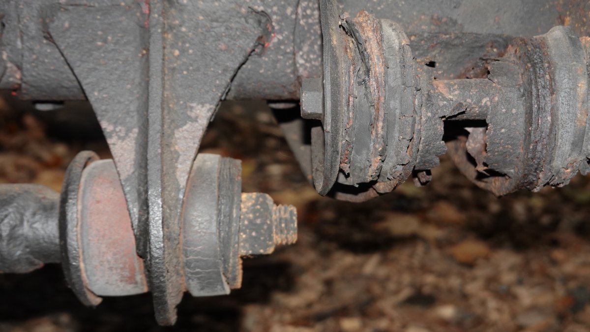

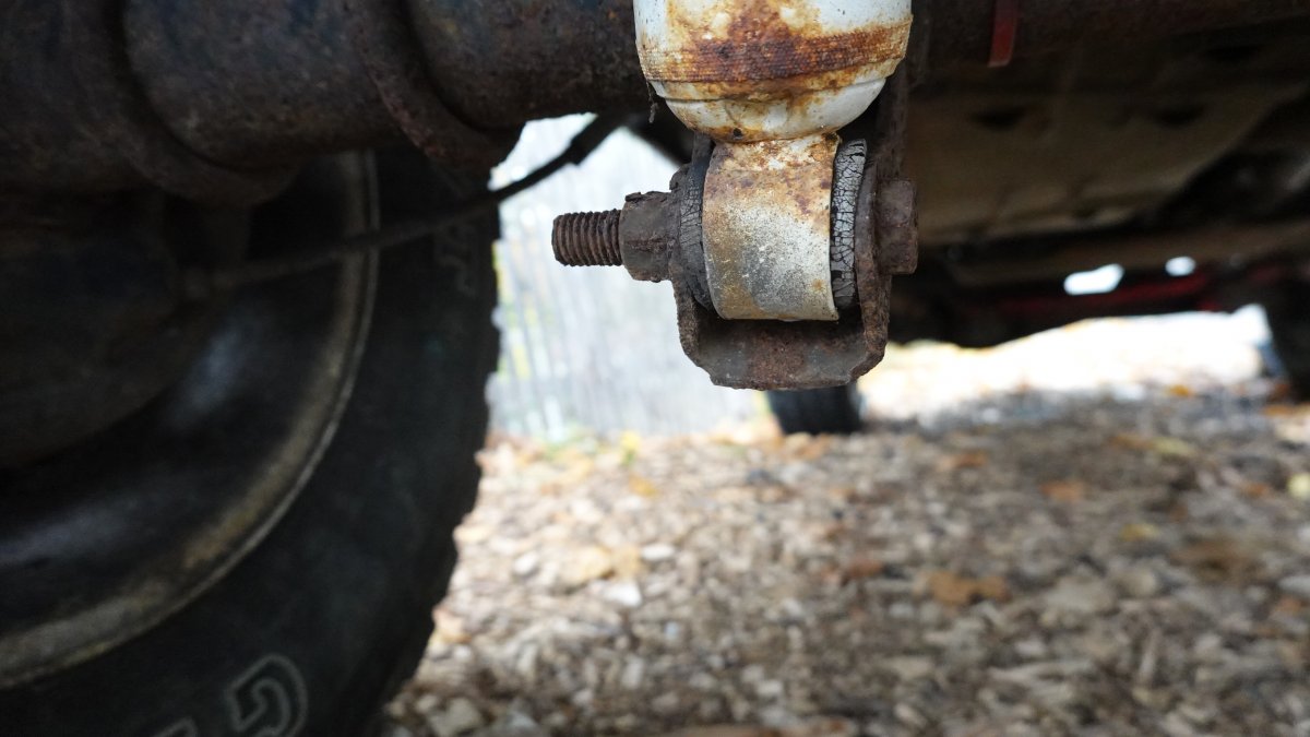

Bushings reveal party!!! They're all toast.

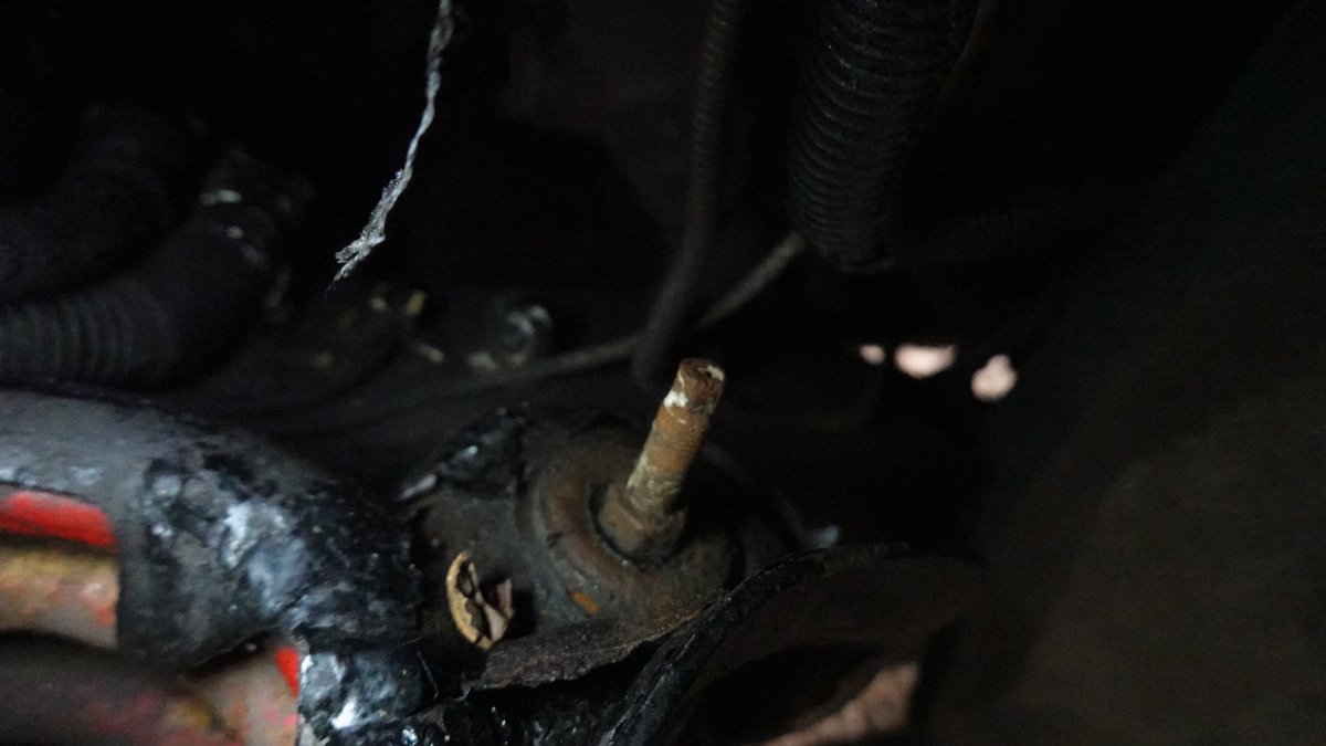

First up are the shocks... Rears top/bottom, top/bottom. Then fronts just tops. Couldn't get clear pics of bottom. Note the last shock top pic is the left shock that's also dangling at its bottom connection, and this top of it seems to be missing it's washer. So strange.

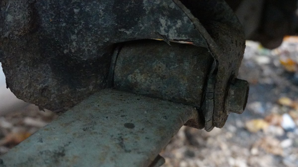

Then there's all four leaf spring bushings.

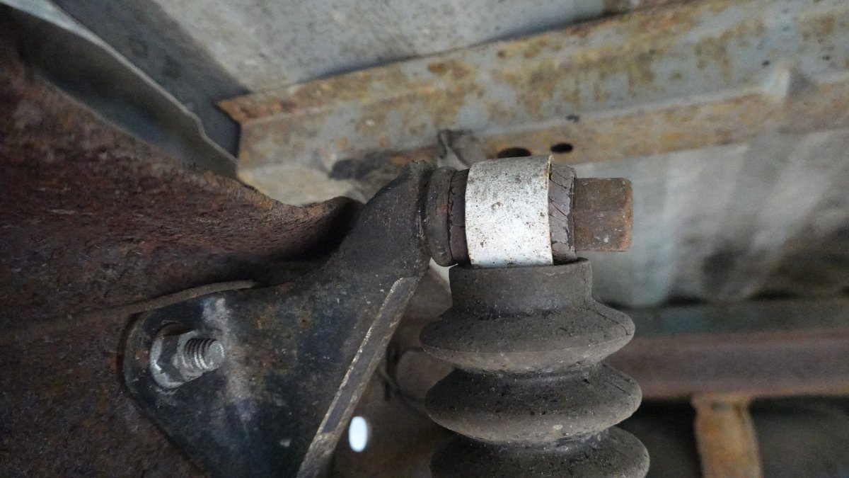

Then there's the left side mid area joints and same for the right. I believe this is the aftermarket transmission mount/bracket piece, and then whatever joint that is just next to it. The transmission mount just needs to be entirely replaced as its rotted away at each end. The middle is fine, it's just these ends.

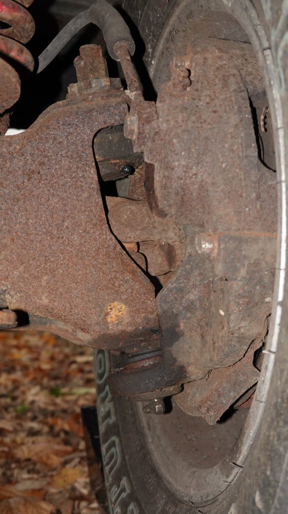

Last there's all four angles of the front wheels.
Obviously all these bushings need to be replaced. This is in addition to the body mounts of course. Anybody have a recommendations for buying full sets of suspension bushings?
Also, what other suspension bushings am i not catching? Are there any at the rear wheels?
When buying shocks, perhaps they come with bushing and hardware?

I didnt think the steering angle looks too terrible. Definitely an aftermarket drop pitman arm in addition to what is listed above. Aftermarket transmission crossmember and radius arm brackets.
I'm having trouble determining what the compatibility is with the aftermarket radius arm bracket though. Would the OEM bushing size fit this particular aftermarket radius arm and its bracket? I suppose i could try to pin down the make and model of the arms and brackets.
Separately from that complete suspension bushing package, i also need to solve the transmission crossmember situation. What i'm starting to gather is that this aftermarket transmission crossmember allows for flex-mobility instead of being rigid with the frame. Hence on the OEM crossmember brackets it's just bolted and not a system with bushings. If so, then the best plan is to figure out the exact model of the crossmember and replace the whole thing.
That is a factory transmission cross member. 1st gens used that and newer models had a solid mount. Can't get bushings for it so the solid mount is preferable. Not like it flexes much anyway.
You have a Rancho lift. I recognize the radius arms and drop brackets. Not the best thing out there, but it was safe unless you like jumping or rock crawling.
I have a set of the same extended radius arms. Trying to decide if I wanna use them. Apparently they rub the tire when turning? Does yours?
