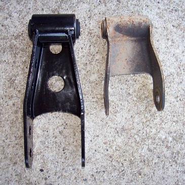

Get new u-bolts (factory replacement ones) and ditch the bottom blocks.
Then do this:
And you will end up about where you started for ride height.
Depending how "into it" you want to go there are other options like different rear springs and whatnot but more $$ and complexity
It would probably be easier and cheaper to replace the rear blocks with proper springs and/or different shackles.
Overall, your height looks good. I know its just personal preference. But I would keep the lift. Just make the rear safer.

So from what I understand, I am effectively replacing the u bolts with OEMs meant to fit with just having my “top” blocks, losing bottom ones. At that point my rear will be lower than the front by the amount the former bottom block was. To my eye it looks like less than 2”.
Then, I install those shackles to re-raise the rear. Is there adjustment to get it just right or do I select shackles of a certain size ..
As long as the front looks safe, I’ll keep it. I like the lift. I may bring the body lift down an inch but may also keep the 3”.
Body lift has advantages and disadvantages... generally speaking, I do not care for them.
Adjustable shackles can be had from advance auto, ebay, Amazon, etc. I run them on all of mine (all of my trucks are lifted in one way or another). They tend to be quite a bit beefier than the factory ones.
From experience, 1750lb rear springs and lift shackles will amount to 3-4 inches total lift in the rear with factory blocks.

We are not recommending just pulling out the extra blocks. We are recommending removing the extra blocks and replacing shackles, etc. with different ones. That retains the current ride height with safer engineering and the shocks are unaffected.
Alrighty I’ll remove the lower blocks to keep just the OEMs, put in new OEM Ubolts, and add the shackles linked in the article. It says they’re about 2” lift, so that should be pretty close to what I have now.
