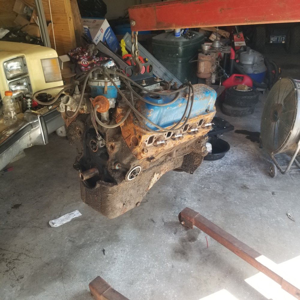

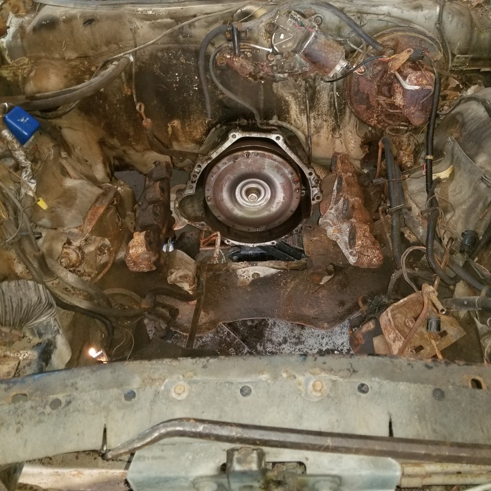

Well since i know yall been waiting in hot anticipation i have an update...
Went out today and did this...
I left the manifolds in car. The studs are absolutly junk anyways...so i knew it would be a matter of snappage anyhow. I had the manifolds off when this all started 20 years ago so i pulled them off the engine instead...those came off like a breeze.
Now i can get in there with a cut off wheel and just cut the studs and pull the manifolds.
Something odd though....there were only 3 nuts on the converter studs...not sure if someone messed up at the factory or this isnt tke first time its been apart.
Now next step is to degrease the motor good, load it up and haul it to my house and put in my shed where i can dick with it over the winter and hopefully have it ready to install next spring.
Im still in the air about a full on rebuild. I was just gonna clean it up, regasket it, get the heads checked, etc etc.
Biggest hang up is i dont wanna spend shitloads of money on it...the engine ran good before though. Whats machine shop work these days?
