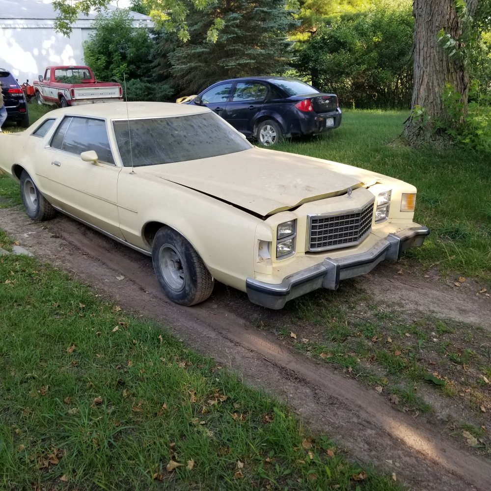

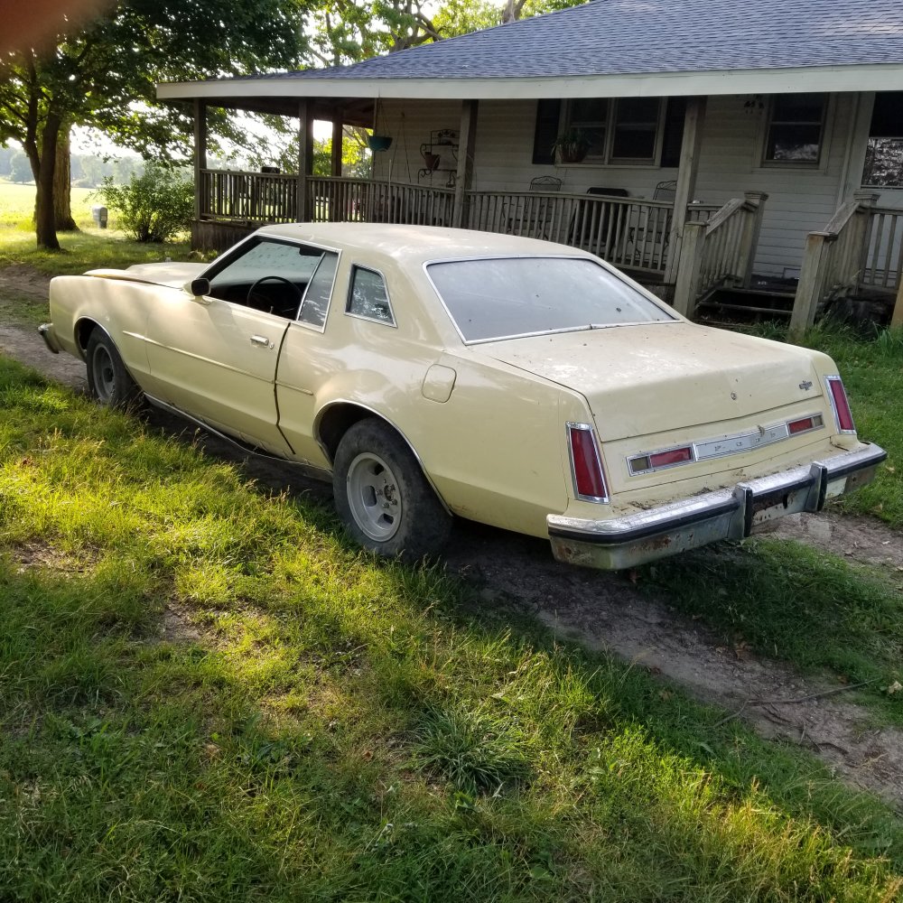

I dragged the old LTD II out today from its peaceful 15 or 16 year slumber.
Ill be documenting progress in this thread for anyone who might actually care about a smog era somewhat restoration...
Base vehicle...
77 LTD II 351W/FMX/9in rear (2.50 ratio)
Plans....in no order of importance....

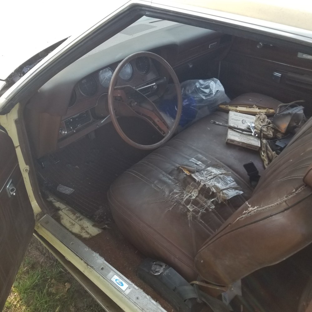

7- Try to get seat tears fixed
8- Replace the AM radio with a factory AM/FM mono radio

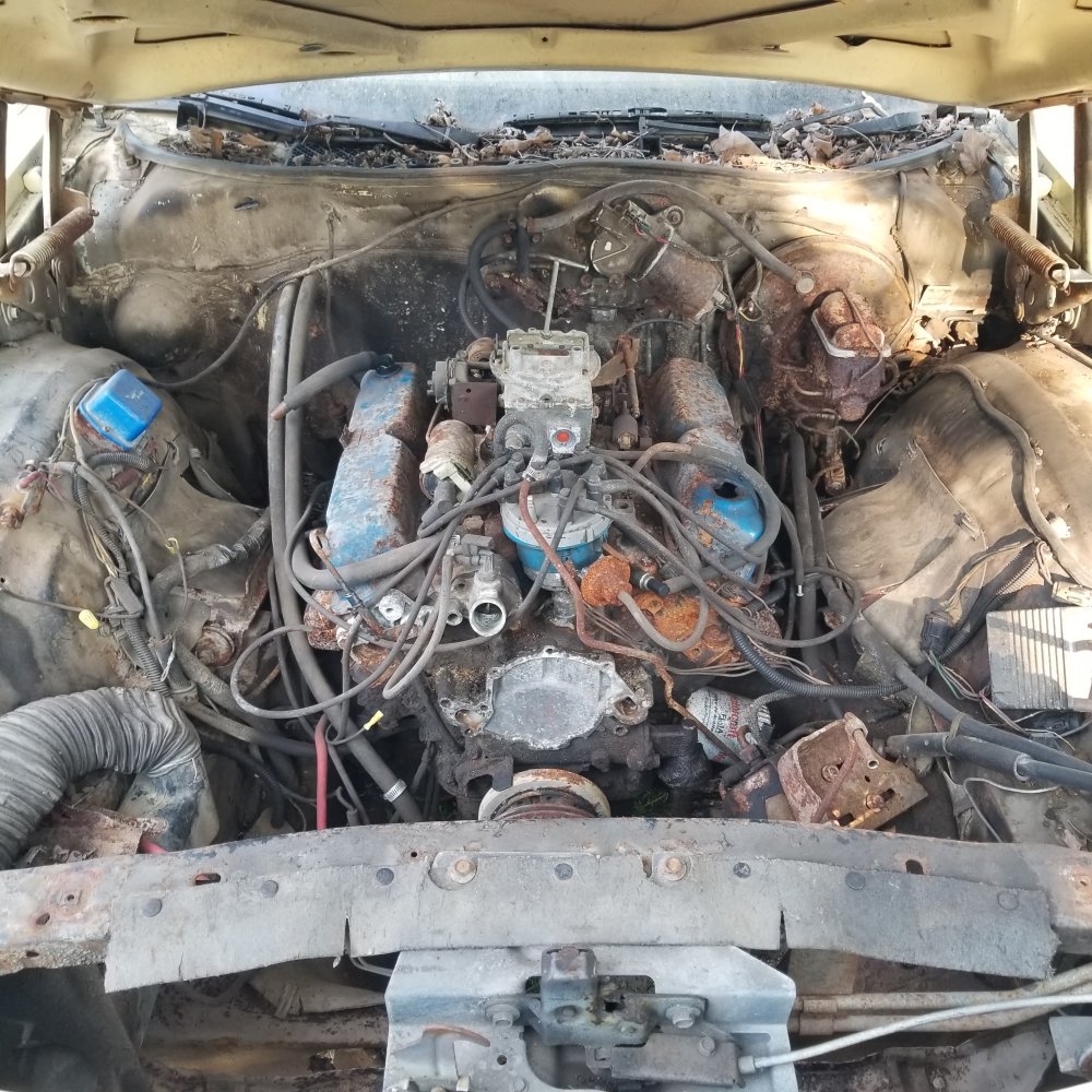

Is it a 351W or M?
If M a 460 will bolt to the trans... just being devils advocate...lol.
Is it a 351W or M?
Windsor. One of the quickest ways to tell is to look at the location of the thermostat. If the outlet comes from the block, it’s a 335 series (351m, 400, etc). If the outlet comes off the intake it’s a Windsor.

The W has the same stupid "sandwich the timing cover between the water pump and engine block" water pump setup as a 302 also.
Is it a 351W or M?
Windsor. If it had a M it would make a 400/460 more appealing. Even though the FMX has a removeable bell.
Valve covers are vastly different to.

Most ltd’s of that era Ive seen had 400’s. Id put a lower geared rear end in it, that alone would increase the fun-factor. 3.73’s would really make it feel like a V8.
I *think* i have a 3.25 3rd member laying around. Or i did. If its still around it could very well find its way into it.
If i end up doing a full rebuild its probably going to get atleast a RV cam in it. It needs a timing chain and im using an early pre emission set, so that should wake it up some too.
The 2.50's were nice though in a way....i could get 20-21hwy with it....and about 11 around town :) lol.
