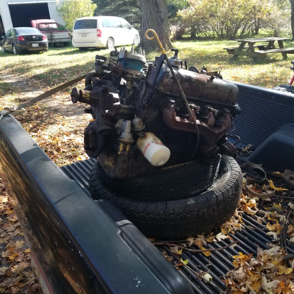

I found a (hopefully) suitable heart transplant...
77 LTD II

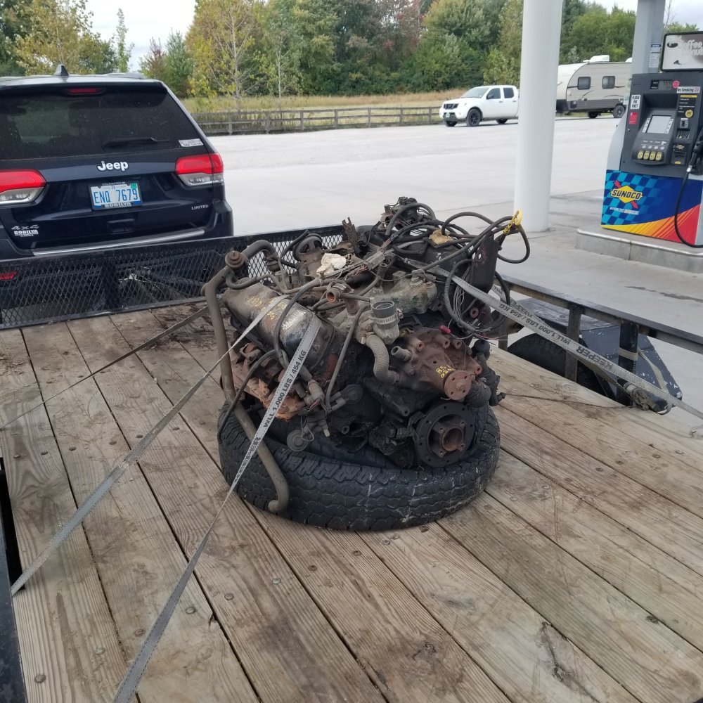

Yes its oily. Lol. But the exhaust is clean, it has good compression and i didnt hear anything bad when i spun it over.
Got it for 450bucks. Im going to clean it up, regasket it, drop in a new oil pump, timing set, etc. Plop it in and see what happens.
The junkyard i got it from seemed pretty legit...i had a good gut feeling. Supposdly motor has 85,000 miles on it from a conversion van that rottted out.
Its a 85 2bbl...loaded with 80's emission hang-ons. But from what i read power output is the same as my 77 motor.
They do test them....they run them till they are warm and make sure the oil pressure stays up, it doesnt knock, etc. It was pulled sitting on a shelf, holes covered.
I have a good gut feeling about it. But time will tell.
Ill end up rebuilding my current 77 engine. I do wanna do some "build" on it, but im also super anxious/excited to drive this thing again. But this way i can atleast move the car eaiser and see what else its gonna need...and hell if this motor works out ill run it. But as of now its kind of a "stop gap" lol.

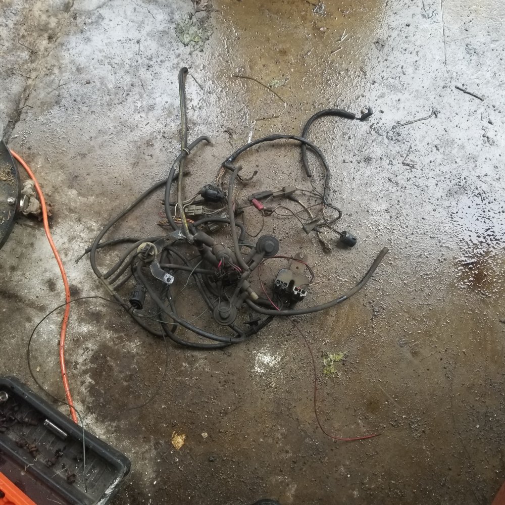

I went and got the "new" engine off the trailer yesterday....
First thing i did was rip off all the cut wires and vacuum hoses that made up the wonderful emissions system...

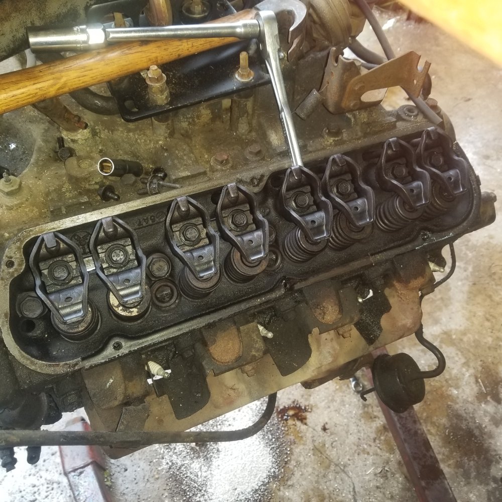

Then i decided to pop off a valve cover and see if the PO kept up on oil changes...
77 LTD II
Less gunk then my original engine. Pleasant surprise.

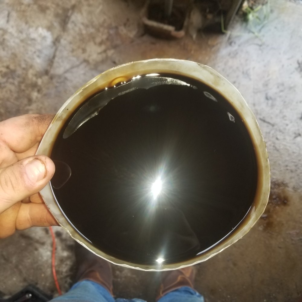

Heres where i got concerned....when i pulled the dipstick at the yard it showed nothing. Guy said sometimes they drain them, sometimes not. I popped out the drain plug cause i was gonna run my finger around and see what i came out with.
To my surprise it wasnt drained. So hopefuljy it wasnt run to long low on oil.
I did put some in a clean jug bottom i cut...
77 LTD II
Black as asphalt but no shiny stuff. No coolant in it. So im assuming its healthy on the bottom side.

Send a sample to Blackstone and see what they think about it. Costs 35$ iirc
The oil doesn't look THAT bad. As long as it doesn't taste stale, just dump it back in and reuse it.
Seriously, that motor looks pretty good. I hope that runs as good as it looks, and that it works well for you.
