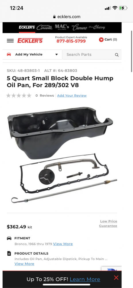

See pic below, do you know if his is the oil pan you are thinking about? also I thought I had seen guys using rear sump pans from early bronco for the ranger swap, just makes engine sit a bit higher..but I’d like to do right if possible

Yeah... could be. It's been 10+ years since I did my swap, lol

thanks, so would a dual pan fit on a 289 ? Do you know what part # I might need to make this happen, I thought I heard of guys using the rear sump pan from a early broncos, but I’d also like the engine as low as possible.

Not offhand, they are reproduced and they were a one year only thing.
The dual sump straddles my axle crossmember nicely in my 4wd, 2wd may be different.
