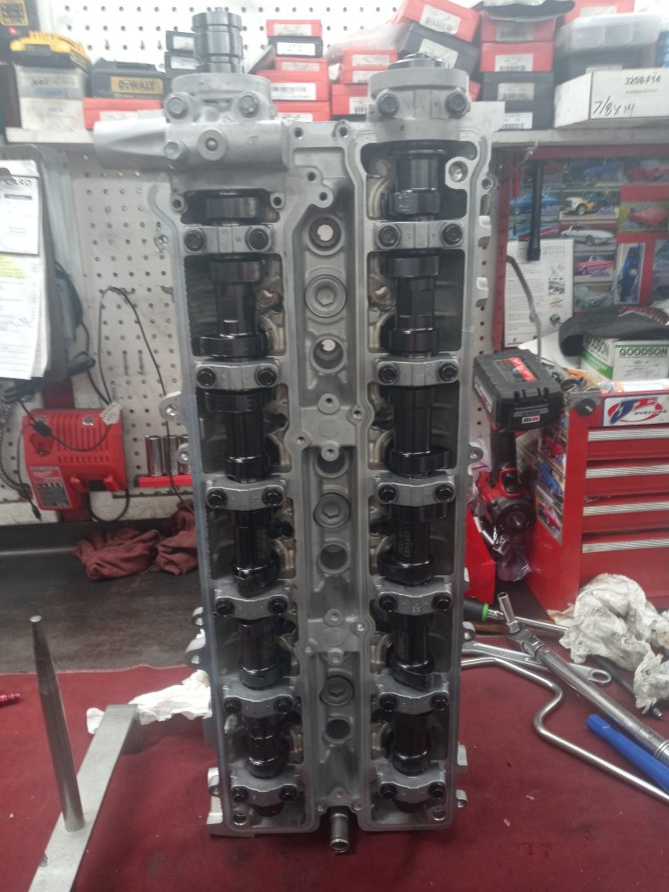

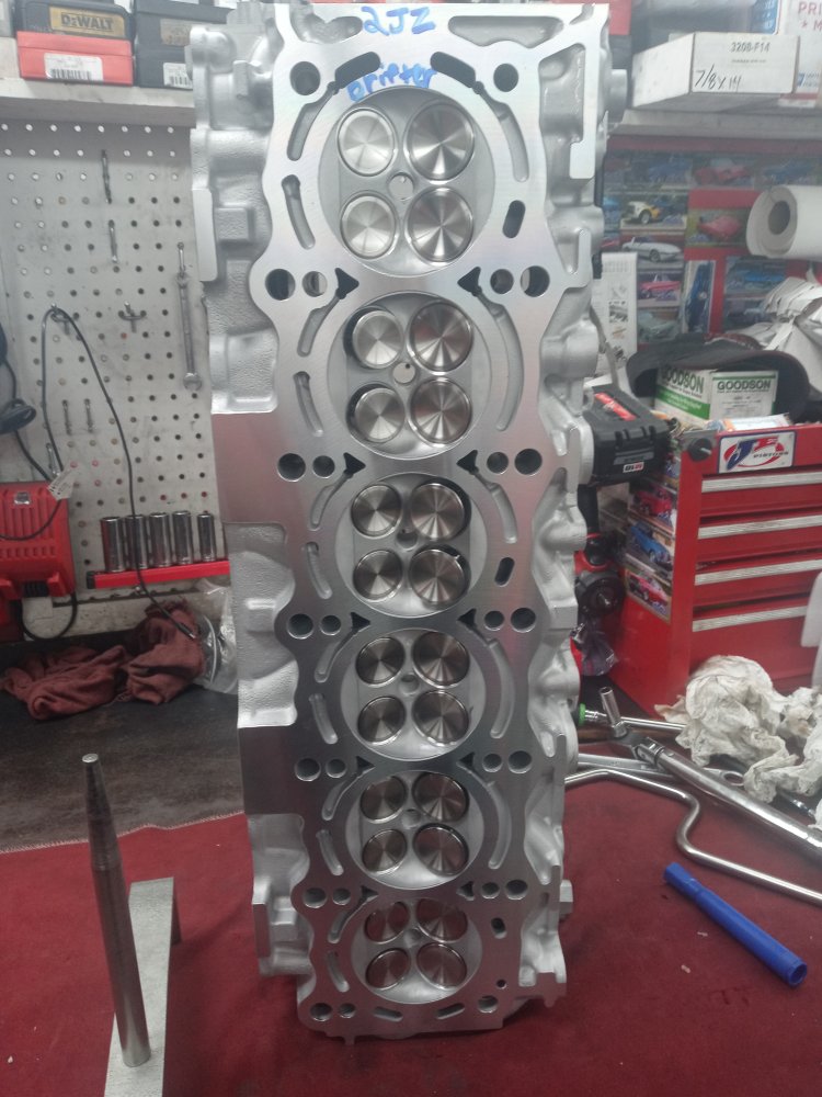

This is a head with basically identical parts to what i am using that made around 1600hp also my new pistons and rods just for sake of showing off shiny new parts

Feel free to ask any questions or ask for any photos!
