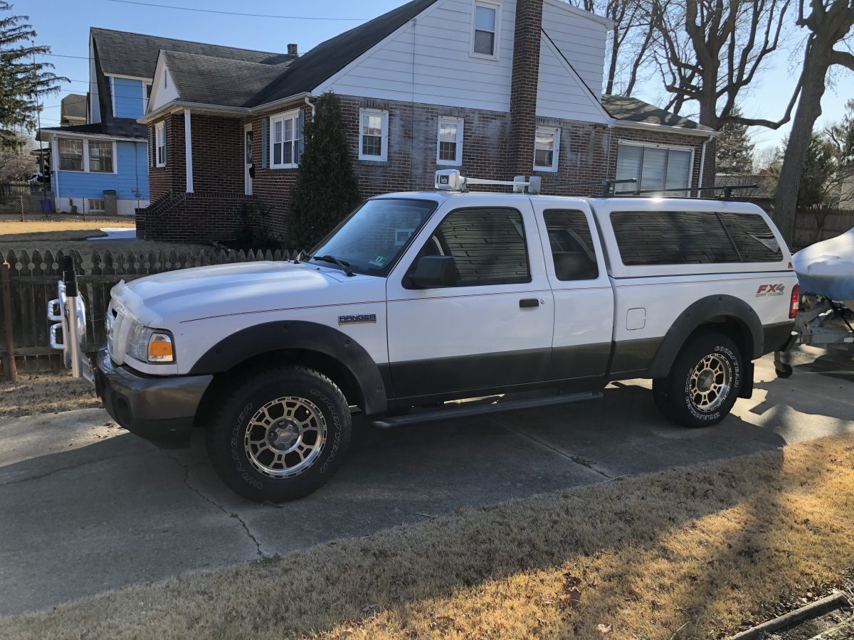

I’ve got an ‘08 Ranger FX4 with a manual trans and a shot 4.0 SOHC motor. I’ve also got an ‘02 F150 Supercrew FX4 with an auto trans and a 5.4 Triton V8 that the insurance company is about to total because of a fender-bender that happened today.

So does anyone have a spare 4.0L SOHC motor lying around that they’d be willing to part with? Or does anyone want to buy an 08 Ranger FX4 with a dead power plant? I hate to part with the truck, but I can’t afford to spend a fortune on it.

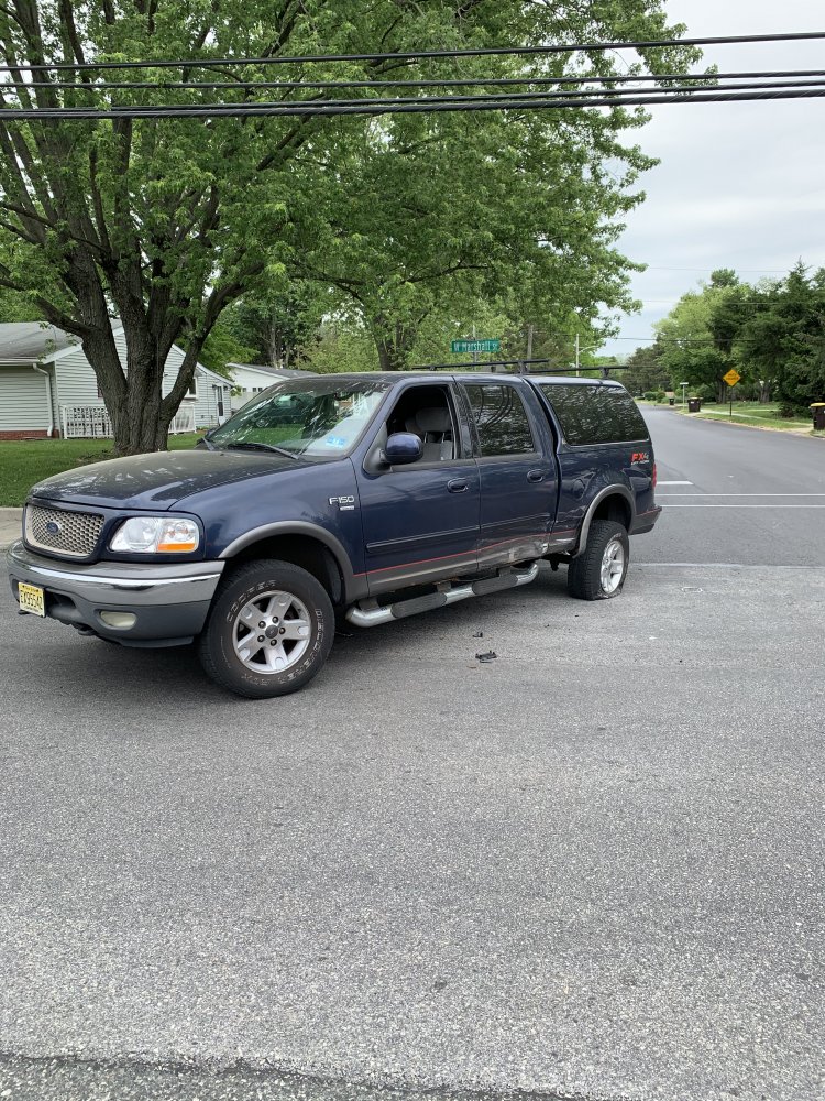

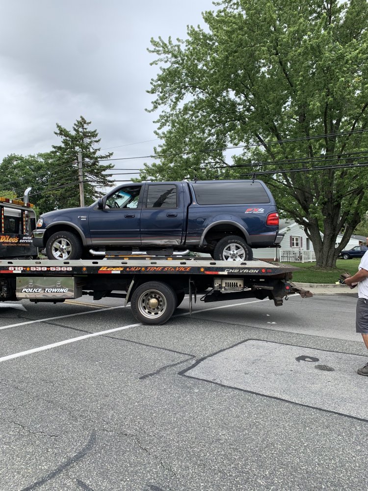

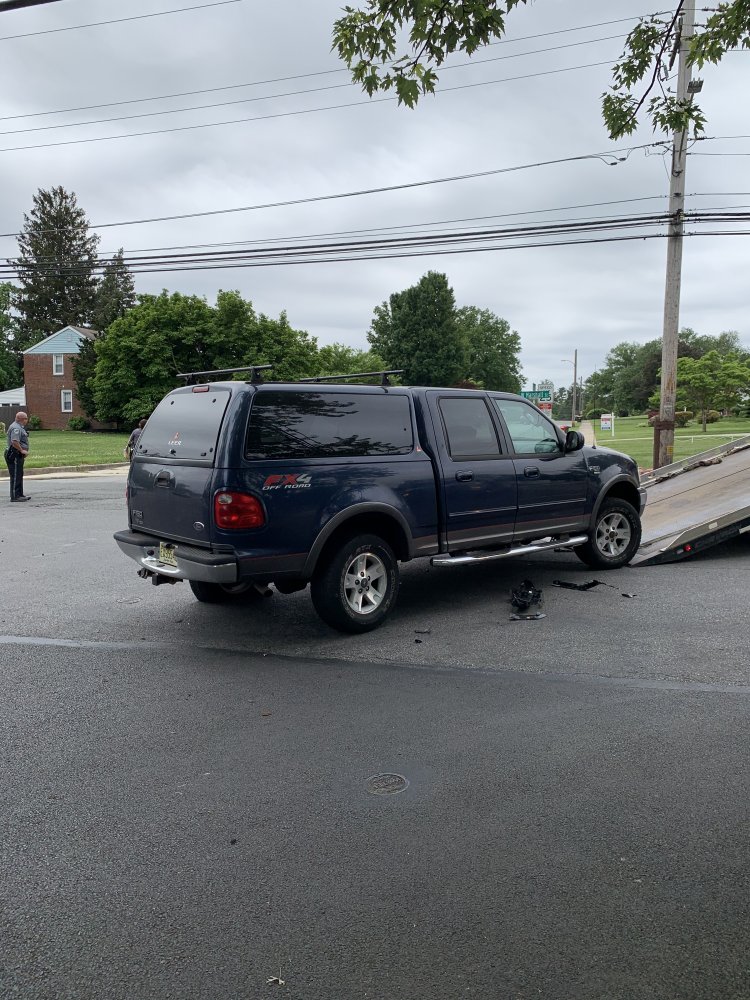

That’s a great idea, and certainly one that I’m considering. The damage was minor, and both the interior and exterior are in excellent condition for a truck that is nearly 20 y/o.

Doesn't look too terrible, maybe a spring, wheel possibly an axle and of course a tire and you would have a truck to sell.
Truck prices are fricking stupid right now, it would probably still be worth more than it was a year ago.
That thing is a gold mine for a part out! Also looks completely fixable unless there's frame damage. It will have crap resale value if you do fix it though because it will forever be stained by the salvage title.
