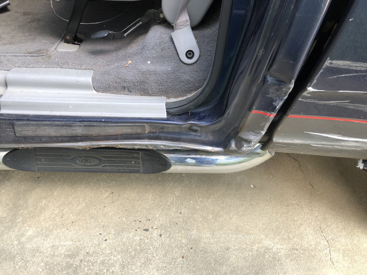

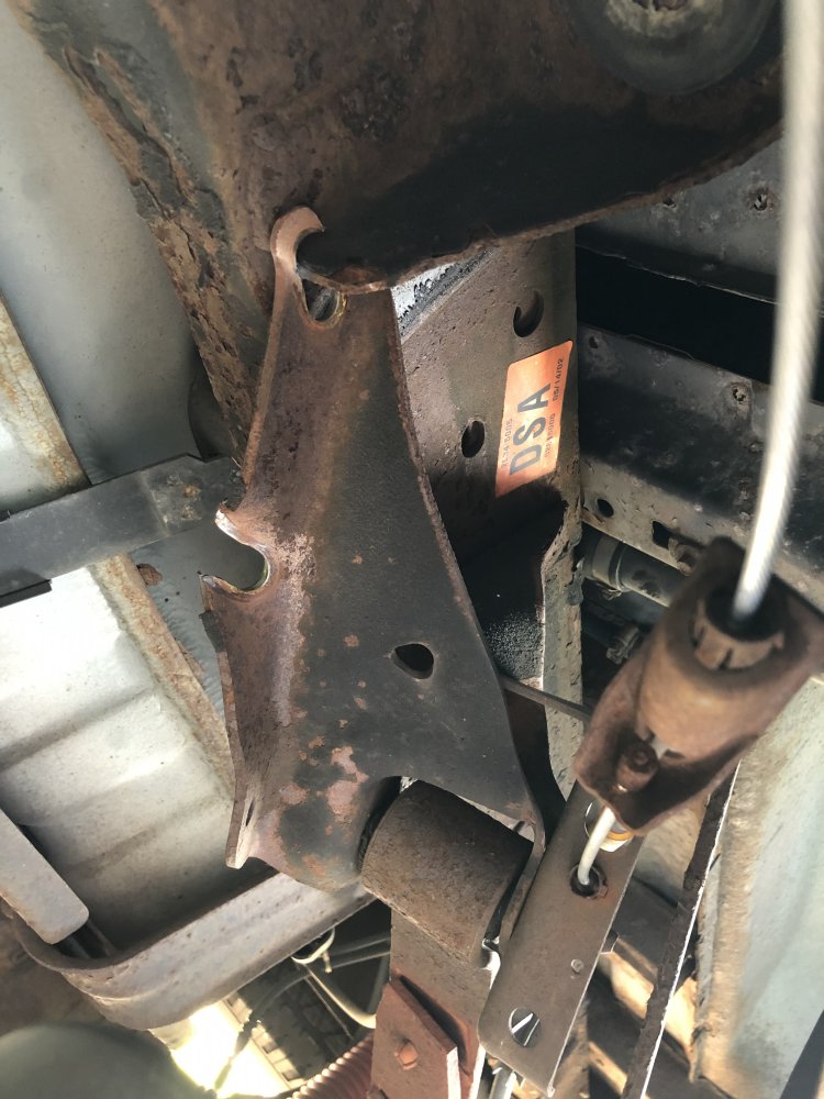

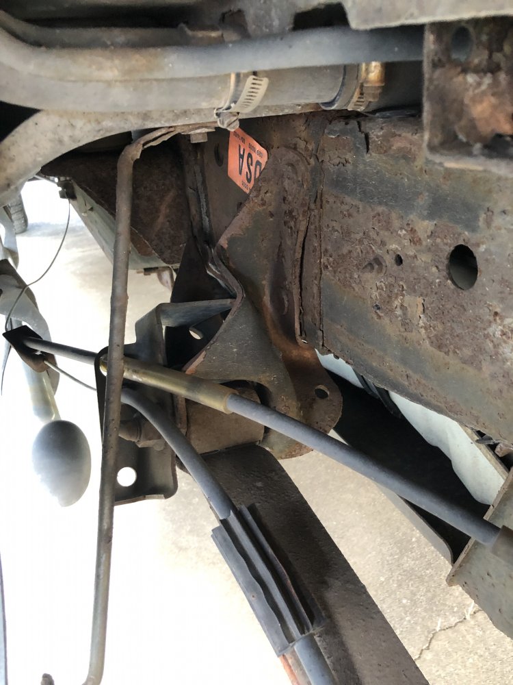

The truck arrived this afternoon and the most significant issue is that the left side forward leaf spring mount tore free from the frame rivets. There appears to be no frame damage, and even the shock mounts are intact. Should be an easy fix. Everything else is cosmetic including the cab corner, so we’ll see what happens. Here’s a pic of the leaf spring mount.
