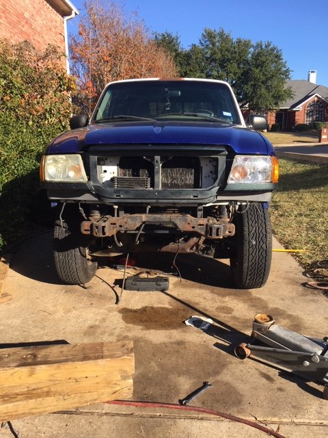

I started working on this project a couple months ago, and I decided to share my progress. I have a 2000 Ranger Extended cab and I’m in the process of swapping in a 5.0 out of an explorer, as well as a Dana 44 front axle and 9 inch rear axle. I’ve done the 5.0 swap before, but never a SAS so well see how it goes. I named the truck "Half-Pint" after Laura Ingalls
This is where I started
24692

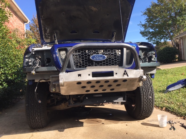

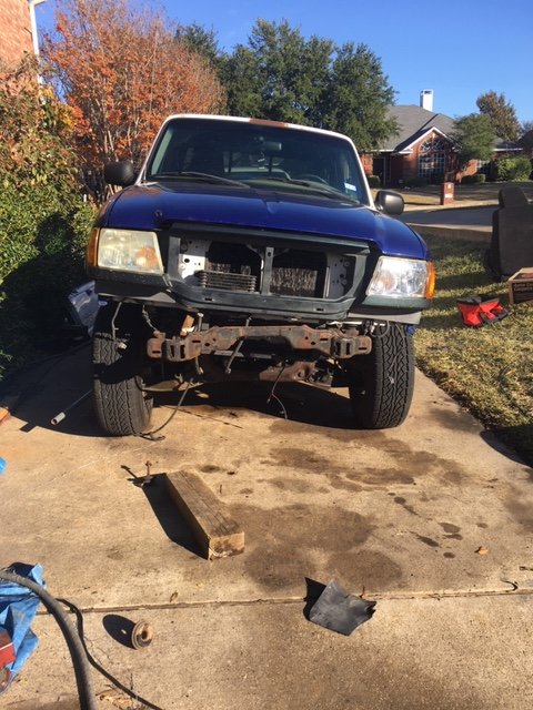

At this point I have removed the Engine, Transmission, and the entire front suspension. I have also replaced a lot of the body parts that were damaged, and installed a three inch body lift to help clear the bigger transfer case. I also got a pretty cool bumper from Affordable Offroad

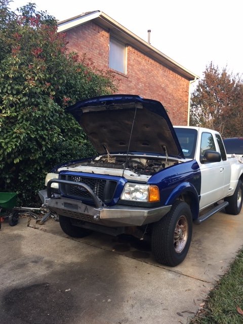

The hood, fenders and header panel are off an 04. To make the hood fit, you have to use the drivers side hood hinge off the 04. The headlight harness is also different, havent fixed that yet, but will post if I figure something out

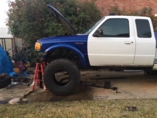

This is about where I want my ride height to be when its all done. Got some 35s for it and put one under to see how it would look. Also attached is the new transmission and transfer case. Transmission is a 4R70W automatic out of a 97 explorer, and the Tcase is BW 1356 out of an 87 Bronco.

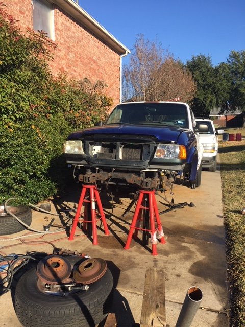

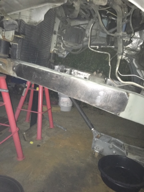

Sorry I haven't been on in awhile. Some good progress! Got the front suspension cut off and plated the frame, and put the rear end most of the way together. Im using an 8.8 axle temporarily, the 9 inch is gonna take some work to get ready.

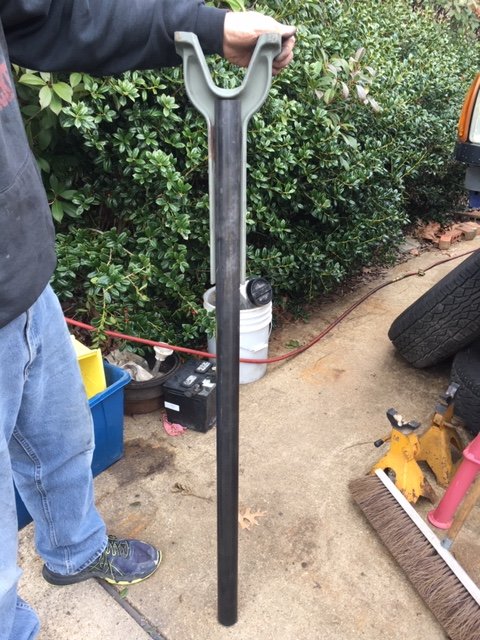

Also made some radius arms

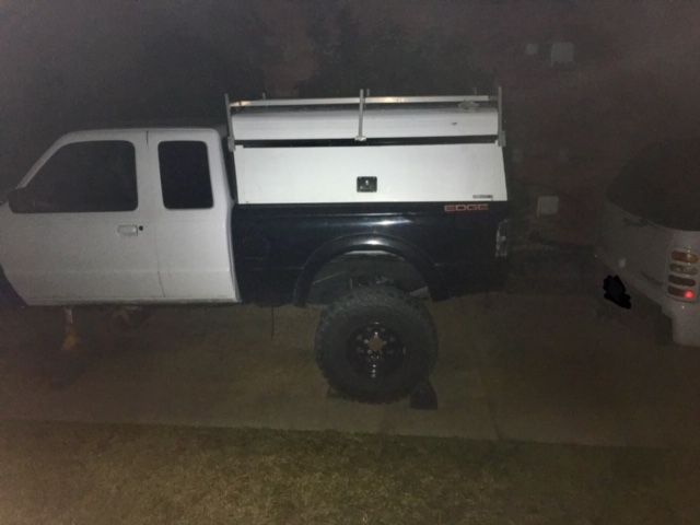

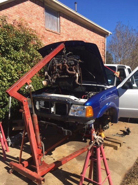

Welded on some coil buckets, put a bed on it, and started the engine/transmission install. The 1356 is a little bigger than the frame could handle, so I had to notch it a little. Will go back later and reinforce the frame there.
Also picked up a camper shell on craigslist. This thing is gonna be tall!

The radius arms were off a bronco. I cut them in half, split them, and welded some dom tube on to get them longer.

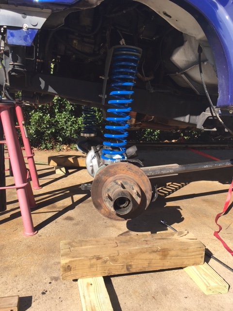

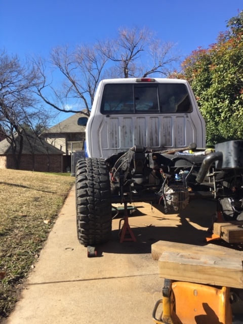

More progress. The front axle is mocked up underneath with the springs (axle still needs to be set up, just put the knuckles and hubs on for now). Ride height is right where I want it. The radius arms aren't attached to the frame, and Im using ratchet straps in place of a track bar, so its still on jack stands for now. Those 35s on the full width axles look mean!

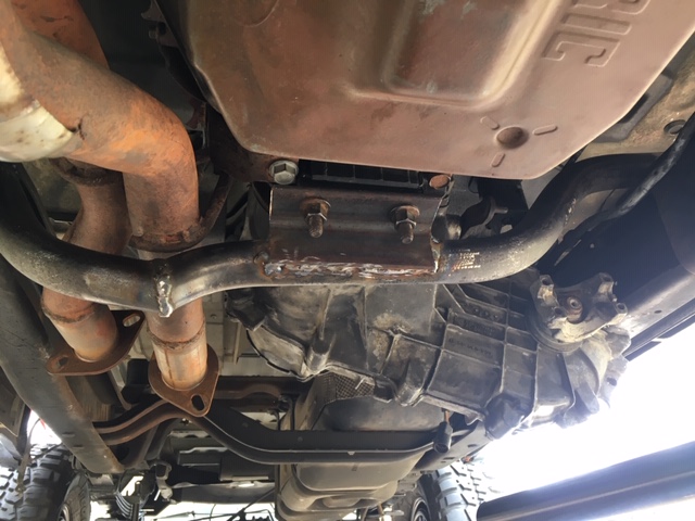

Had to cut out the stock trans crossmember, it was in the way of the front driveshaft. Bent up some pipe I had laying around for a new one, it seems like it'll work pretty well. Im not the best fabricator so Im pretty proud of it lol.
Also forgot to mention, I got it running a few weeks ago! I still need a throttle cable and some other minor hoses, but other than that the engine is installed. Apparently nobody makes replacement throttle cables for the Explorer 5.0, so Im gonna have to find one at junkyard. Hopefully itll move under its own power soon
