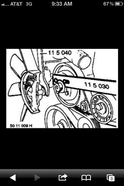

Im cleaning up my 5.0 for the swap and I'm going with an elect fan but I can't get the old fan clutch off. Since the water pump spins opposite of the crank, are the threads left handed? The other threads only addressed the 3.0 and 4.0 engines so I didn't know if it was the same procedure. Any help would be appreciated.
Airhammer with chisel bit works the best.
They make a special tool for removing it. You should be able to borrow it from autozone. The one I bought is similar to this one.
You can rent a fan clutch tool at Autozone. I just bought one though.
Trust me....the airhammer and chisel bit is the easiest. Since he is going with an electric fan.
I just use a wrench that fits it and smack it a couple times with my hand and it comes off. I have never really had one fight much as long as I have it on an engine with the belts still on it.
My 5.0 Explorer one was too tight to get a regular wrench on, I had to borrow the tool (wrench made out of flat strap iron) but it didn't fight me much either.

Standard threads, the WP turns the opposite way from the normal way (which requires reverse threads)
I was getting a new pump so I stuck the impeller in a bench vice and slipped off the fan clutch with the tool. Super easy, no problem.
All I was after was the pulley and the pump to turn in for the core. :D
Ths guys for the help. Used an old alt bracket and bolted it to the wp and gave it a wack with the crescent wrench and it came of easy. tyvm for the help.
