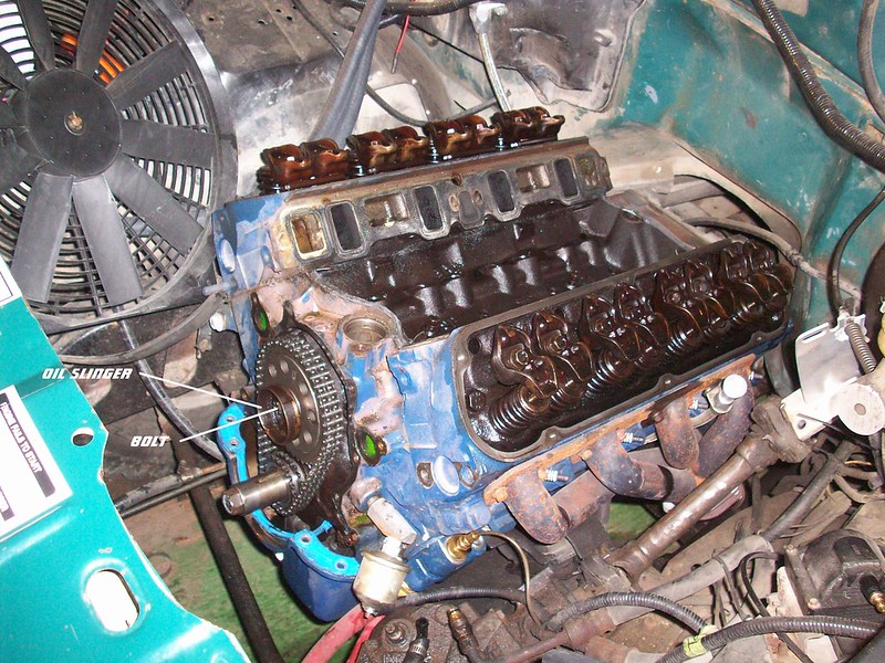

Step One: Demolition
Remove everything on the front of your engine down to the block; fan, radiator, all the accessories and brackets, water pump, timing cover and harmonic balancer all have to come out. Carefully clean the gasket surfaces and prep for reassembly. You will also need to remove the pressure power steering line from the steering gearbox.
If your engine has an oil slinger/fuel pump drive on the camshaft you will have to remove it. Replace the bolt because it does serve a purpose.

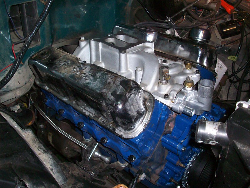

Step Two: Timing cover, balancer and water pump
Mount the timing cover and water pump, use paste thread sealer around the four bolts that actually seal the water pump (two per water port) Don't forget the timing pointer so you can set the timing if you are running a setup that requires setting the timing. Go ahead and install the heater hose on the water pump because things will get tight later. Keep an eye for rubbage as this goes together because it will want to get a little friendly with the alternator bracket. I have some accordion type wiring loom on it and a ziptie to hold it away from the alternator. Also don’t forget to install the bypass hose and orient the clamps so they can be removed down the road without having to remove half the truck.
Step Three: Cooling system test fit
If you are going to run a fan between the engine and radiator (mechanical or electric) now is the opportune time to figure out what you are going to run. I ran the 91-94 HD Explorer radiator in the stock location with a low profile flex fan with a conversion hub and a trimmed 91-94 shroud. I also have an electric pusher for a backup, it does run if I leave the truck idling for extended periods of time. Don’t install anything for good yet but it is a great time to check clearances.
My fan shroud required a little trimming to clear my fan, and harmonic balancer. The lower shroud mounting tabs are spaced different between my 2.8 fan shroud and the Explorer fan shroud:

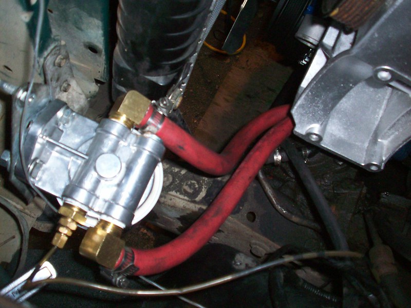

Step Six: Oil filter lines
I have my oil filter relocation adaptor mounted where the charcoal canister used to be, I found the best routing for the hoses with this FEAD was straight ahead and angling off to the adaptor. After the engine is in I could not remove it (it was rectangular shaped and would hit the engine cross member) so if you don’t get it right you may have to pull the engine.

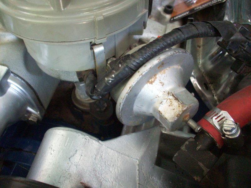

Step Seven: Drivers side bracket clearancing
Depending on what ignition system you run the drivers side bracket may need some clearancing for your distributor. I am running a Duraspark system and by timing the dizzy one tooth and rotating the plug wires one post off I got it timed by just trimming this nub. You can trim more of boss that the idler mounts to if you have to.
Step Eight: Mount drivers side bracket
You will probably have to play with the remote hoses and ignition so there will probably be a couple dry runs before you can finally mount the drivers side bracket with its idlers. Go ahead and install the bracket and pump when you are comfortable with how everything sits.

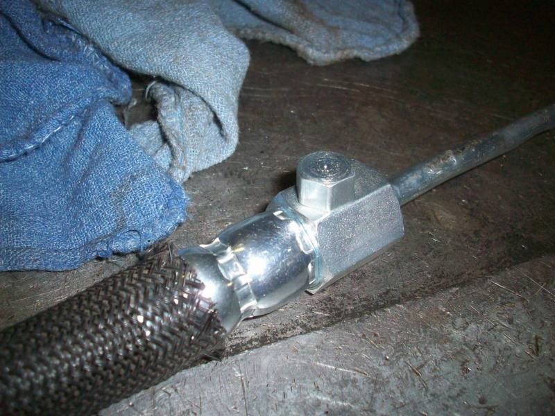

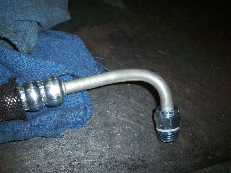

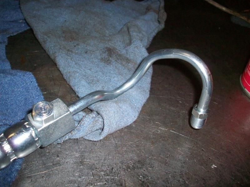

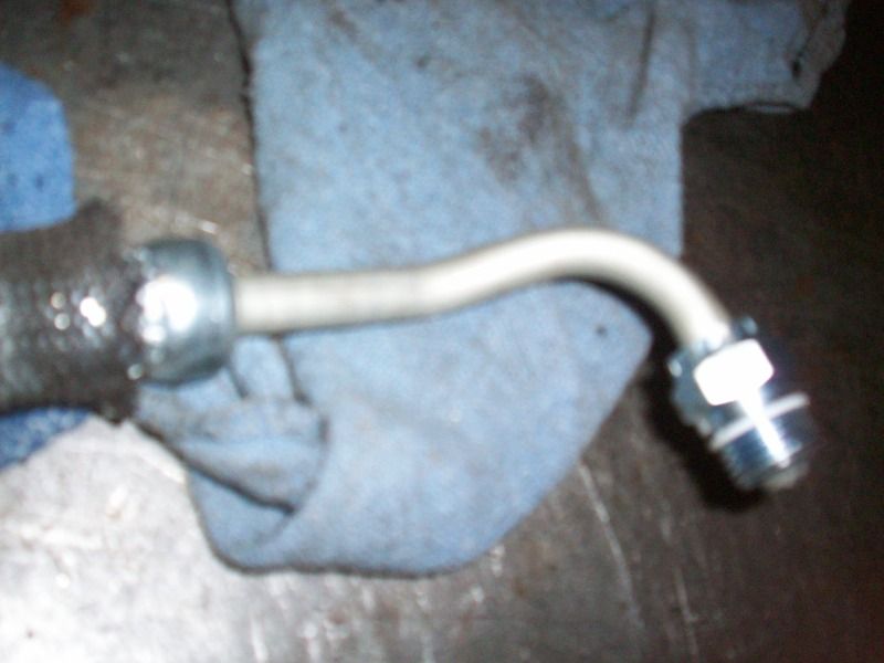

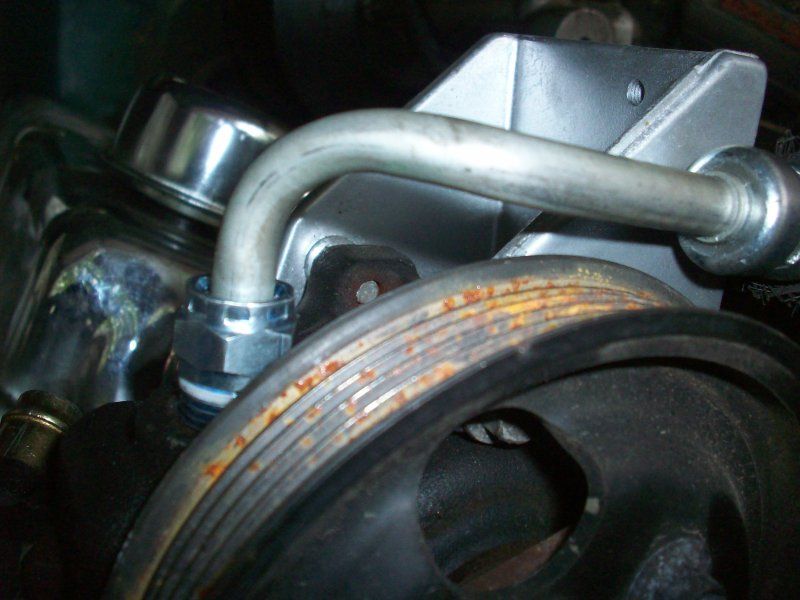

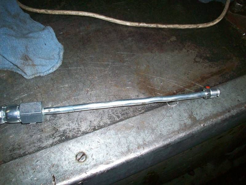

Step Nine : Power steering pressure line
By the time they put 5.0’s in Explorers Ford had changed the fitting on both the PS pump and steering (which was also a rack and pinion in the Explorer and is way too long) This means that neither the older Ranger or Explorer pressure lines will work. However the early 4.0 Rangers have a line that has the right fitting on each end. I used one speced for a ‘92 Ranger with a 4.0. I carefully straightened the curly Q stuff in a vice so it would reach and it fit very nice. It will not come with the nylon sealing washer, they are cheap but nobody stocked them (or the line for that matter) so make sure to order that when you order the line. Mount the pump and install the line. The power steering line didn’t sit quite the same as it did in an Explorer, mine sits over the PS pulley.
Pump side:
The gearbox side:
Don't forget to put the cap on the line unless you have to run the switch.
My truck has a 3” body lift, a standard height truck may have clearance issues between the PS reservoir and the hood. Keep an eye on that, you may have to lower the reservoir.

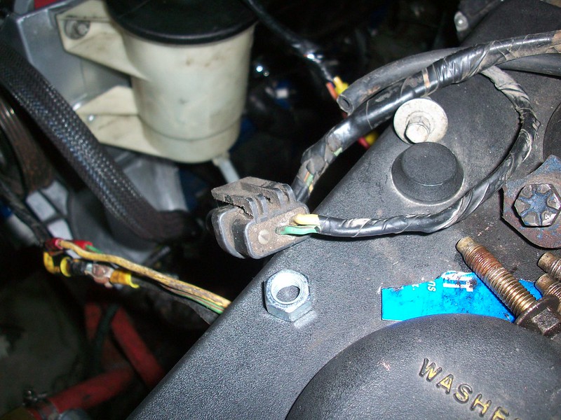

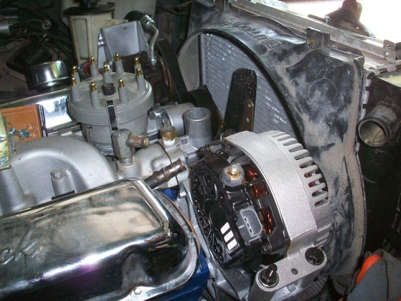

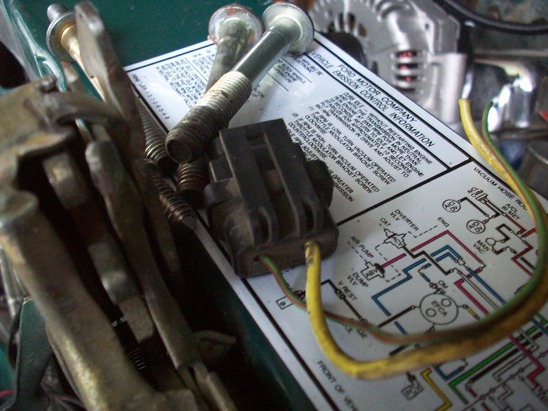

Step Twelve: Alternator
For some reason somebody before me had upgraded my ‘85 to the later internally regulated alternator, when I went to buy replacements back in my 2.8 days I had to get one for a 2.9 truck. My Ranger’s alternator had the main power cable going directly into it where the Explorer has a stud with a post on it so that needs adapted. Both alternators used the same connector but they are pinned differently, out of the three positions there are only two wires and between them one wire is mixed around. Mine had questionable wiring so I just spliced in the Explorer connector and was done with it. With the all the front accessory pulleys and idlers on go ahead and put the belt on.
My Ranger connector:
[url=https://flic.kr/p/X8ZeoE]
The Explorer connector:
The belt installed.

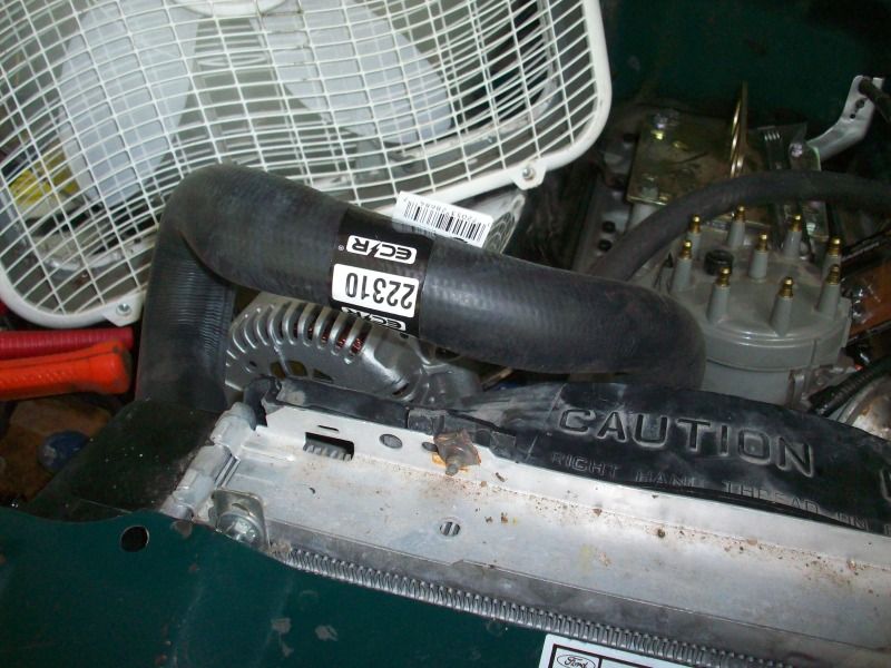

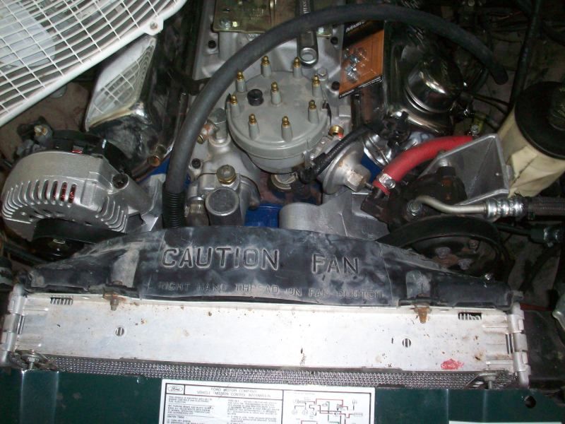

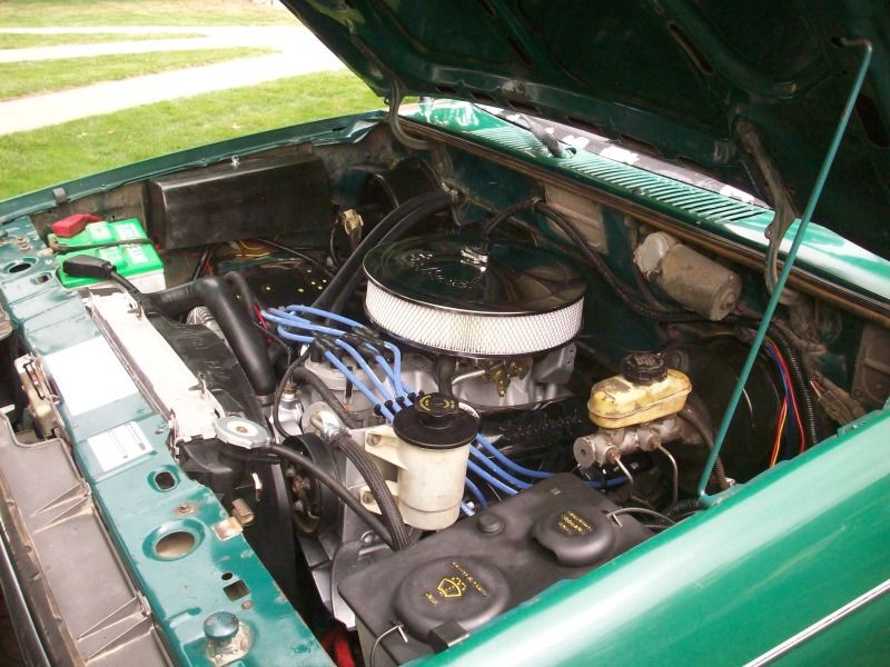

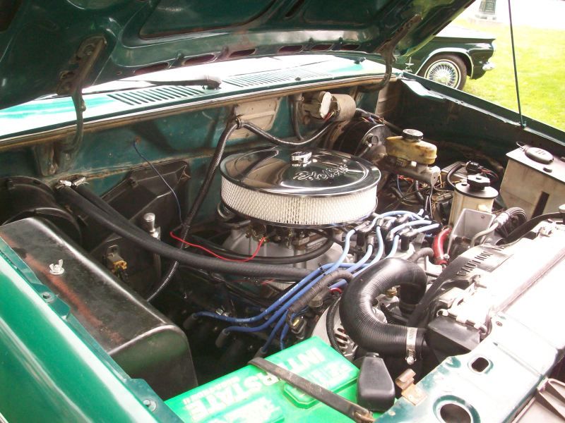

Step Thirteen: Cooling system
Install your fan/shroud of choice and then set the radiator in. I used a flex hose for the bottom hose.
My trimmed Explorer upper hose:
Note:
If you have the valve covers off for whatever reason you may have to pull the alternator as well depending on engine placement. I could not get my valve covers on with both the heater box or alternator in place… since the heater box has to go on first I had to remove the belt and alternator to install the valve cover. Even with the fairly tight setup with the shroud it was simple to slip the belt off and remove the alternator.
And when it is all said and done you have a more compact setup that looks great.
Pump side:
The gearbox side:
The belt installed.
Note:
