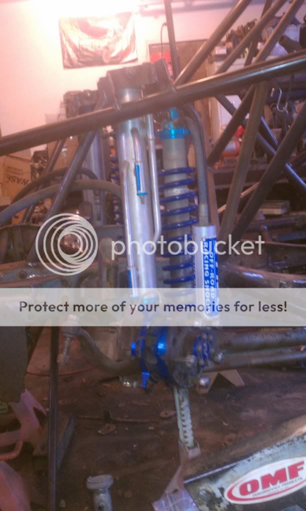

Started cycling suspension, first try 22in. Final #s 25in of travel.

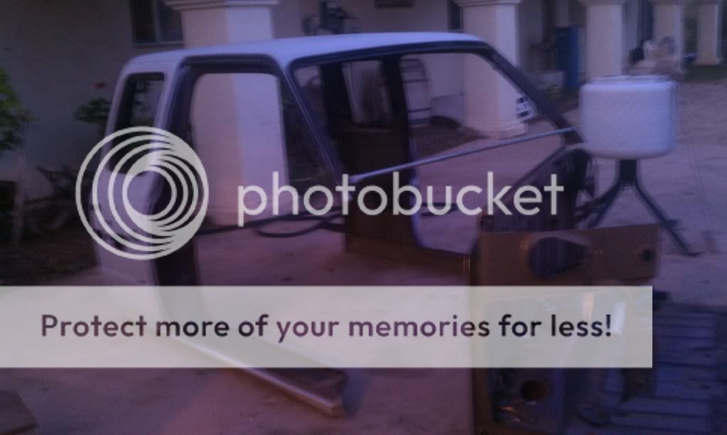

Starting pulling the cab apart, this is gonna be a lot of work...
4x4 v8 Ranger
The cab should sit about here.

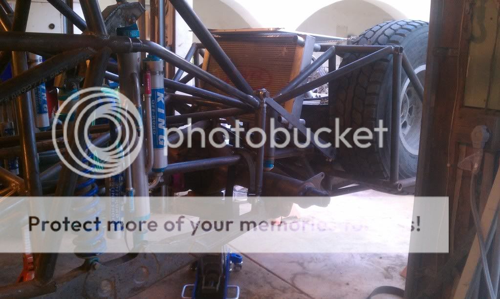

Got the rear shocks mounted. Just needs some more gussets to the tabs

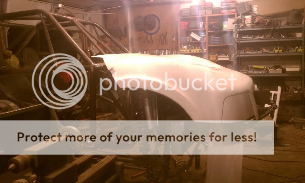

We have the cab cut apart and ready to start fitting over the cage.

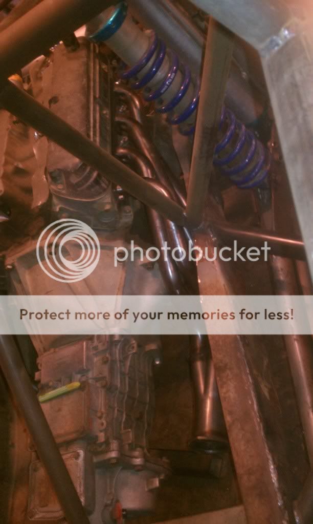

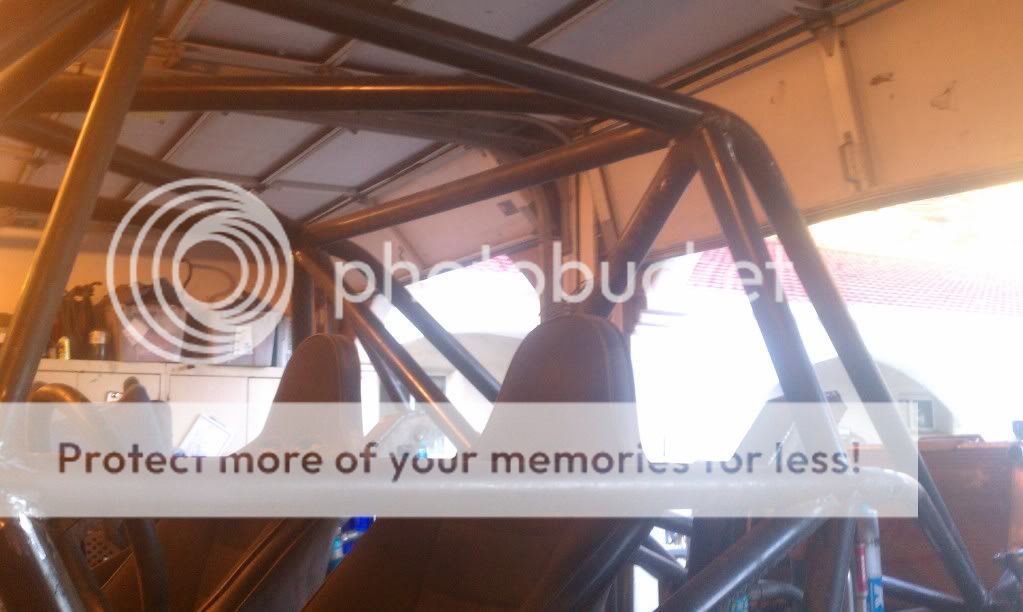

we got the seats and petals mounted. Clutch and gas are hooked up. Brakes just need lines run. The headers are almost done, we only have one tube left to make for the drivers side rear cylinder.

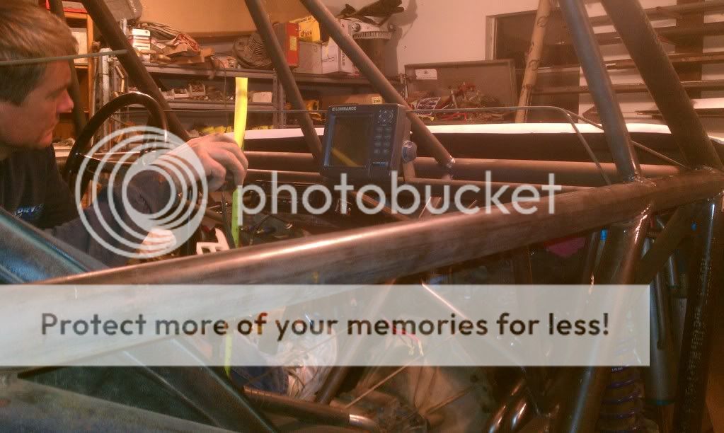

We started on the dash and cut the hood to fit In place so we can see if the dash is too tall.
