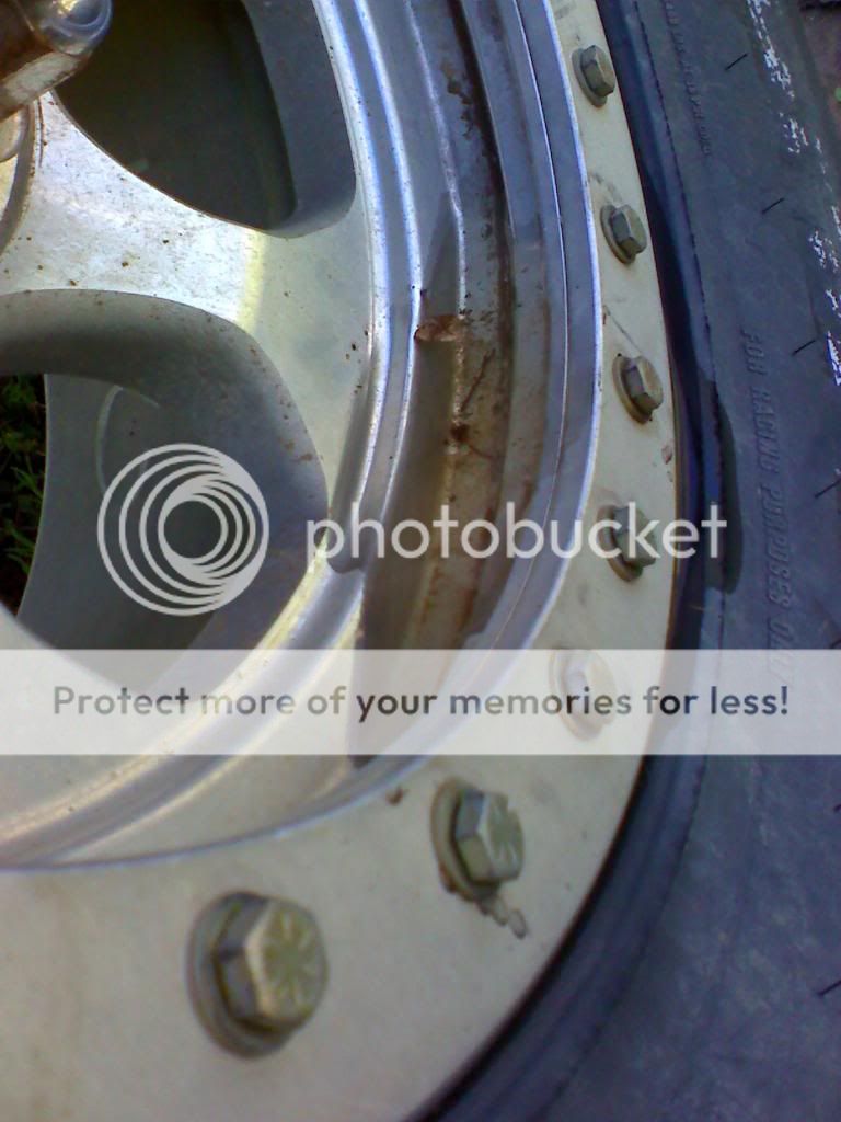

Watersheding beadlocks are part of the new design we have come up with. The design of a beadlock wheel creates a lip that sticks up into the wheel opening to attach the bolts to. That lip holds water and not only will eventually stain the wheel if the water sits in the lip long enough, it makes It so centrifugal motion doesn't shed the water out of the wheel so it will pack up with mud/water and make the tire out of balance from the mud sticking to one spot. I've got cad drawings of the ring I'm talking about but I can't show that so u will have to wait till the wheels hit the market in the next couple weeks.

Here is a pic of a normal beadlock that's been sitting for a while.
