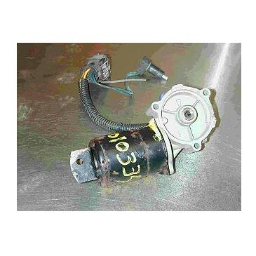

Those lights are grounded by the control 4x4 module. There is some info in our tech articles for troubleshooting that. But before going too wild with that, I would shift it back a ND forth a bunch if times and see if it starts working. Make sure you are in neutral and vehicle not moving. Often, these don't get shifted as often as they should. So the motor gets to where it doesn't want to work properly or the switch contacts in the motor assembly get dirty or corroded so they can't tell the control module what position everything is in. Do you notice the 4x4 lights flashing at all? Sometimes they flash to tell you of a problem. The motor is fairly easy to open up to clean its switch contacts and lubricate the worm gear.
