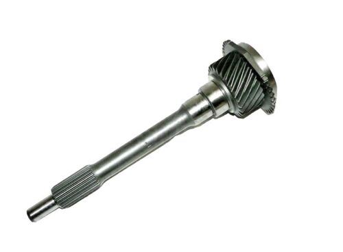

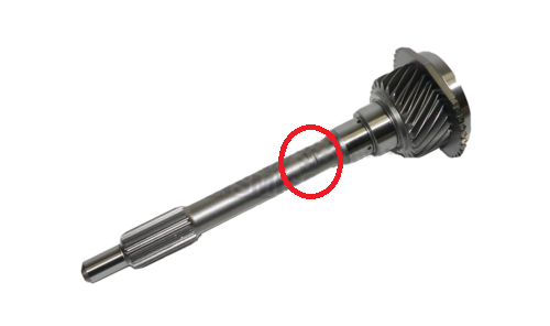

FWIW there are two DIFFERENT 23T input shafts and on aftermarket parts at least the 2.3/2.9/3.0 ones have an "ID ring" and the 4.0 one does not. I am guessing it's this, I pulled these off eBay listings, credit to seller "sasase"
