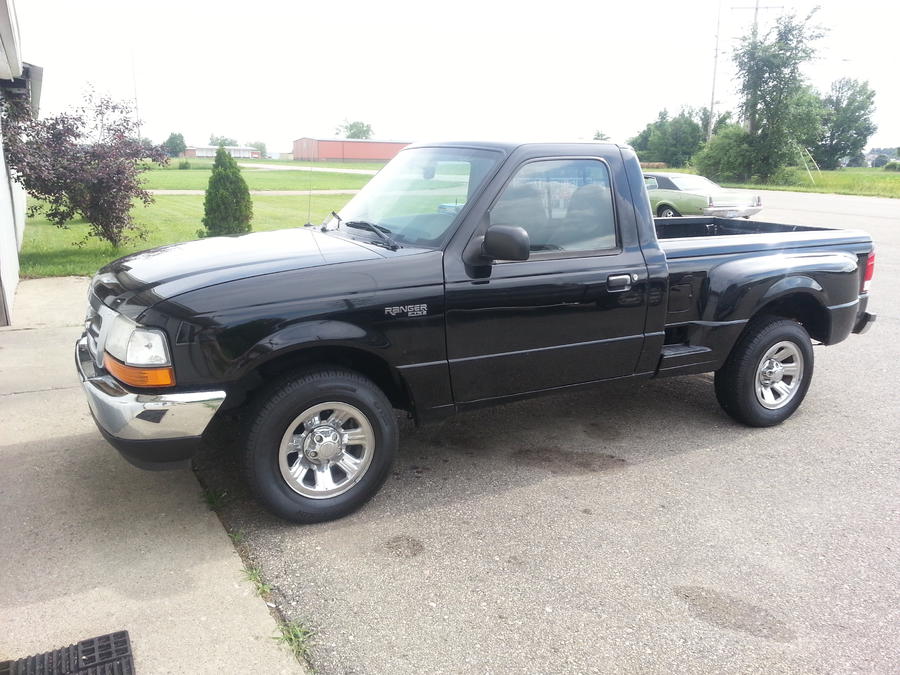

I have a 2000 2wd 2.3 ranger that id like to convert to 4x4 and finding a 2.3 4x4 transmission seems to be near impossible. Does anyone here know if I can swap the tail of a 3.0 or 4.0 4R44E onto mine?

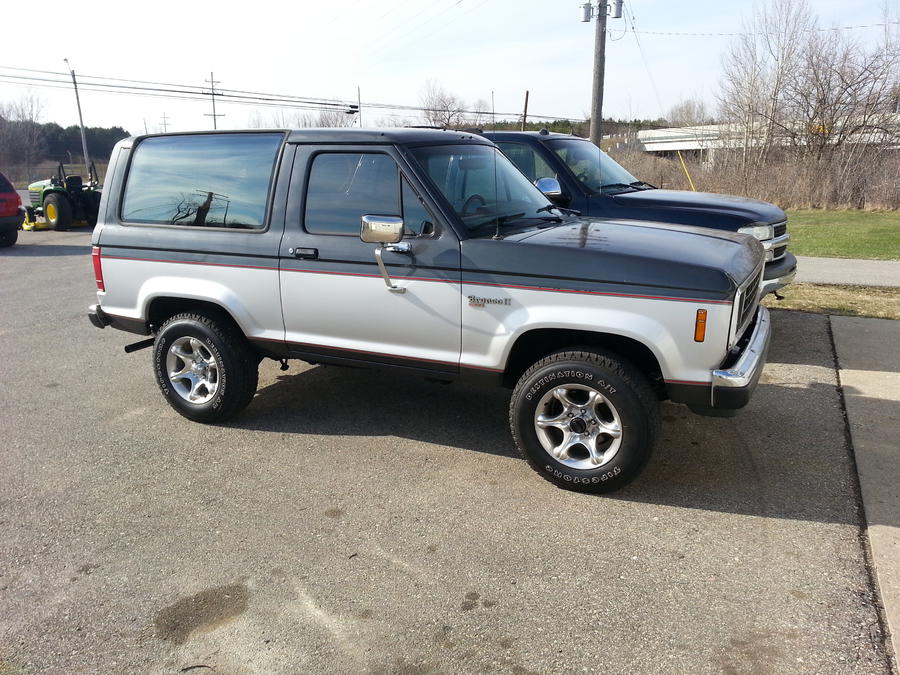

id love to use my b2 but its way to nice to take out on the trails!
