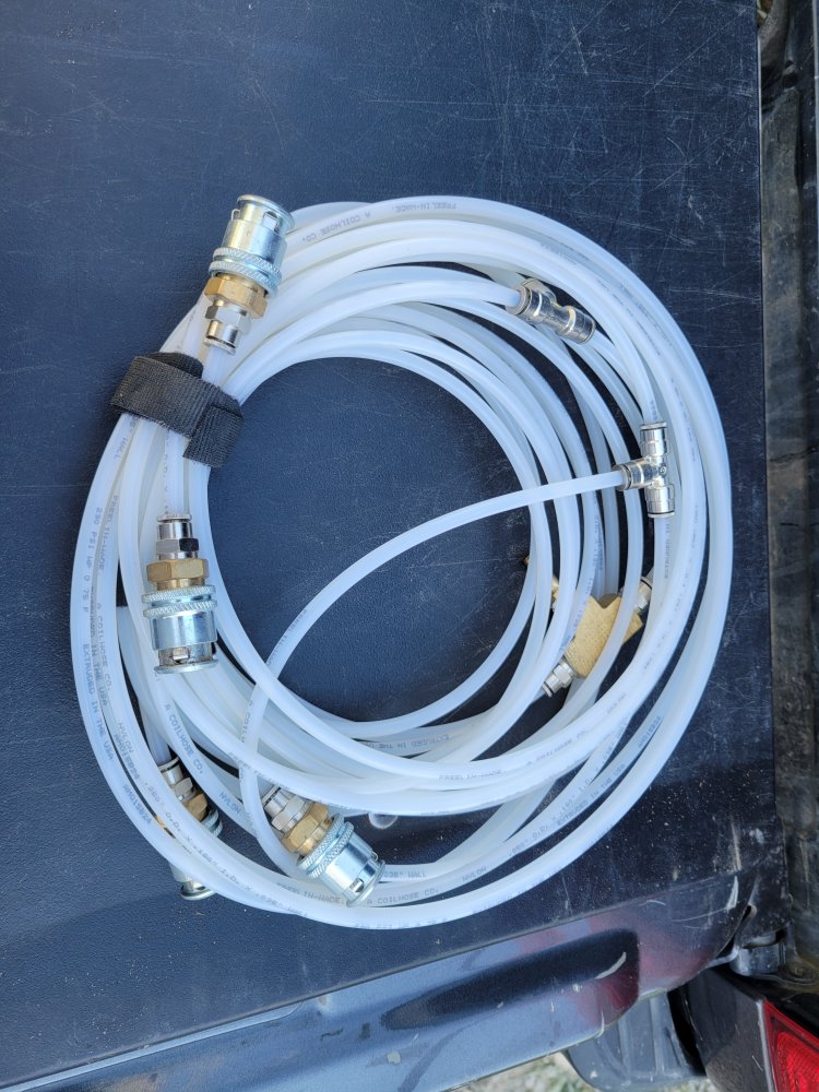

Well at my work we do quite a bit of pneumatic work. We stock multiple 1/4" NPT brass fittings, 1/4" ID nylon air line slip fittings, and rolls of line. This made me think I could just build my own 4 tire inflation system.

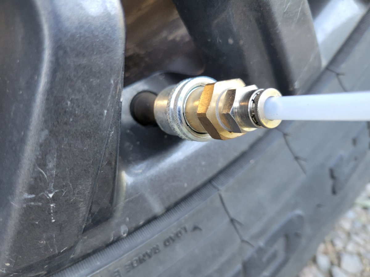

Breezliy 1/4" Inflation Schrader... https://www.amazon.com/dp/B09QMCF6BK?tag=959media-20
Kodilin 5PCS 1/4" FNPT Open Flow... https://www.amazon.com/dp/B0CPHPN8KD?tag=959media-20
After thought; should have bought the 1/4" FNPT that wasn't open flow. Let's air escape from unattached.

used some velcro staps to store it.

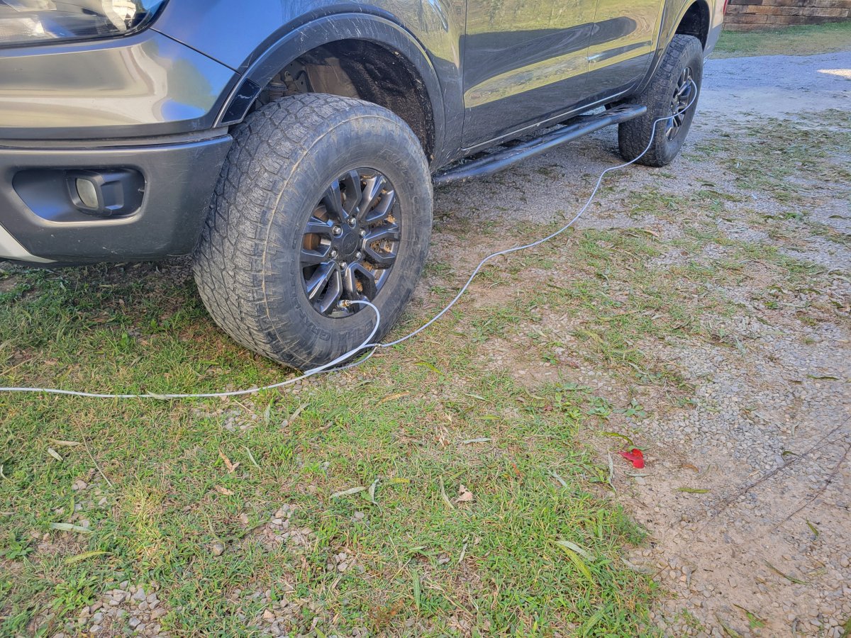

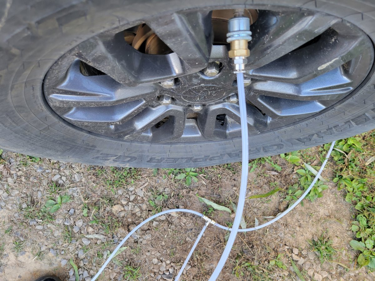

added a 1/4" T slip on at front tire location with 36" lead for front tires.
Then extended air line to rear tire.

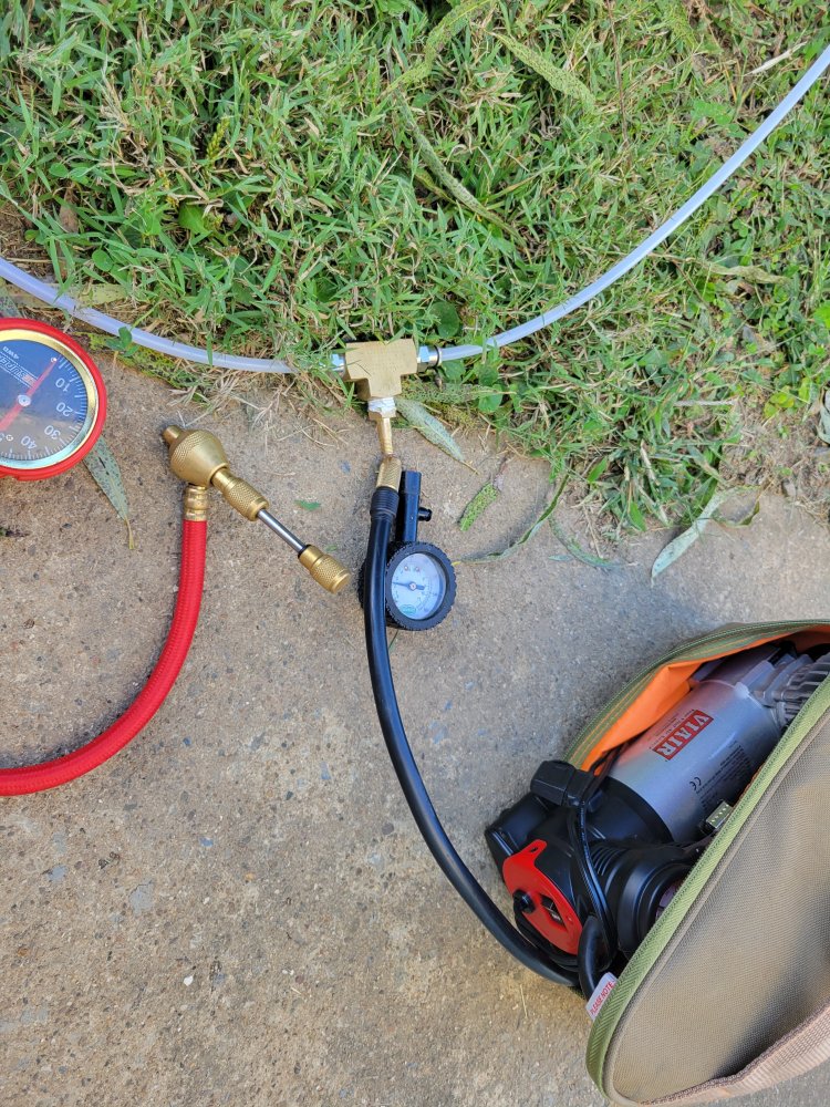

Used a brass T to split the front and add a shredder valve. I went with a shredder valve due to the equipment I have for airing up and down are for this type of connection.

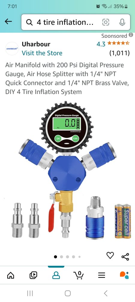

After I finished I did find this product on Amazon for around $40 that would make a great start.

One just needs to make sure their tire inflator is up to the task. I do like the idea and it might save some time since one isn't moving from tire to tire. I believe there are air chuck out there that are designed to be quick connect and disconnect with a spring loaded lever. That would be much better than the type the screw on the tire stem, causing lost air pressure while unscrewing the chuck from the tire stem.
It looks like the setup you have follows that line of thinking but those types of connectors tend to easily gum up when they get dirt and mud in them.

Yeah what brought it all about is I had burnt out my little compressor days before the Vagabond trip. I had an Amazon gift card from Christmas I had never used. So I started doing some research and found the Viair had a 25 min run cycle with a 10min cool down. So tested it out was able to go from 20 to 35psi on all 4 in a little over 7 mins. That's with 305/70r17s. No way my old compressor would have made it. I'm sure if you cycled a smaller compressor ot might hold up but that would be risky.
