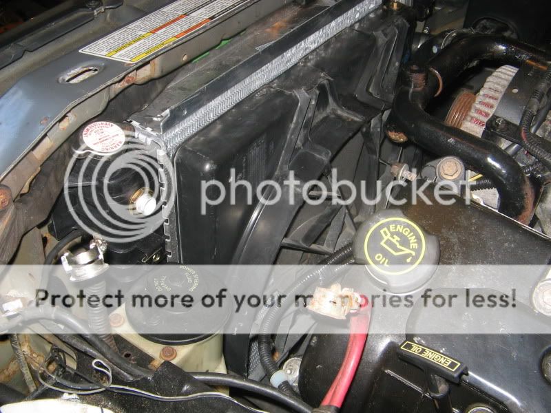

Got the radiator in and steering pretty much done. Next it's on to making headers, bought a set of cobra manifolds, thought they might work due to being smaller than the Mark VIII's manifolds, but they are not going to work. Bought a set of flanges off E-bay and an old set of 302 headers.

Great build thus far! Im stil amazed at how "easily" the motor dropped in. So headers will be custom? and what are you doing far as steering?

The steering is done, I mention it in some earlier posts. I used what another member used for steering (sterring shaft from a 96 Crown Vic) which actually works out very well and was very cheap to do.
Headers I will start next, after I get the tranny in. Bought some 4.6 flanges off e-bay and some cheap used 302 headers to cut up.
So far I don't have a whole lot of money tied into it:D, the most coming from the intial cost of the truck. I was keeping track of it all, but kind of stopped awhile back.
