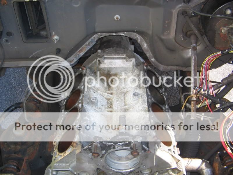

Well got the engine and tranny out of the Mazda last week. Now time to get the 4.6 ready to go in.
Greg: How did you make the motor mount brakets, did you put the engine in and tack weld the plate or did you measure them???? Thanx
[/IMG]
[/IMG]
Well finally had some time to work on it this weekend, but it was a bit warm so didn't get as much done as I wanted. I found a block for pretty cheap and I already had a striped tranny, so it made the fitting aspect much easier this way. Should have the mounts done this week and hopefully have the engine in soon.
