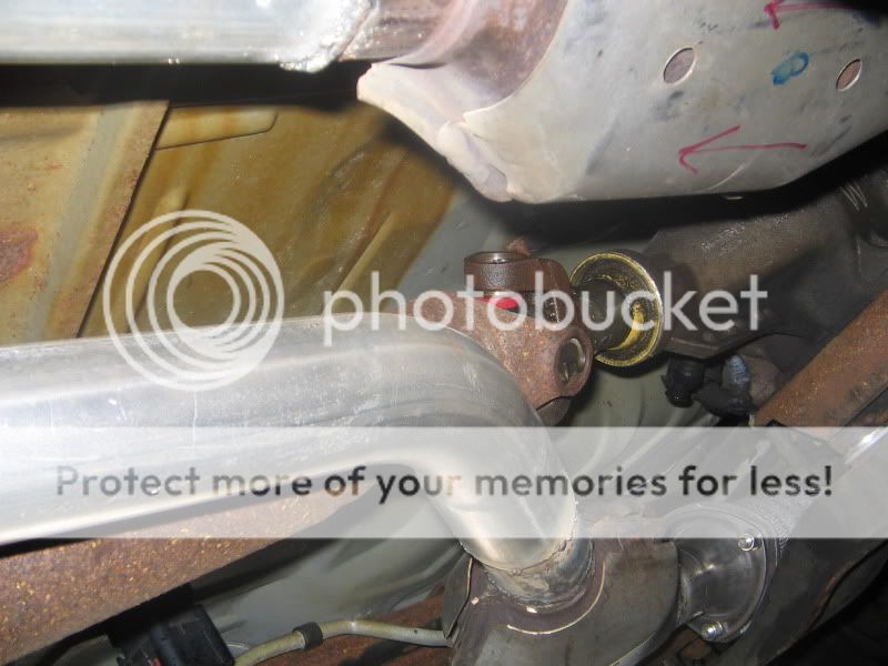

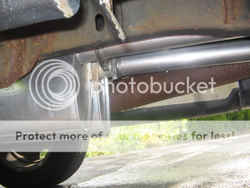

Well it's been sometime again since I posted and figured I would make this the last update as this thread has gone on for sometime now and it's almost finished.
After dealing with some issues on the home front, I was finally able to finish up the exhaust.
I have driven it a few times and is a blast to drive. Doesn't appear at this point to be too many bugs to work out. I do hear an exhaust leak, but that's minor.
