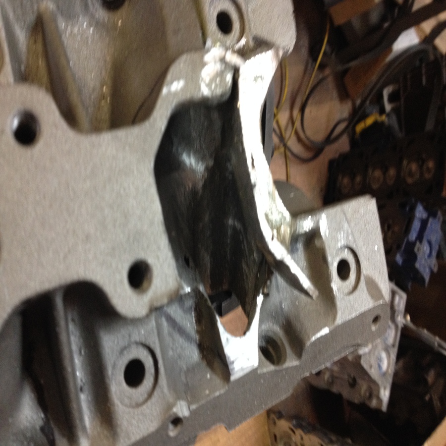

EDIT: I think I should add a bit more info for those who are reading this thread. Hopefully someone will reply with some hard facts. All threads I've looked at so far have been sort of vague when it comes to the fitment of the 2.9 distributor in the 4.0 block. The big question thus far is will it clear the intake system. If not, then by how much ? From what I can tell by looking at pictures is the rotor cap may contact the mounting surface of the upper intake. However, it appears to me that the one rear stud could be chopped off to make it work. If anyone has a motor on a stand and wants to help resolve this issue that would be ultra cool.

I just got off the phone with Tom Morana, let me tell you is one hell of a nice guy. He kept on talking all sorts of technical stuff that swept me away. He said that the 4.0 runner needs to be cut back and plumbed into a different port. Hes supposed to send me some pictures (fingers crossed), but he assured me its obtainable with a little grinding & welding. He continued to tell me that there are some guys modifiying the cam position sensor to work with carbed applications and so on. He continued to speak about products he is working on which include a efi distributor intake system and a new super charger. By the sound of things hes got a lot of projects in the works but can only do so much within time restraints. So anyway, thats whats happening until further notice.

EDIT: I have pics from Morana Racing of a cut out lower intake for the distributor but the files will not up load. It keeps saying up load failed.

So here are the pictures
