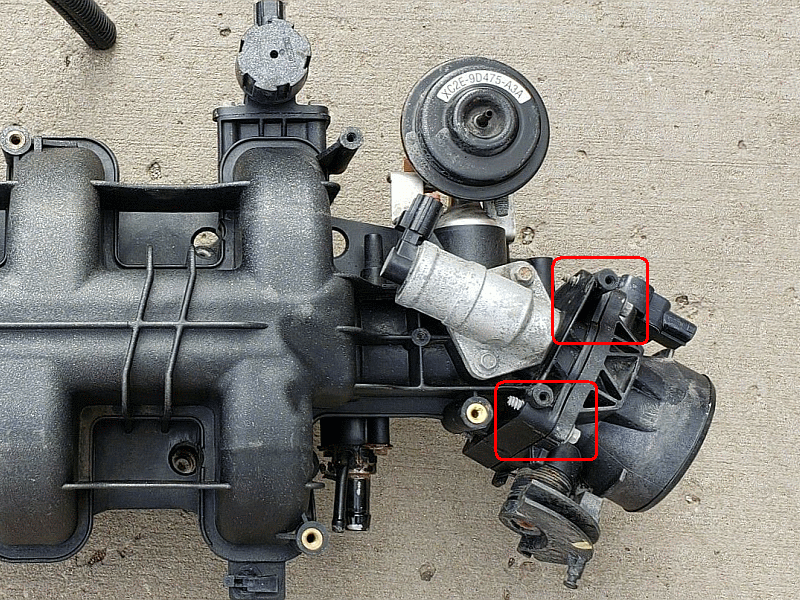

Top view\pic below of ThrottleBody attached to Manifold, screws circled in red;
likely a German specialty flange screw, considering where engin was made.
Three possible solutions:
* HexHeadFlanged LagScrew from the Bolt+Nut isle of your local hardware store;
measure Thread diameter with a Caliper.
* Smaller diameter HexHead FlangeBolt or StandardBolt that fits thru existing holes;
add FlatWashers as needed, HexHead NyLocNuts on the backside; stainless preferred.
* a JY run to find an identical replacement from another Ranger\Explorer\SportTrac\...
A dab of AntiSieze\AxleGrease\Vaseline on the bolt threads & don't over tighten,
as a courtesy for the next poor bas'ard who needs to work on this vehicle+part.
Not sure if same is used on your 2004 V6~4.0~SOHC,
but the 2001 TB part# is 1L5u-9e926-ca, pic below.
