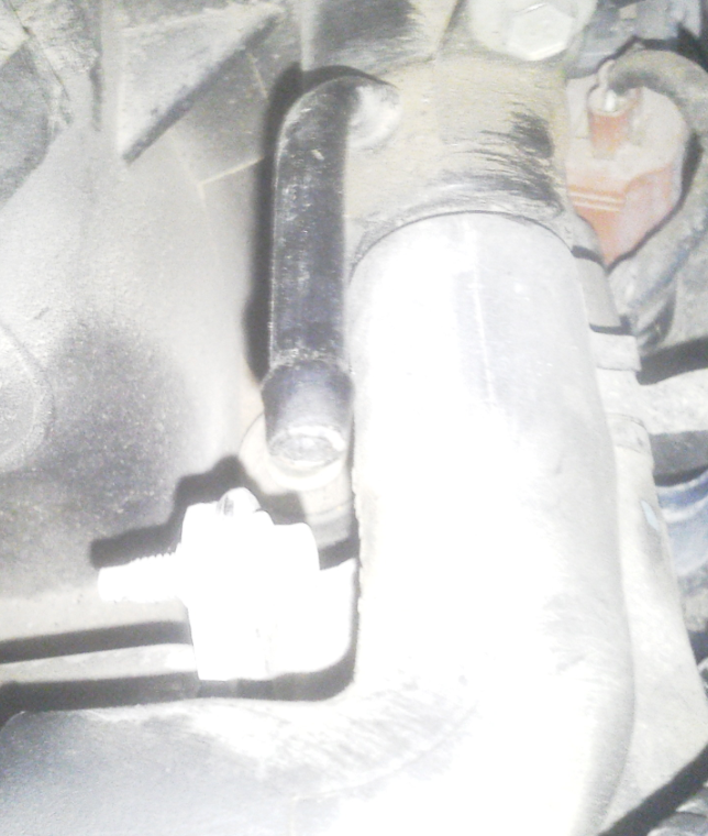

Here's the piece on the fuel rail

Yeah, you need a new valve cover. That is going to cause you some problems.
And that first pic, the fuel rail is in it, but that doesn't look like it's attached to the fuel rail. That looks more like a vac port, or a coolant passage for a heated PCV.
Can you get a wider angle?
I cant find one anywhere. My origional one had that nipple and the oil cap broken off so I bought that one as a replacement off eBay to find out the oil cap wasn't broke but the nipple was gone lol. Can I just go to a hardware store n pick up a 5/8" PVC nipple n attach it the same way I was going to with the filter?
That may work.
