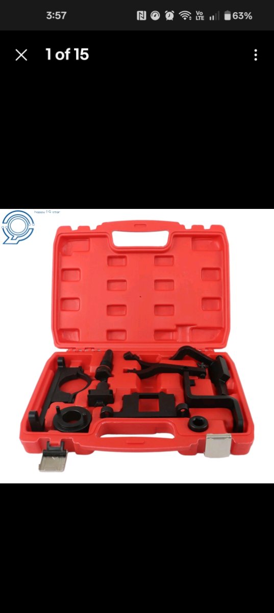

Have any of you guys used the cheap ebay $50 timing tool kit or should I just pick up a used OTC kit for under $150? It's tempting but then again I don't want any reason to not be able to do a good job...
OTC has a general reputation of making decent tools that are about as good as what the vehicle manufacturers recommend, at a lower price.
If it was me, I would go with the OTC kit over whatever the $50 kit has to offer. Since so much work goes into the job and it is so critical, I'm not sure I would want to take a gamble on a cheap kit being good enough.
OTC when I worked at Ford Engineering was the special tool supplier.
I was thinking the same but wanted to ask to make sure you guys weren't using the cheap kit with fine results.

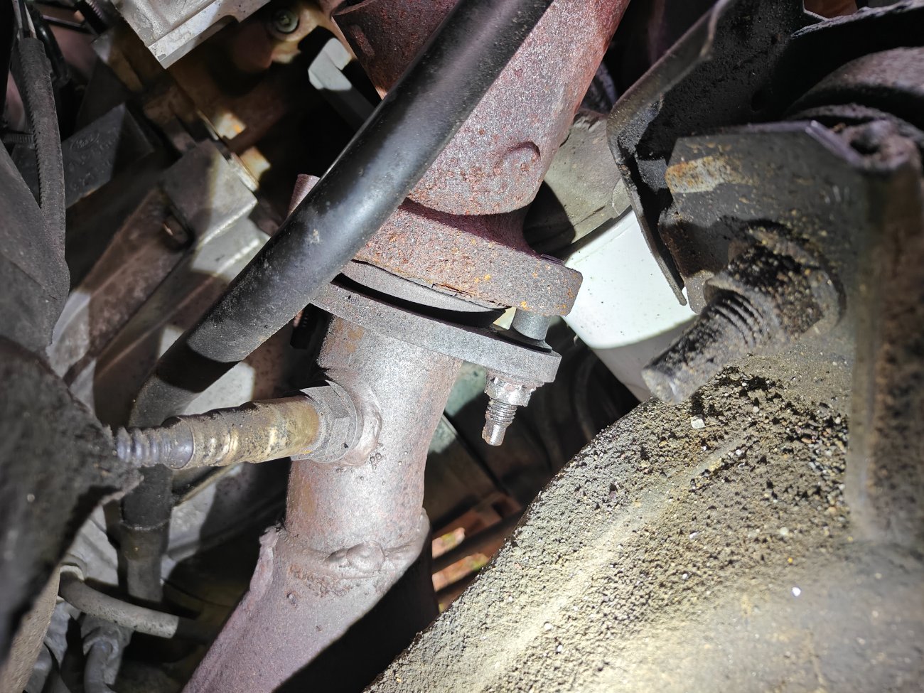

Another crisis has arisen lol😭. My 1/2 DeWalt impact spun the exhaust bolts out fine except one. I thought it was turning but it was just rounding the nut off. Do you think it's possible to just sawzall through it and replace as needed before I put it back together? The only reason I ask is because I don't have any good metal blades here or I'd have already tried it😂
Opps...
Before I took a sawzall to it... I would try a little heat and tapping a smaller six point socket or a nut extractor on it and try to zip it off first.
Those studs look pretty pristine.
