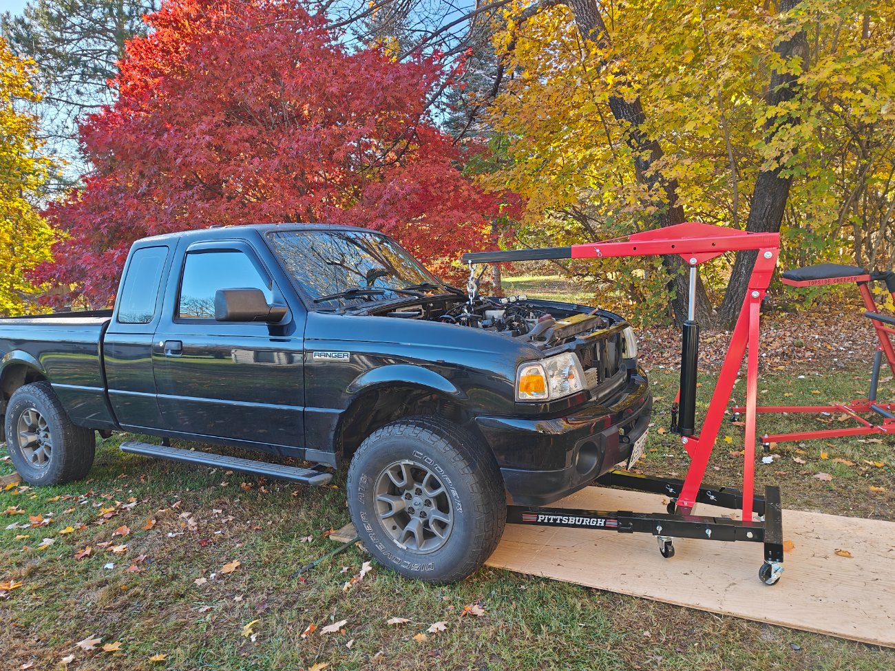

You might have to take the front tires off and lower the truck down to get the engine over the core support.
You will also have to support the front of the transmission. It will want to drop when you separate the engine from it.
Floor jack and block of wood lightly under the bell housing... maybe a ratchet strap across the frame rails... something to catch it.

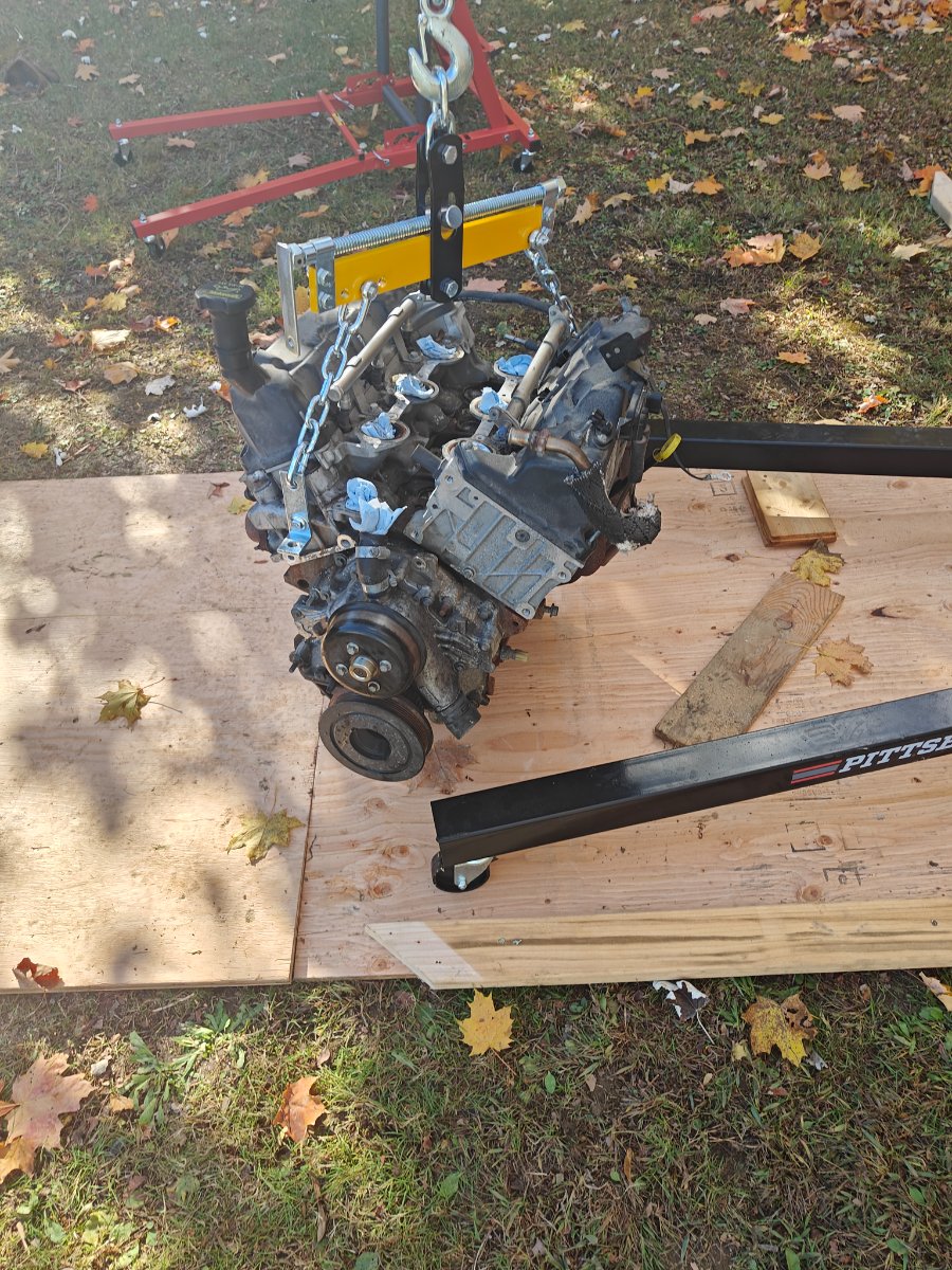

Got her out. Uncle Gump, I cheated and returned the 1 ton hoist and got the 2 ton. It was worth it I think because it lifted plenty high enough.

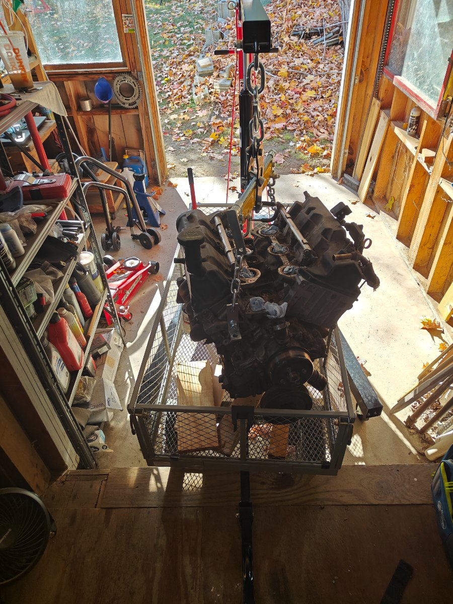

My buddies on the way with one of those heavy duty 4 wheeled carts. I'm going to set it in that and wheel it in the shop and then pick it back up to put it on the stand.
Touchdown. What a relief. Now I can take my time and fix my motor. Honestly I might take all winter at this point haha. But at least I'll be indoors in a heated room working on it now.
I have a jack as well as a jackstand under the front of my transmission so it can't drop. Do you guys think it'll be fine just sitting there indefinitely? I'm thinking wrap the front with a trash bag as best I can?
As long as the torque converter is pushed back you should be ok. Taping a garbage bag over the bell housing couldn't hurt.
You may need the jack and/or jack stands before you get it back together... a rachet strap across the frame rails will keep it in place.
