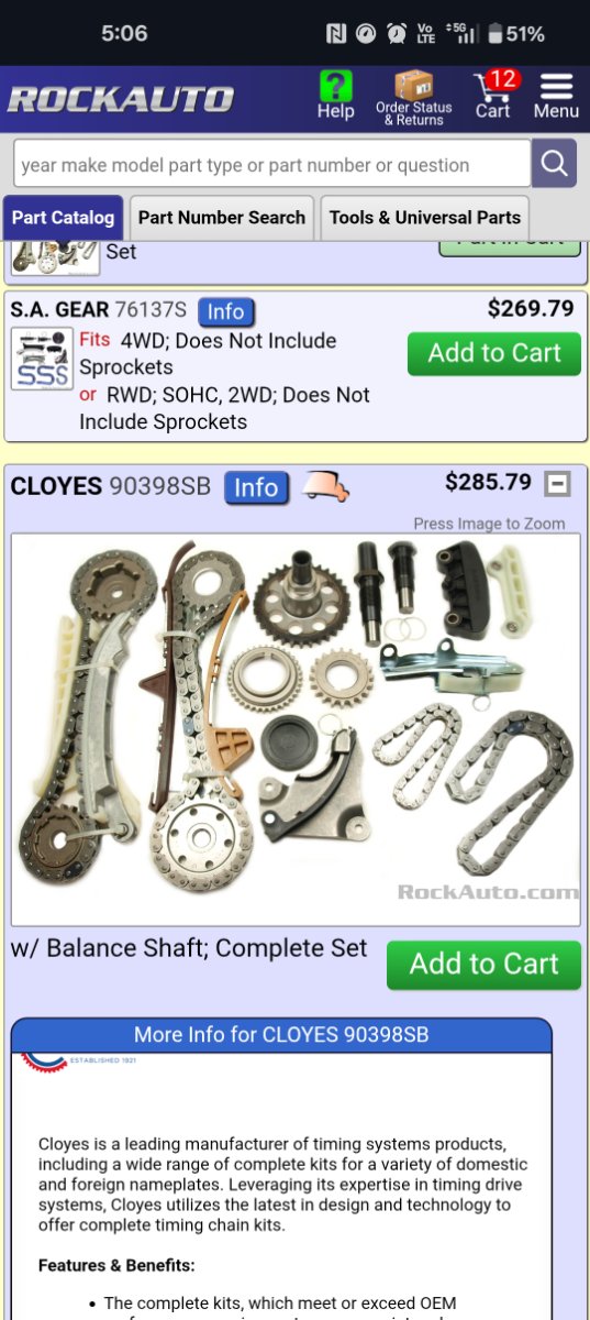

Ordering parts, should I get the entire timing chain rebuild kit from Cloyes or can I get away with a lesser kit? Inconclusive whether or not I have a balance shaft so I guess I'll order the one that includes balance shaft? There doesn't seem to be any rhyme or reason as to which motors have a balance shaft.

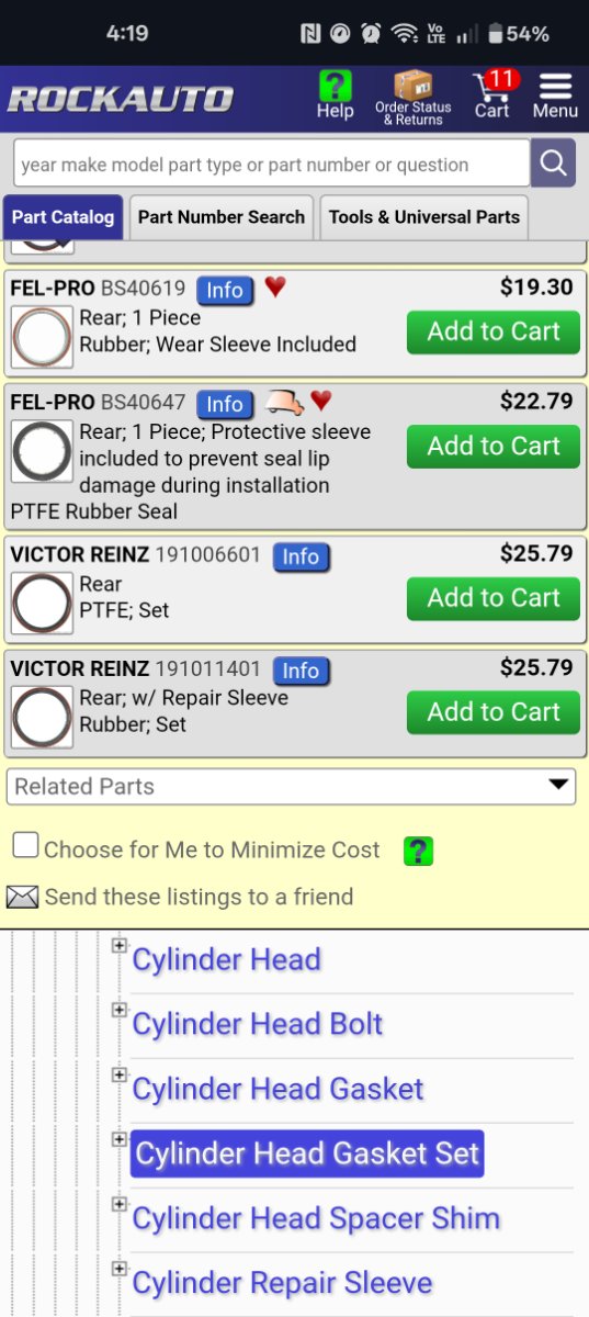

And my second question on parts. I want to replace my rear main seal and I'm guessing that's called a "crankshaft seal" on Rock Auto? I included a photo, which one do I need or are they 2 piece so I need the one that says "set" or 1 each of the Fel Pro seals? Thanks guys!
Fel-Pro BS40647 is what I got. I just got my 4.0 SOHC yanked today
Awesome, thanks! Why did you have to pull your motor, just for the rear main seal?

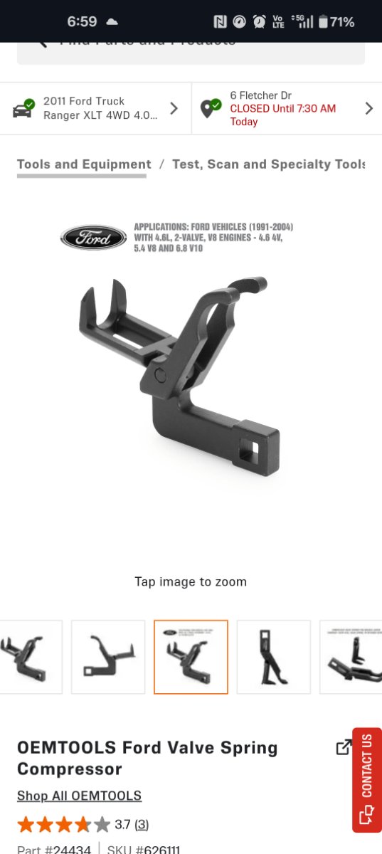

Will I need a valve spring compressor to do this job and will this one work?
Never used that style. I have a valve spring compressor that hooks onto the spring and compresses it. It works, but I think one of these days I’d like a bench mounted one to use if I have the heads off
I don't think you'll need that unless you plan to pull the heads apart...
