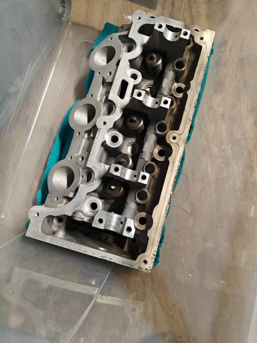

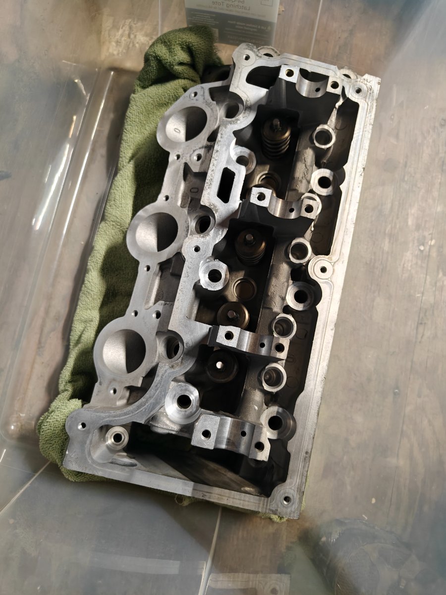

Cylinder heads back from the machine shop and in perfect order!!! Picked them up yesterday morning before I had to go sit in jury selection for 8 hours straight (that's your reward for paying taxes). Full rebuild cost for both heads was $650. That's cheaper than either set of those junk reman heads I tried.
The reman heads were painted to look nice and "new", who gives a shit? So they spend their time trying to make it look like they do a good job instead of ACTUALLY doing a good job.šŸ˜‚.
I'm not the first person to say this but I can't stress it enough and I learned my lesson. Stay away from remanufactured crap unless you absolutely have no choice. Try to find a local machine shop that does good work, it'll be less stress in the end and maybe even cheaper!

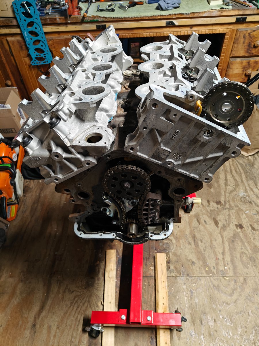

Take two. Tomorrow I'll time this pile of 4.0 SOHC.

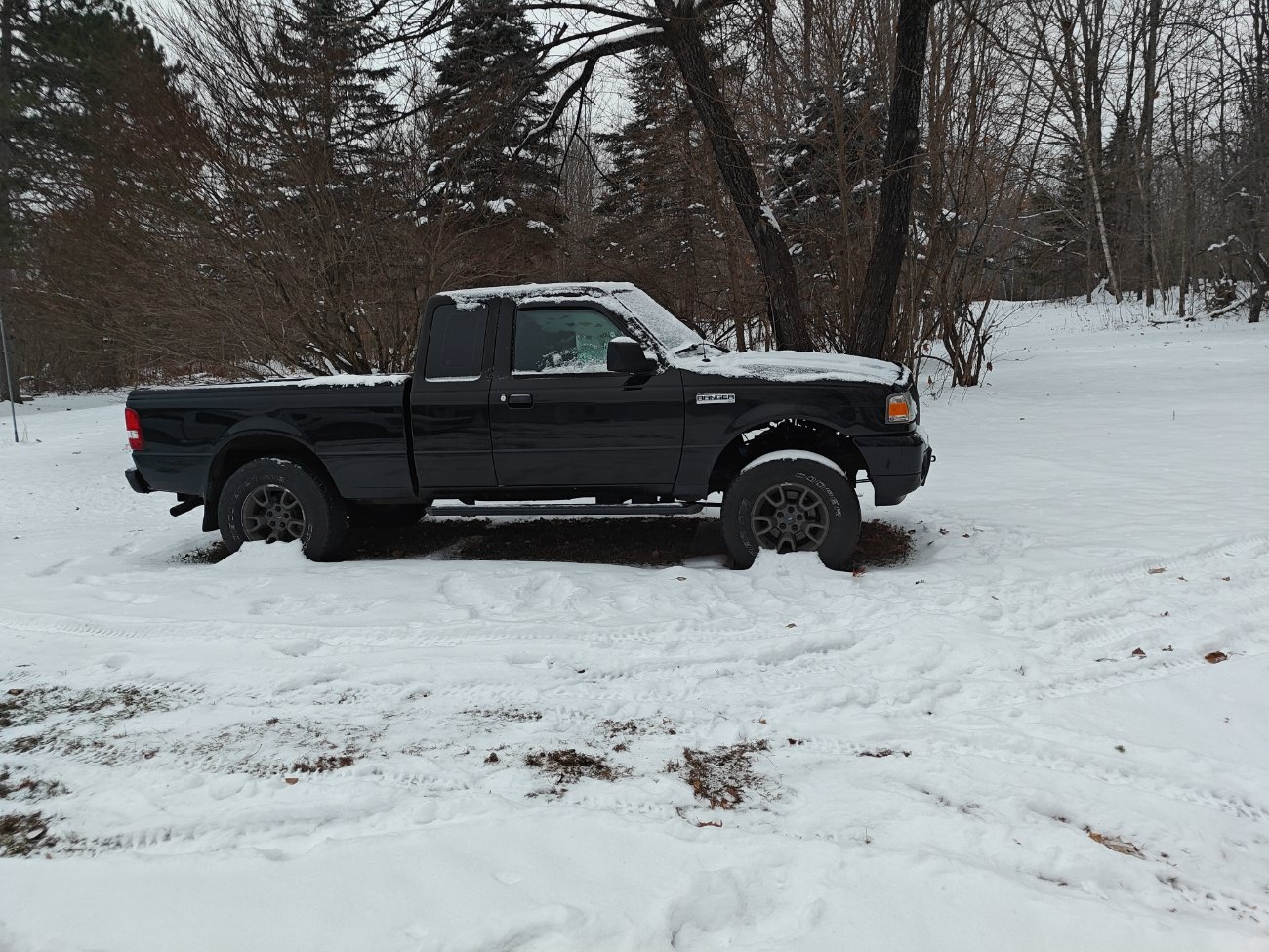

Has anyone installed an engine in these conditions? Wondering if it messes up torque values, leads to broken hoses, connectors etc.?
I've been there before.
Biggest issue is cold fingers... and snow melting and soaking through your Carhartts.
Okay I can deal with that. I work outside in it everyday, I wouldn't say that I like the cold but I'm used to it at least.

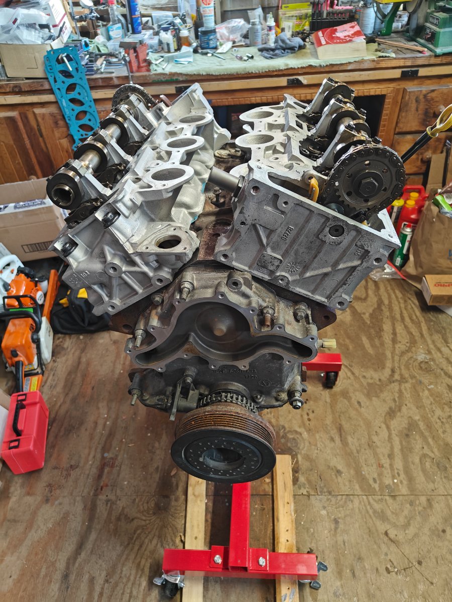

Cams in, engine timed, timing cover and harmonic balancer installed.
Do you guys see any reason not to use the OTC timing kit to lock the cams in place while I torque the harmonic balancer? I'm going to use a strap wrench as well but not sure I'll be able to hold the full weight of torque plus angle.
Is the flywheel/flex plate still on it?
No it's off to put it on my engine stand. But now that you ask and I'm looking. I didn't need to take it off did I?
I could wait until it's on the hoist and torque both the balancer and the flex plate before installing the engine
