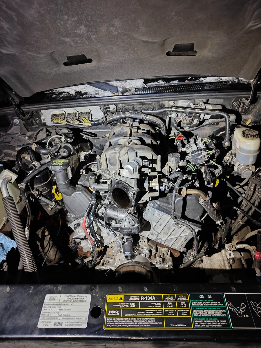

Downhill slope now I think. Ran out of daylight but I got the bell housing bolts all in, torque converter nuts torqued on, everything bolted to back of cylinder heads and O2 sensors plugged back in, starter on and intake manifold. The rest of the work is in the engine bay and maybe through the wheel wells but no more climbing underneath!

Not much different to look at under here but some work was accomplished today:

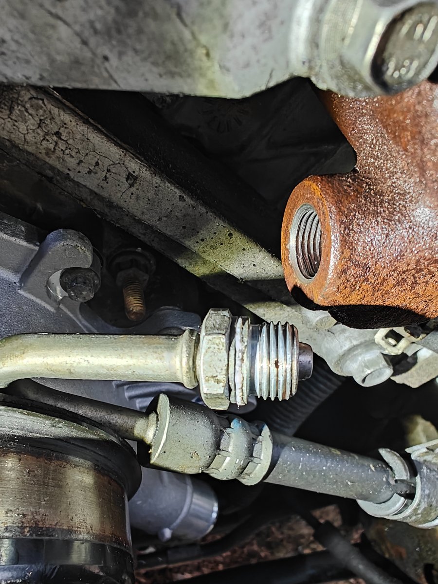

Manual says there should be a Teflon seal in-between the power steering fitting and pump? I didn't see one when taking it apart but very well could have dropped it. do you guys just use Teflon tape?
