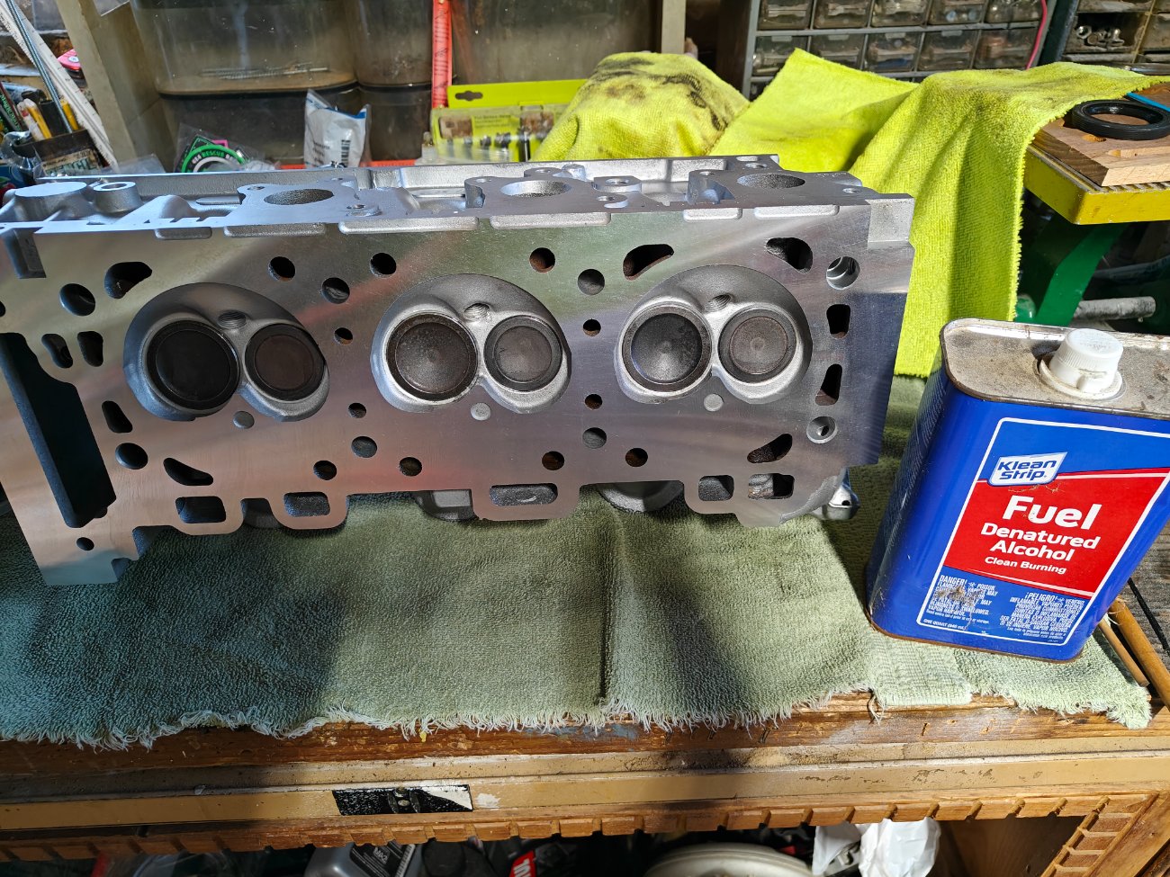

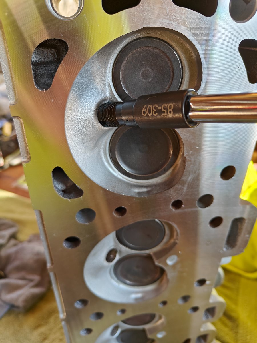

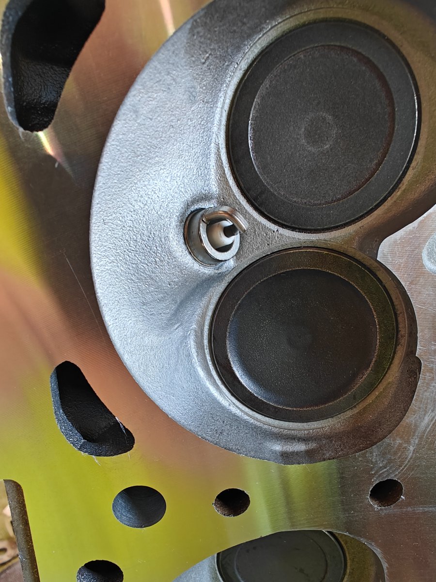

Leak testing as we speak. I assume this is what you meant Uncle Gump? Denatured alcohol down the ports to see if it leaks through the valves? So far so good but at this point definitely worth checking!!!
I would assume a leak would show itself fairly quickly with denatured alcohol since it's so thin? After a quick Google search it was the best way I could drum up to check in a hurry
You're correct...
I typically used mineral spirits.
If they leak... it will happen quickly.

Awesome, thanks Uncle Gump, I did them all for 15-20 minutes and they stayed dry as a bone. At least a small victory 😂

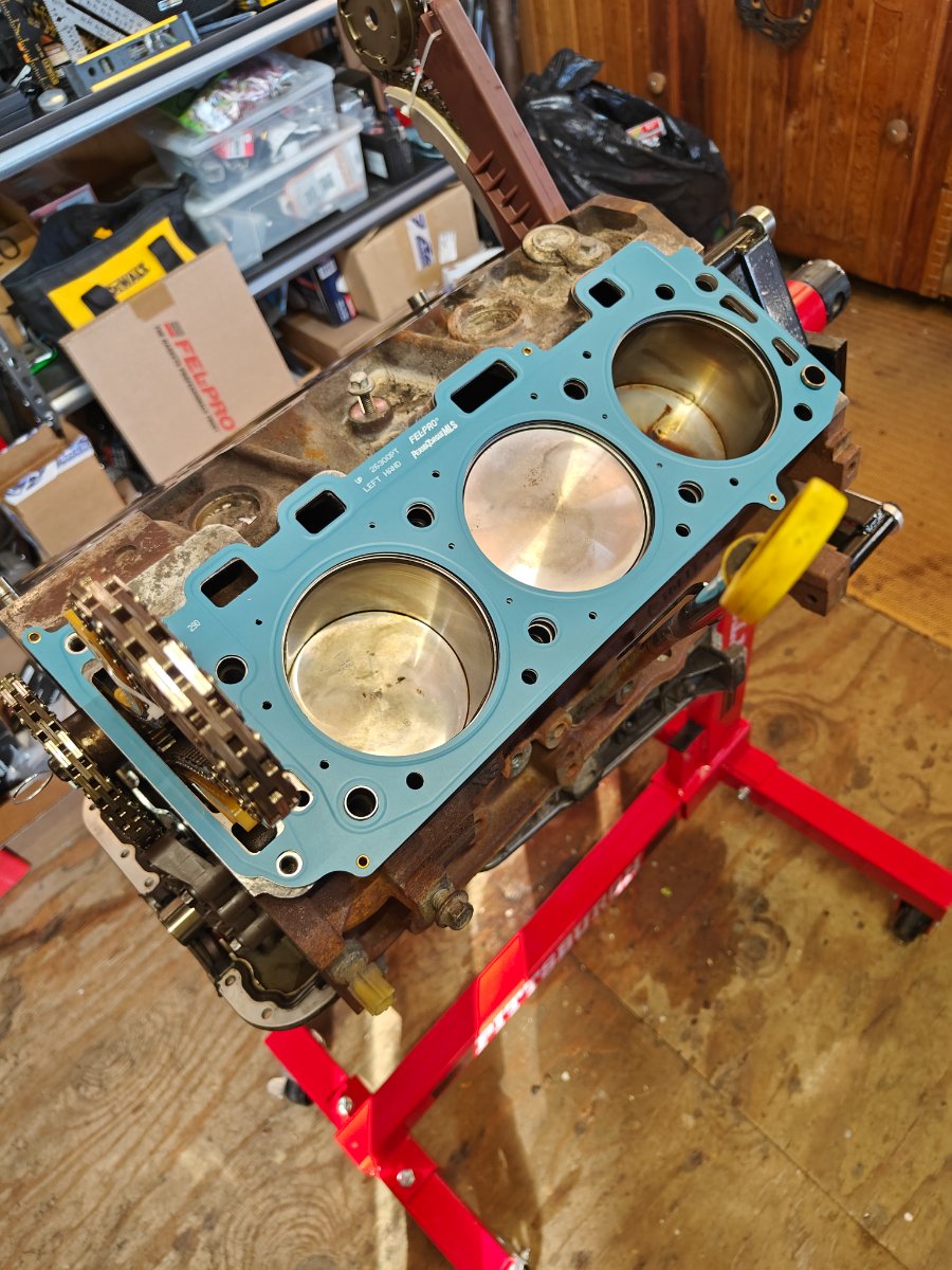

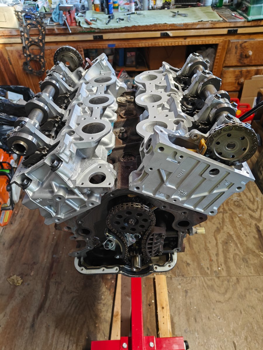

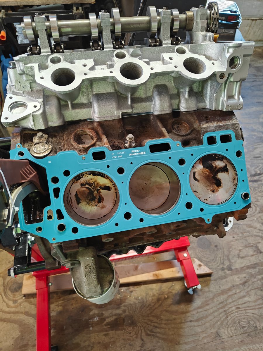

Head gaskets and heads installed and torqued down to sequence.
Did have another minor setback, one of the sparkplug holes had some funky threads so I ran a thread chaser through it and torqued in a fresh sparkplug before I put the head on in case it went sideways. I figure the head gaskets will blow again long before it needs another set of spark plugs😂.
I'll get the cams out this afternoon and replace them with all my old stuff.

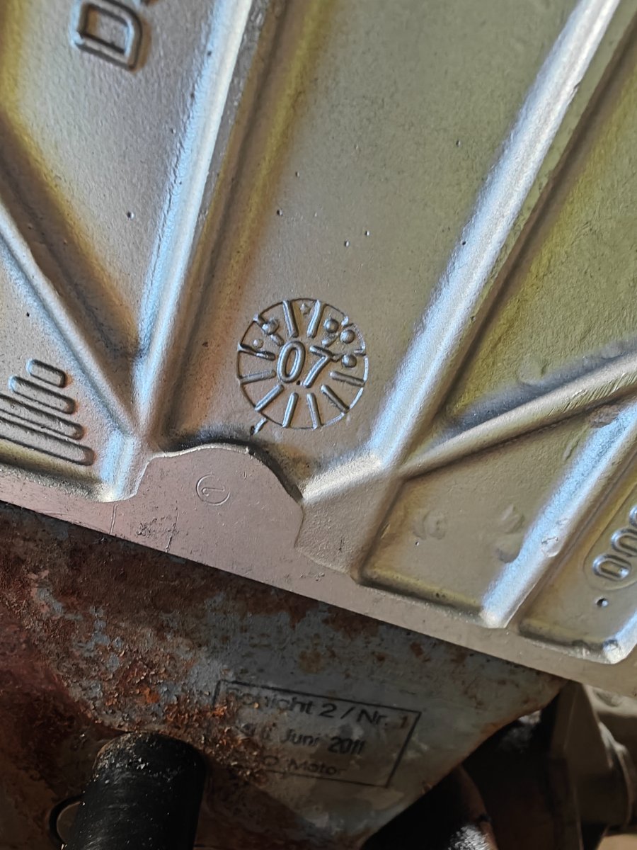

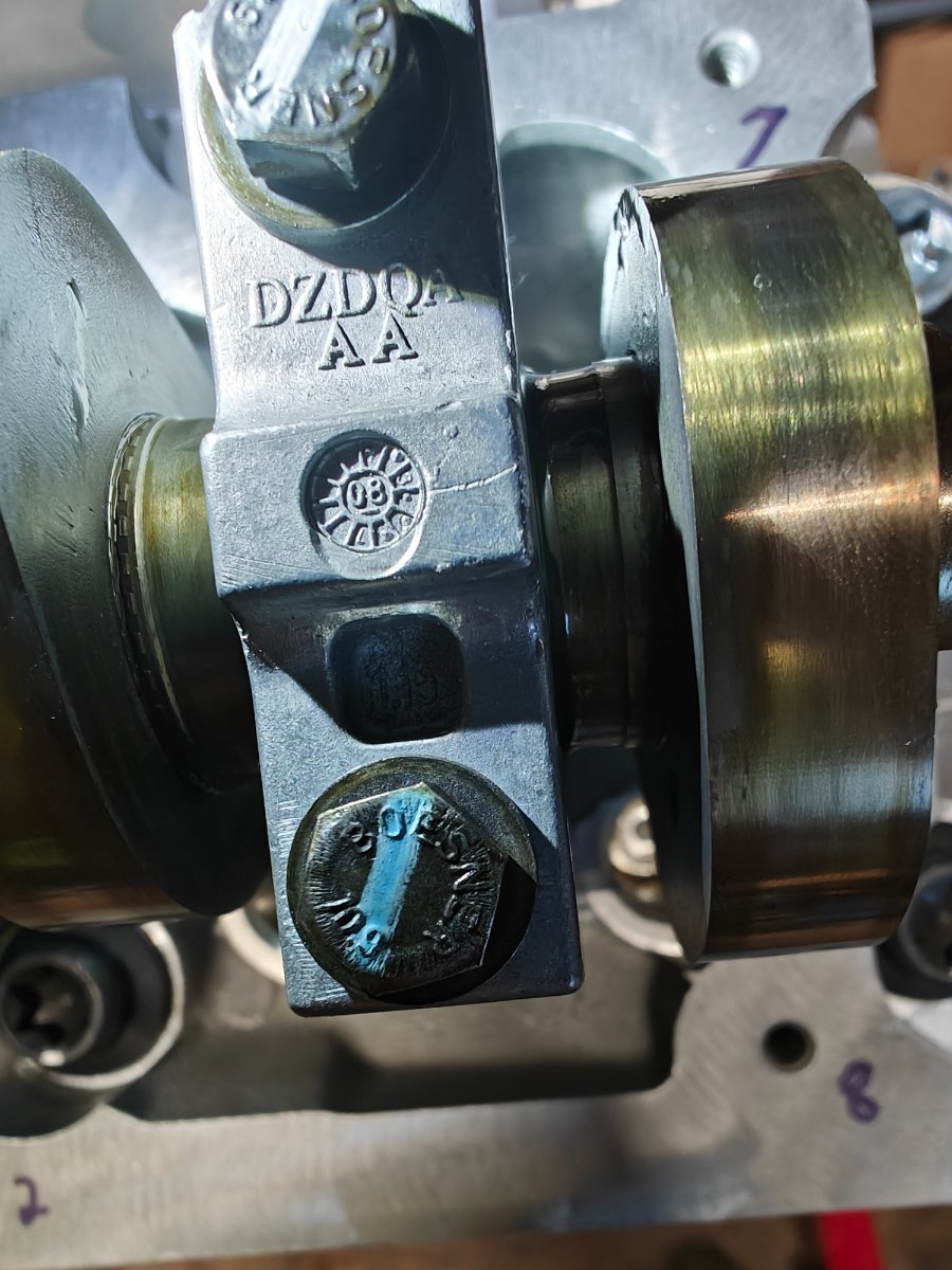

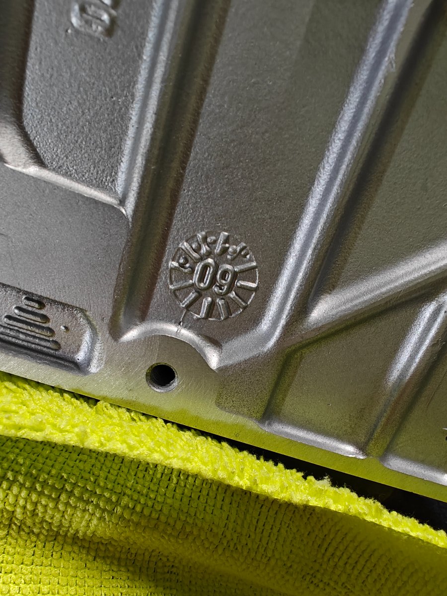

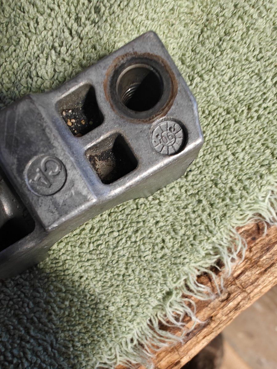

Neither of the cylinder heads have the correct cam caps I don't think. On my cylinder heads, the heads are both stamped '11 and all of the cam caps are stamped '11.
On these reman heads, the head stamped '09 has cam caps stamped '08
And the reman head stamped '07 has cam caps that are stamped '06. Is this normal, they should all be stamped the same correct? I wish I had checked before I bolted the heads on and wasted the gaskets and bolts😒

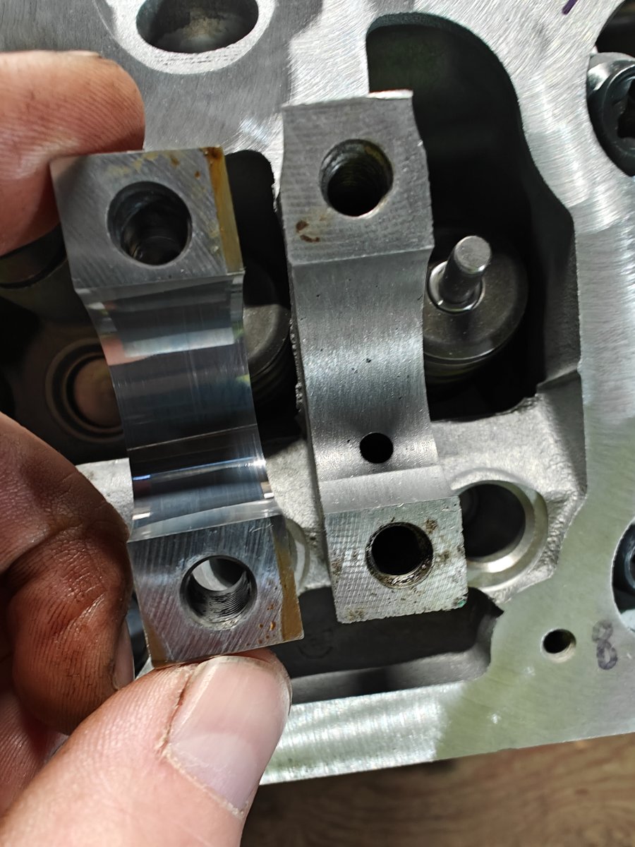

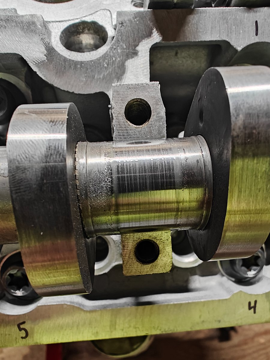

Also the bearing surfaces look awfully rough compared to the bearing surfaces on my heads.
The one cam I bolted in so far spins but not as free as it did in my head when I took it out. What do you guys think, one, about the different cam caps and two about the rough looking bearing surfaces?

Look at the lines on the cam after spinning it with some assembly lube on it. These heads are trashed no?

I would assume the number stamps may just correspond to the year the part was made and that alone wouldn't bother me. That bearing surface though...yikes. I cannot imagine why that would be OK... is there a separate bearing in the caps like you'd see on a crankshaft or are the caps the bearing (thus replaceable/wear item themselves?)
Hope someone who has been inside a SOHC engine will chime in here, sorry my experience with those is zero but I've been inside plenty of other engines and that does not give me warm fuzzy feelings.
On the bright side here you could be dropping a reman engine in right now, blissfully unaware of the problems, or paying someone else to do that and you'd both be raging mad when it destroys itself... so there's that. At least you can see what you're getting.
100% I'm not even going to stress it. I wish I wouldn't have bolted them on wasting the head bolts and gaskets but thankful I didn't try to run them.
No separate bearings, the cams ride directly on the aluminum of the cylinder head and caps (like what I've seen on all of the Japanese motorcycles I've worked on).

I checked the valves on my heads and some are leaking so it looks like mine will need a good rebuild (and hopefully it's a GOOD rebuild). I've got more confidence in my local shop then I do another reman head.
