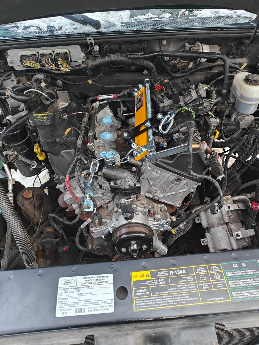

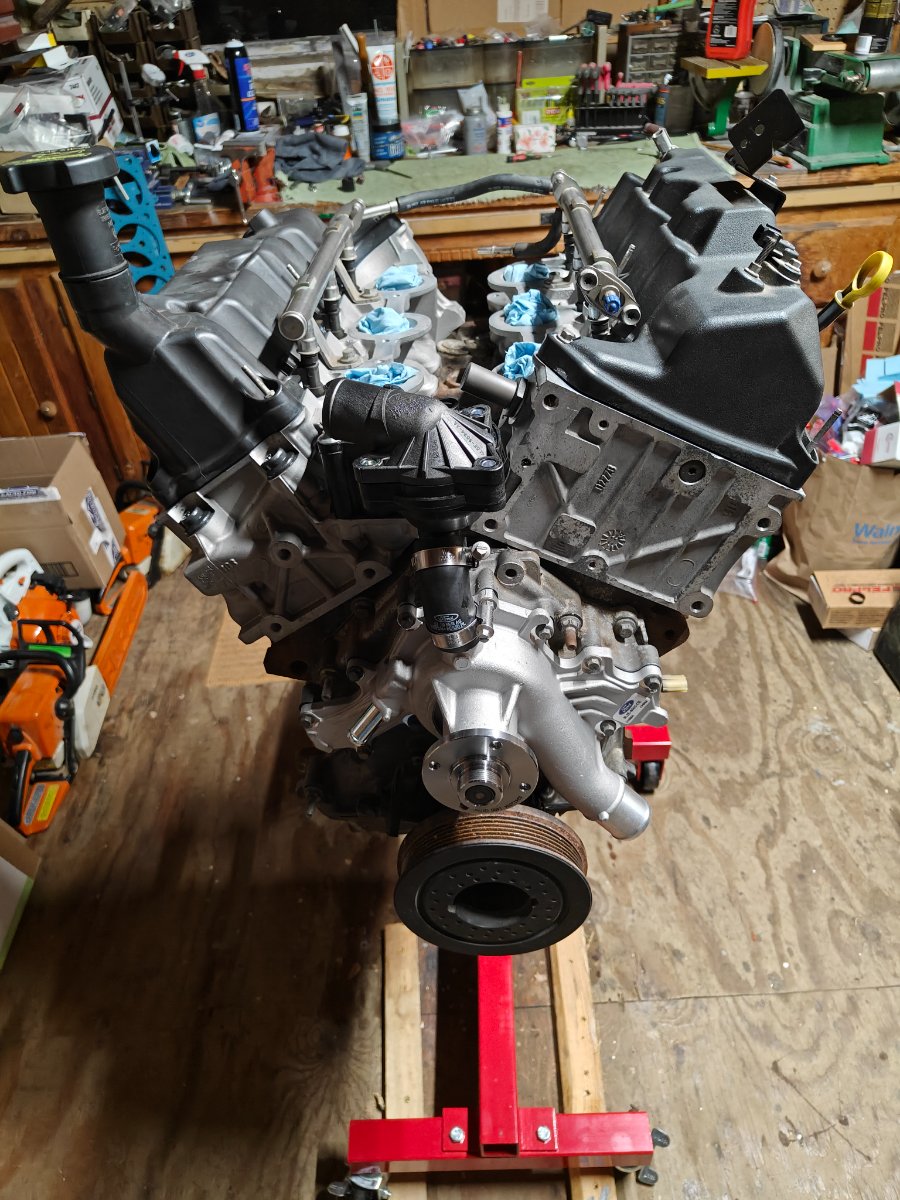

Almost ready, just gotta dig my old thermostat housing out and get the bolts off the cover and find some slightly bigger hose clamps (I have some somewhere for it), these ones are only on by a thread. Hopefully I can recruit some help next weekend to drop the engine in.
4.0 SOHC head gaskets/timing chains
Oh I just remembered, studs, exhaust manifolds and EGR too. Minor details. It's nice to see the pile of junk shrinking finally 😆

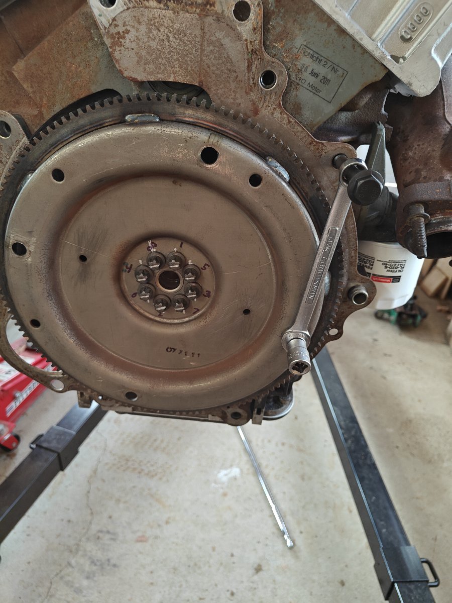

I have to share this trick I found on the Internet for torquing the flexplate bolts (and harmonic balancer). Put a bolt through a wrench and then I used a 10mm allen socket that fit snug in the flexplate hole. Very solid and allows you to torque everything no problem. Kudos to whoever figured it out.

The eagle has landed! Thankfully some help showed up and helped me drag it out of the shop and into the truck. Only 6 bolts in the bell housing so far and the engine mounts on but it's in the truck.
Tomorrow early I'll start on the rest of the bell housing bolts and the. Torque converter nuts.
