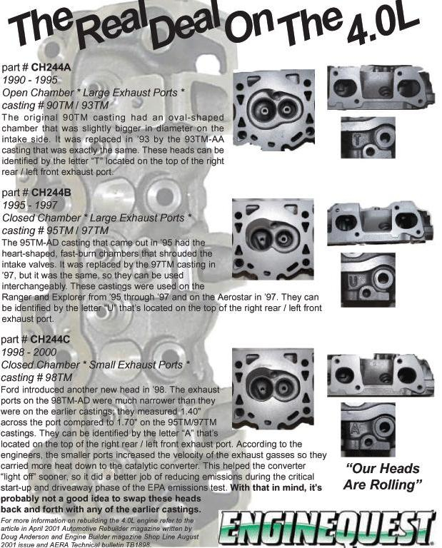

Supposedly the 95TM/97TM heads are the way to go with the small chambers and large exhaust ports. I found this recently that was kind of enlightening:
Thats actually super helpful. I do know through my work i can get aftermarket heads that are less prone to cracking. Im pretty sure most of the aftermarket heads are based on the 98tm but if i can get the 95/97tm heads in aftermarket that might be a better way to go
I don't think that any of them are really "bad" heads as far as cracking goes except for the 90TM ones maybe. That said I have almost 200k on mine and my buddy down the street has over that on his...still going strong. Cooling system maintenance is just more important IMO.

"bad" is relative ig lol. Since i work in a engine building shop we see the most common failures of engines. as a point of reference we have shop cores of heads for almost every head we work on... except the 4.0l because every head we work on has been cracked. not sure the location because its thru the shop but i think its EPWI could be wrong but i do know thats where we get a lot of our parts. i can ask my boss tuesday and update you https://epwi.net is the website link but its something you have to register to have access too. we have been a part of the engine builders association for like 20 years so we do have access to lower prices and websites that most people dont. that said i can easily get pretty much any spec for any of the ranger engines easily for anyone that needs it through PROSIS our shop program.
