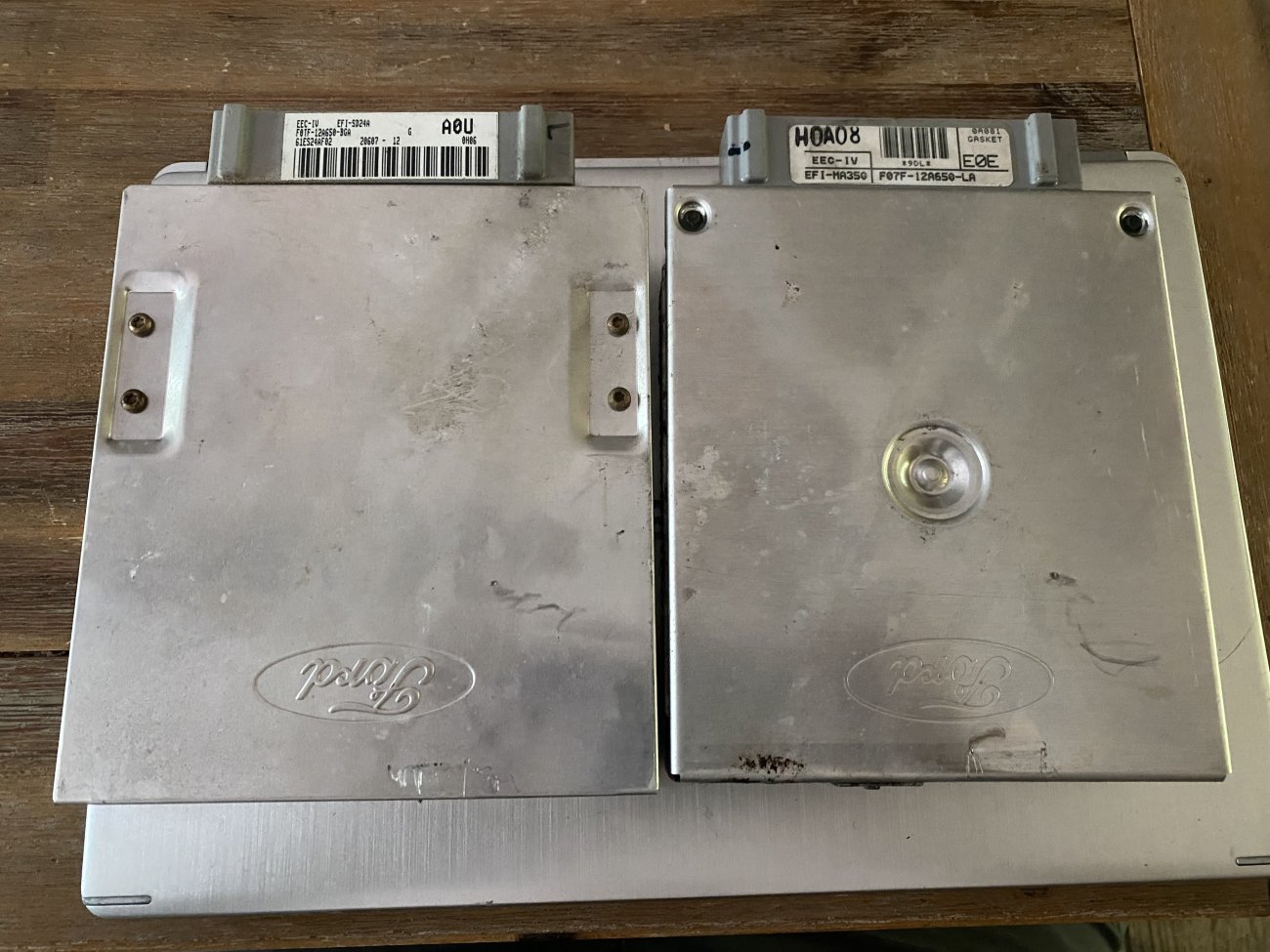

(pictured left is the 2.9 computer I pulled/ pictured on the right is the unidentified potentially 4.0 computer) Hi everyone, I need help identifying the computer pictured on the right. Im currently in the process of a 2.9 to 4.0 swap. I’m unsure if this computer is for a 4.0, I have already looked up the part number F07F- 12A650-LA but results have come up inconclusive. I also have the wiring harness that came with it, I need a smoking gun that tells me this is a 4.0 computer and harness. Thanks in advance.
4.0 computer identification
Above info looks good to me. Although I did find one listing on EBay claiming to have the same part # for a 90 2.3 MT...
I'd be more inclined to believe the ebay listing is wrong than the RockAuto or the other site. It seems like an enthusiast built thing...

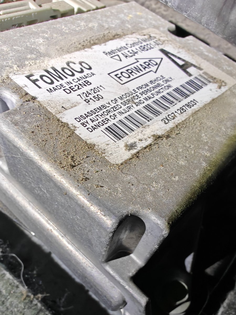

Is this below the dash under the carpet? If it is, I have mine exposed enough I could probably see the part # and take a photo. I have the 4.0 SOHC, I'll take a look I'm a few.
Edit: disregard I'm a dummy. The box under the carpet is the restraint control module
No. On yours that computer is in the cowl. On a 1990 it’s behind the kick panel under the dash on the passenger side in front of the door.
I forget offhand what that module under the dash of yours is, I want to say it’s the restraint system module. The 4x4 GEM is in the dash on the drivers side of the radio.
You are correct I just went out to snap a picture for him
