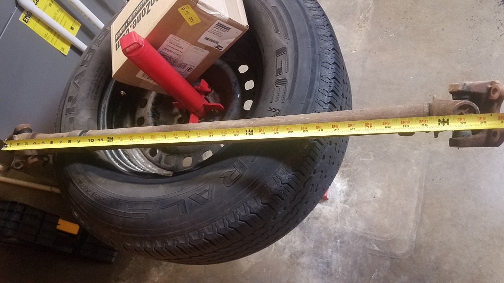

Does anybody know where to source measurements for a 4.6 F150 front driveshaft? I was handed a 97-03 F150 front shaft the other day but I don't know if it's the right length. It appears to be about 38" yoke to yoke.

I had one in my 2000 explorer before I started my SAS on it. I'll see if I can find it laying around somewhere and grab a measurement.
That would be great, thanks!
I did just realize that Rockauto lists the length in the specs of their shafts. Looks like 22" weld to weld on the 4R70W trucks (4.2 or 4.6) and 21" for 4R100 (4.6 or 5.4). From the picture I took the other night, mine appears to be more like 25" so who knows what it's out of...
Mine measures 21" weld to weld, 33" center of cap to center of cap as it runs in the truck.
It has an extension thing to it, not sure how far it goes since nothing really moves aside from the t-case wiggling around.
2002 5.4 with a 4R70W, I would think it is the same as a 4.6.

Mine measures 32in from center of cap to center of cap as it sits from my 4406 transfer case to front diff. That's close to all the way compressed.
Thanks for that. I'm supposed to be picking up a manual case with linkage and boot plus both shafts from a 4. 6 4R70W tomorrow. Will be sure to post measurements for comparison.
I'll take more careful measurements later, but at first glance this morning when I pulled the front shaft into the garage, it was nearly 23" weld to weld. I didn't visually confirm the engine and trans when I pulled the 4406 off the back, but the owner indicated it was a 4.6/4R70W, and I took it off myself.
