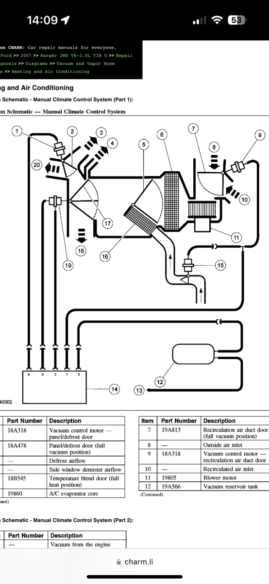

I know this thread kinda went quiet I made an account just to reply, I have been looking into this myself, it seems their is a big enough void between 17 (mode door) and 16 (heater core), while this is a tricky spot it is possibly a space where you could make a filter work, I’ll try it out next time I’m at the junkyard.
alternatively, the more sketchy way would be to put it where the air recirculation door is behind your glove box and use some zap straps or likewise to secure it to the plastic webbing behind said door.
