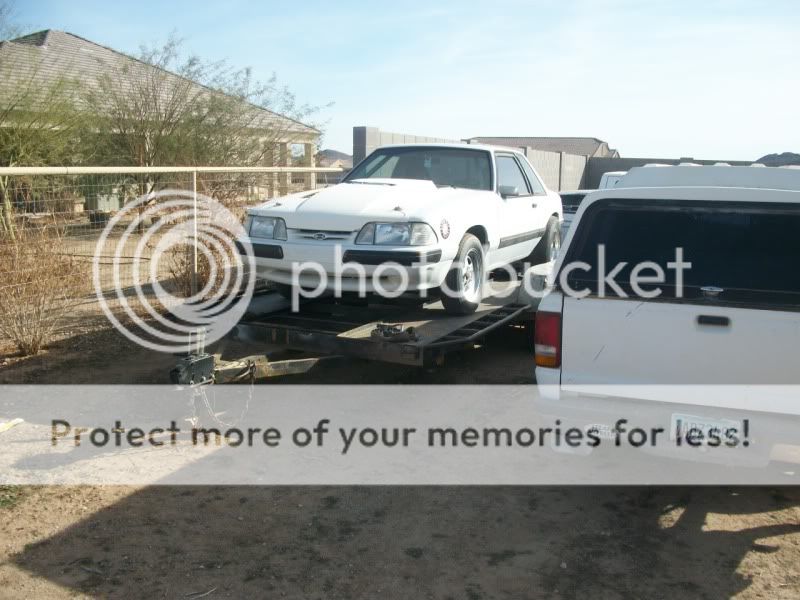

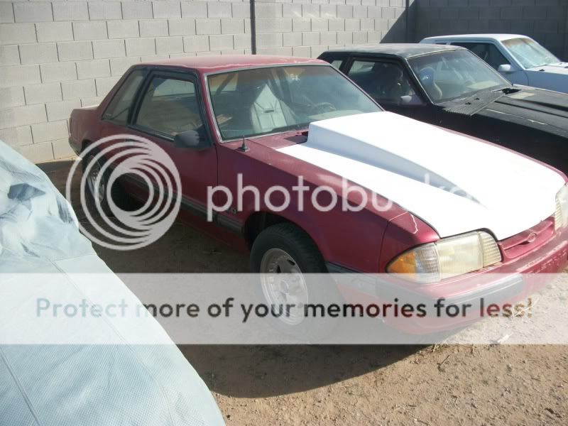

If I find any Clevelands out at the track (I dought it) I will be sure to make sure and race them with the Mustang (all 840hp Windsor)sitting on my trailer right now. If that makes them look silly and I know it will :icon_rofl:I will pull out my 91 Mustang coupe with an old school Windsor that I built over 17 years ago to give them a better chance of hanggin with a Windsor powered car.:icon_rofl:

Well AZ dyno chip dyno'ed and tuned it and according to their dyno thats what it makes. The car runs in the mid to low 9's and best MPH was 142 so do the math for yourself and figure it out.
When did I ever say that a Windsor had a 9.2 deck block? That was flaminranger so you probly should get your facts straight before you post them again.......:D
Sorry, I don't take3 internet brags as fact, same as you don't believe what's printed in books.:dunno:
