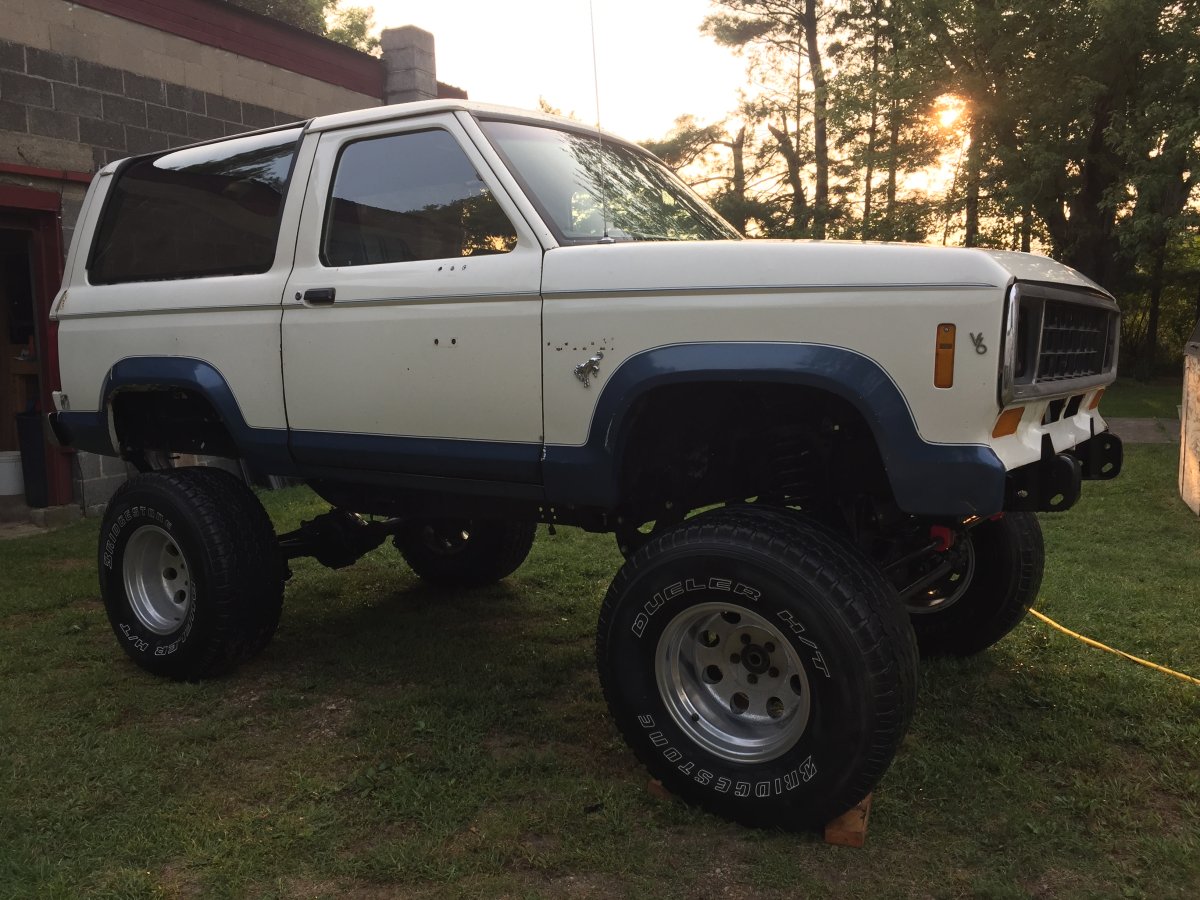

I've got a first gen BII that has a set of 33 12.5 15s on it. I didn't want to cut my fenders so I lifted it. Tech section has a good chart for tire size vs lift. I put a skyjacker 6" lift with 2" body lift. A bit too high but it all on there now. I'm thinking of going with 10.5s and taking the body lift off. Then I'll need new rims too. These are 10" wide.

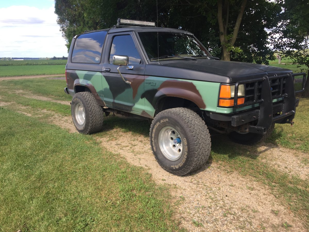

I tried them on my 89 which has just 3" body lift. I had to trim some of the front fender and have a custom front bumper. Factory bumper would be rubbing. This set up is OK on the road but I think it would rub if I flexed much.
My skyjacker lift is by the piece not a kit. Using factory radious arms. Rear is all spring, no blocks.
