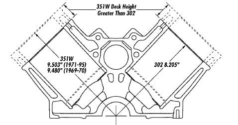

I know the 351W is wider and taller. Anyone know how much taller it is at the exhaust? Any deeper between the oil pan and the engine mounts? The exhaust is tight to the floor now on the PS side and the oil pan is tight to the crossmember... I don't have a ton of wiggle room there.
Any 351W header pics (especially Hedman 88400's) would be much appreciated too.
302 vs 351W
I think it's 1" up and out but I could be wrong. If you look at the water pumps water ports on a 302 they're flush with the head mounting surface and on the 351 they're about an inch higher pushing the heads out wider. And I think the oil pan is about 3/4" deeper than the 302. But really I've had a 302 in my ranger and a 351, with the 351 being spaced up 1" from the engine mounts for oil pan clearance it seems like any header I tried on the 302 would still work on the 351. I've never had the 88400's but if I wasn't so determined to get longtubes on my setup I think they would fit no problem. My $.02

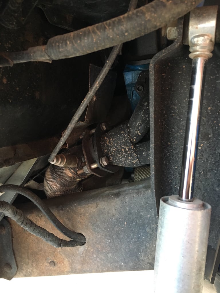

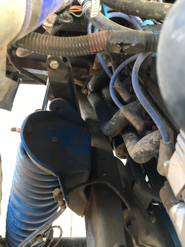

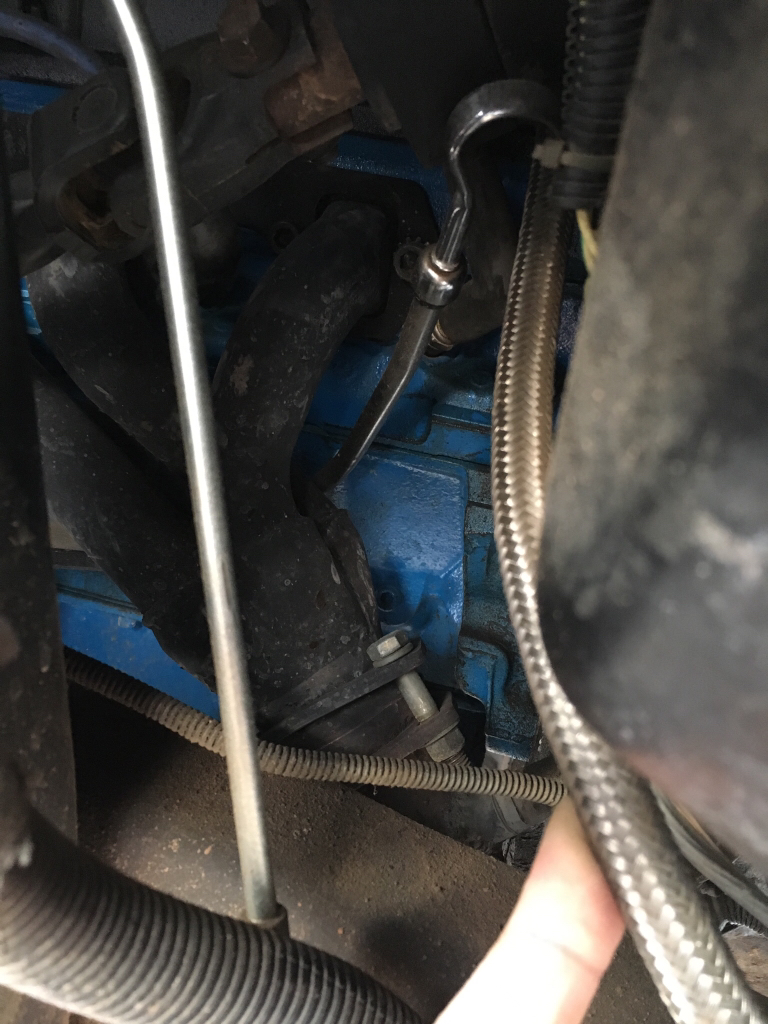

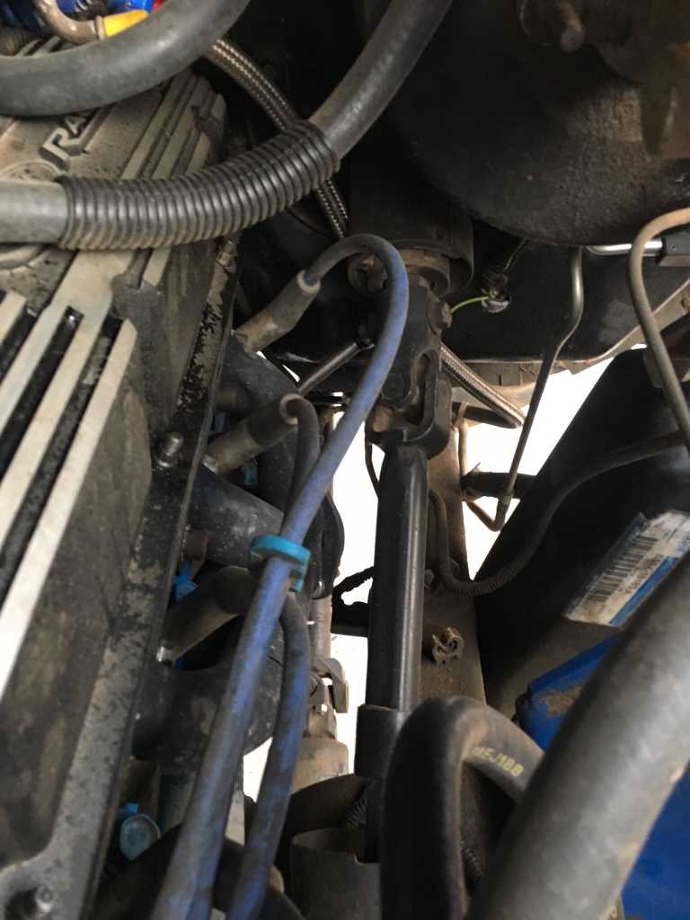

I have a 351w and 88400 headers in mine, I'll get some pictures for you. I have zero modifications to the frame rails just a small dent on the passenger side floor pan
Kind of hard to capture everything in pics
Passenger side

Driver

I made my own motor mounts, its as low as possible without the oil pan hitting the k member and as far back as possible. I had to clearance the driver side firewall slightly for the head

Good point with the floor heat bobby. I have removed all the sound deadner and put monstaliner on the floor. The passenger foot well would still get very hot. I put some adhesive heat shield in that areas and also wrapped the exhaust on the passenger side, as you can kind of see in the picture. That helped a lot with the heat control. Floor still gets warm but not too bad
oh, its definitely livable and mitigated to tolerable with the heat wrap....but here in the rust belt its going to murder the head pipe with wrap...but even that is tolerable as most dont drive the miles i do....should get a good 5 years out of that, a well built bolt in replacement piece makes it a non issue.
just look at your frame from where the cat was with the v6....
overall, you like em better then the log style for availability, and i do think they are the best option going for cost and ease of use. with a 2-3 in body lift its a no brainer.
