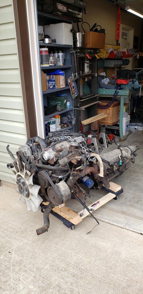

Here is my candidate for the build.

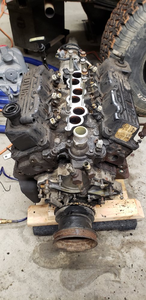

And here is what it looks like after today's fun session.

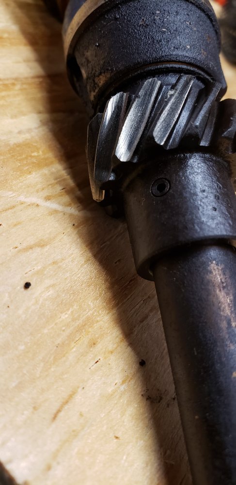

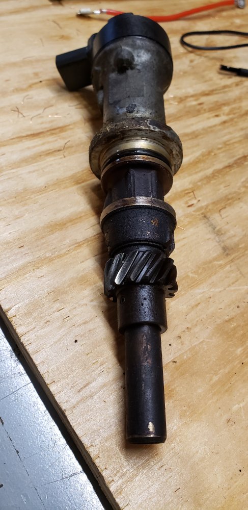

This was on borrowed time. Gear is worn pretty good.

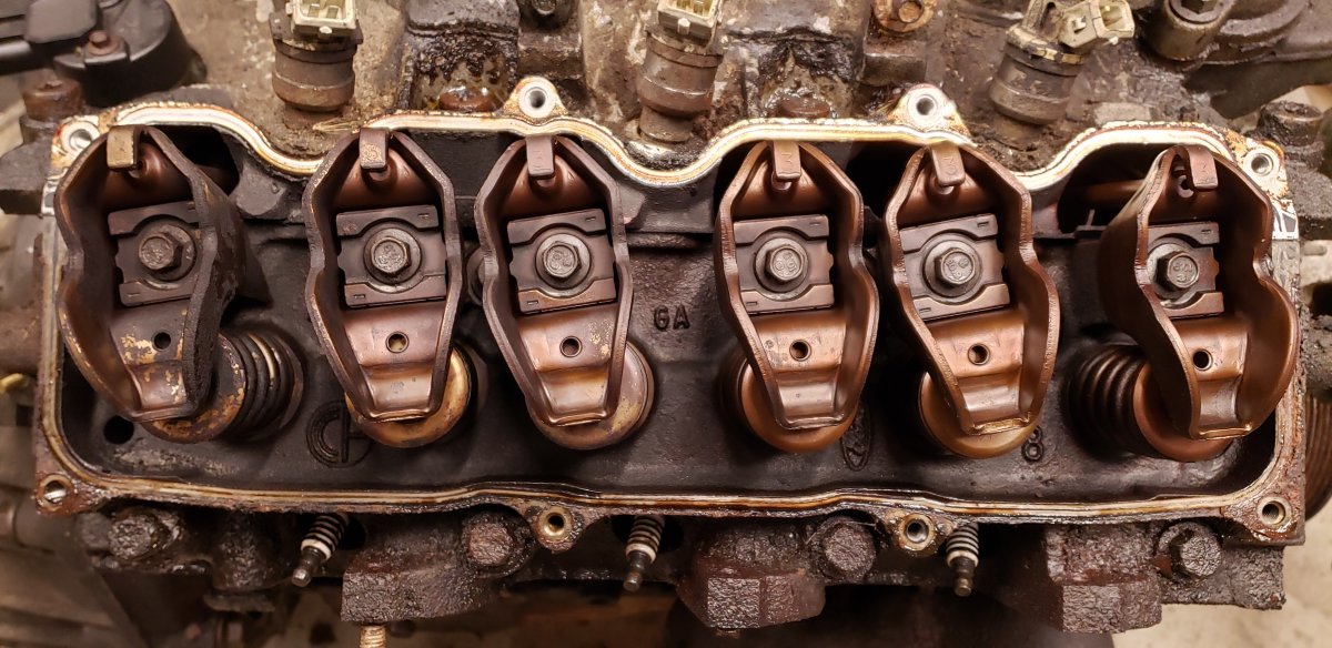

Valve train is nice and clean on both sides
Plugs and injectors all looked good. It appears this engine was well cared for. I'll pull the heads after I get an engine stand.

Any idea how many miles are on it?
Don't recall at the moment I think he said it was just under or maybe barely over 100k. Not too bad. It's in a thread somewhere around here.
that engine had a bit north of 180,000 miles on it, (183k maybe?) I bought the truck it was in for $500, found that 1st gear was out (could start in 2nd and shift to D above 30) Truck had 3.45’s , was a reg cab longbed. I took the bed off and found a few frame issues. Made a flatbed for it and put it up for sale, one day I had it out in a feild and tried to donuts, endend up on its roof. Salvaged what parts I could and made back half into a trailer. before it was shut off for the last time I put stabil in the fuel and seafoamed it, I had changed the oil shortly after I had first got it. I still have the drivers door, hood, Title, VIN tag, grille and front bumper (plus all the parts from it that went into my ‘94 I drive now) Ive never thought the 3.0 was a bad motor, just that 90% of them in the ranger chassis are geared way too high, this engine likes to be above 3,000 rpm but with 3.45’s at 55 in o/d its about 1600, maybe 2,000 if you turn off o/d. My inital plan was 4.10’s and 235/15 tires. I feel I did get $500 out of it in useable parts and was glad to find the engine a new home, If I didnt have to come up with a transmission I might have considered it for my ‘94. I want to build a V8 ranger someday, but I need a better rolling chassis. Looking forward to seeing this build come together.
Thanks for adding that info to this thread. I know I haven’t seen the cylinders and pistons yet. But so far it doesn’t look like 180k miles to me.
