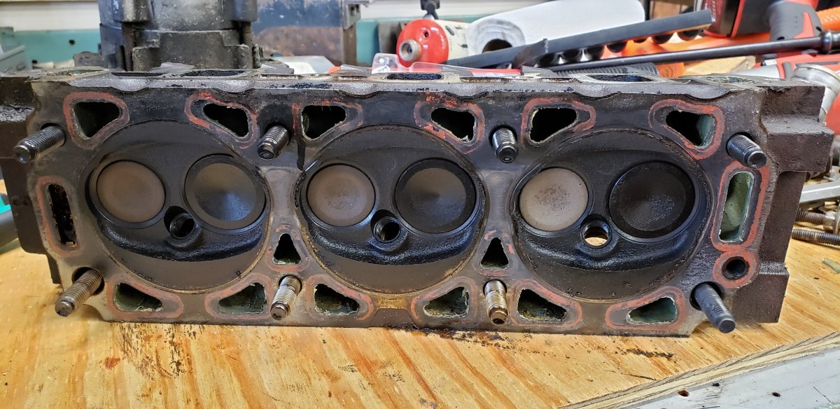

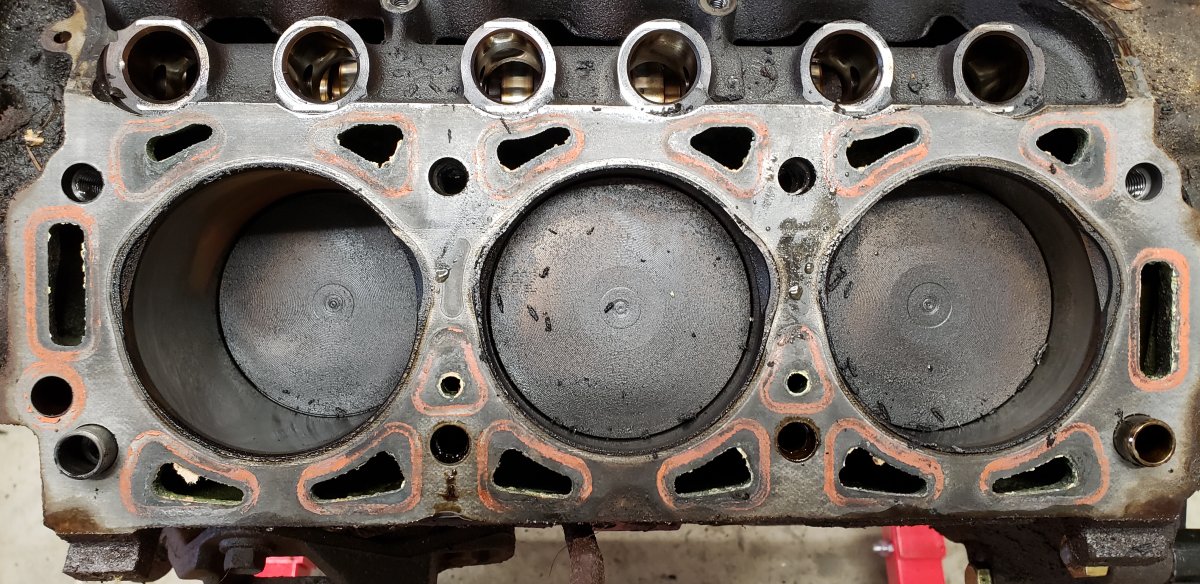

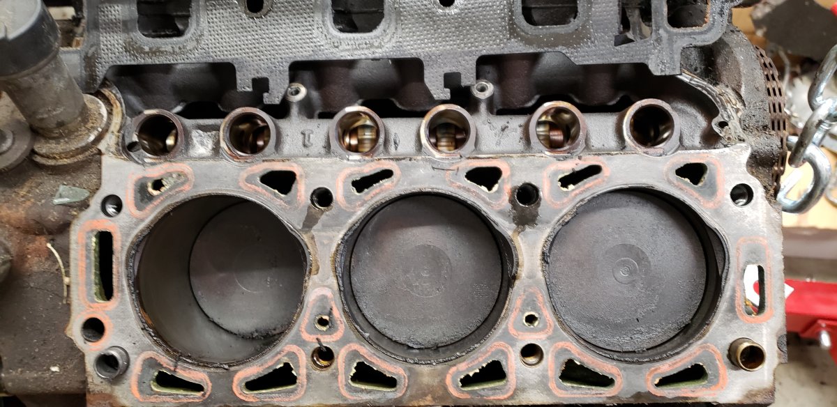

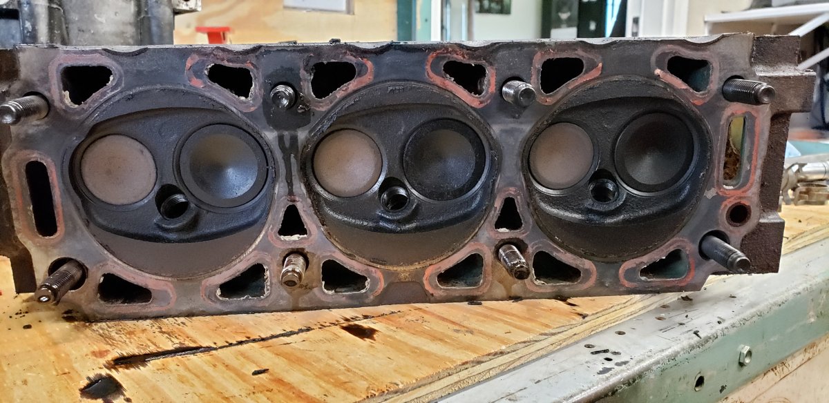

Did some more teardown this weekend. It all looks pretty god to me. Cam and lifters look ok. I pulled the heads and the cylinders and pistons look ok with a little bit of carbon buildup. Didn't make a detailed inspection of cylinder walls yet. No obvious scoring or heavy wear. No signs of any head gasket isdues. I put the heads back on so I have a place to keep the hoist bolted up as a safety. I still need 2 longer bolts for attaching the block to my engine stand.

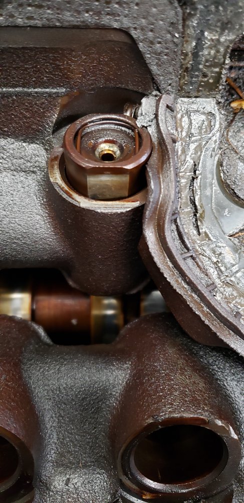

Intake gasket was rubbing on two lifters.

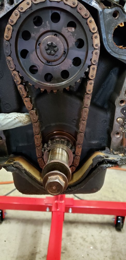

Looks excessively "floppy-woppy" to me.

given the miles on it the timing chain slack doesn’t surprise me. Looks very clean inside, howd the bottom end look?
Haven't rolled it over yet. I need a pair of M12x75 bolts to properly attach it to the engine stand. I'll probably have a pair of those when I get home from work Tuesday.
Interested to see how it comes out. I like the design, it's a simple, basic iron block and head 2-valve engine, but it's well done and has an up-to-date valve train. The valves seem to be decently sized.
I see the rear lifter bore on the passenger side has an oil channel for the sync unit. too bad there isn't a way to get the oil up the shaft
to the top bushing.
to the top bushing.
Something to think about. Wonder if I could take some measurements and drill a hole.
