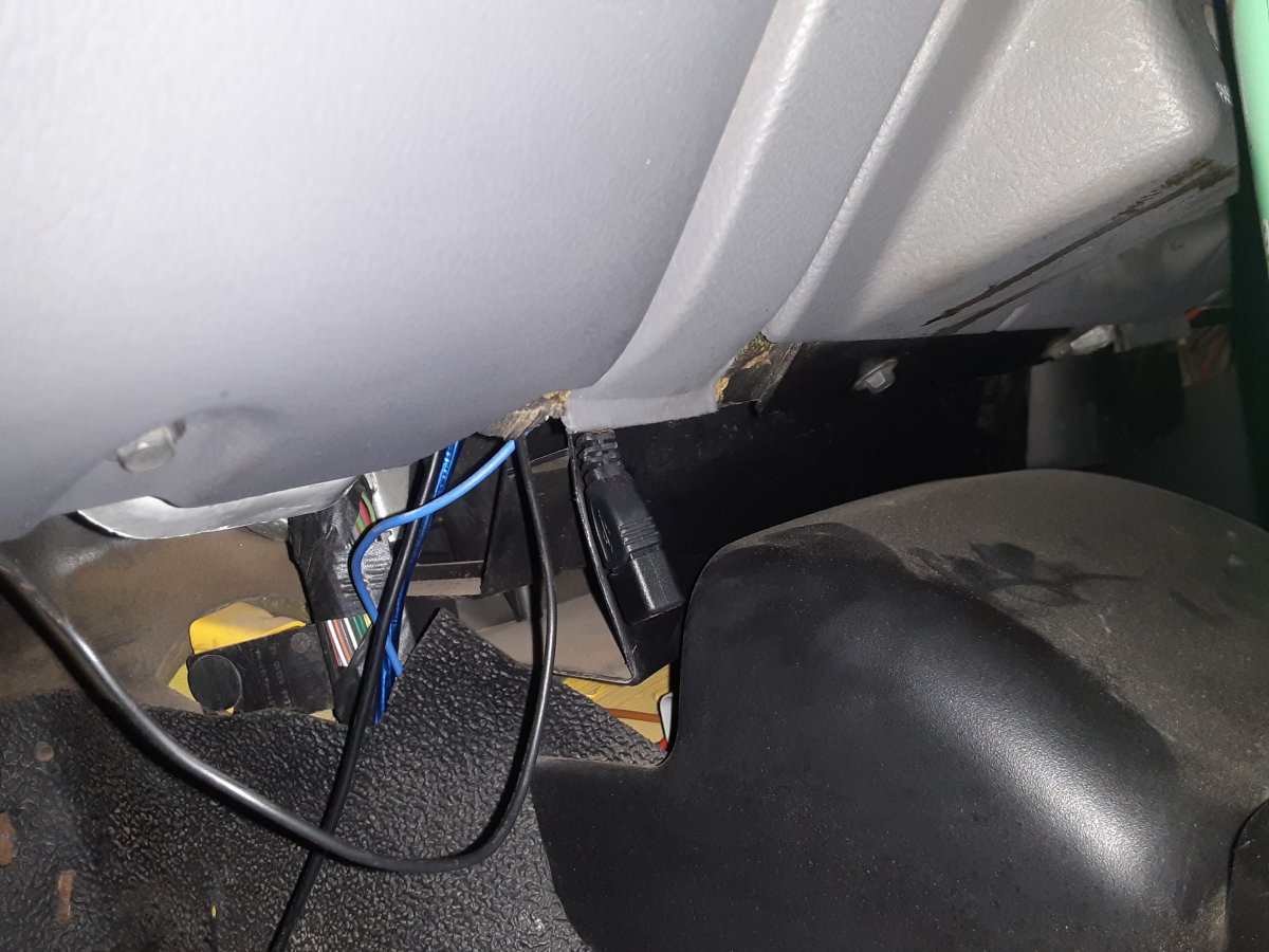

My 02 3.0 is running bad, almost sounds like it's missing firing or not running on one cylinder and it back fires quite a bit. I've replaced the spark plugs wires fuel filter IAC and the downstream o2 sensor. The fuel pumps working fine and I'm at a loss. It's throwing a code but can't read it due to the previous owner deciding the normal plug in for the code reader was for loser and putting in a USB. I'm in the process of replacing the upper o2 sensor but one won't come out. Any help is welcome I'm just at a loss of what to do.

Can you explain the USB thing a bit further?
There is a female usb up under the dash like they wanted to access it to change fuel air ratio and the truck doesn't talk to the reader
I agree. Have a picture? Maybe he just plugged in some kind of adaptor that you can remove.
A bad o2 sensor will not cause a misfire. You should start by checking that your coil pack is firing on all 6 cyls.
I forgot about coil pack and I know was just listing things that i did recently. Also for those about the usb here's a picture.
Aftermarket radios can have a USB input in the back of the HU for a ipod or usb thumbdrive. My F-150 has one and my Ranger will when I get around to getting my new radio installed. As of right now it's USB input is on the front.
I suspect yours is something similar.
