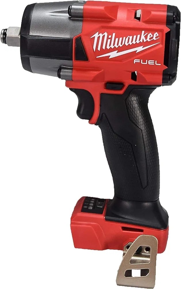

I used a 1/2" impact on the crank bolt and it came out easy. Used a loaner harmonic balancer puller/installer and no problems there either. Hand tools on the rest. Few of the bolts were fairly corroded but nothing broke in my case.
