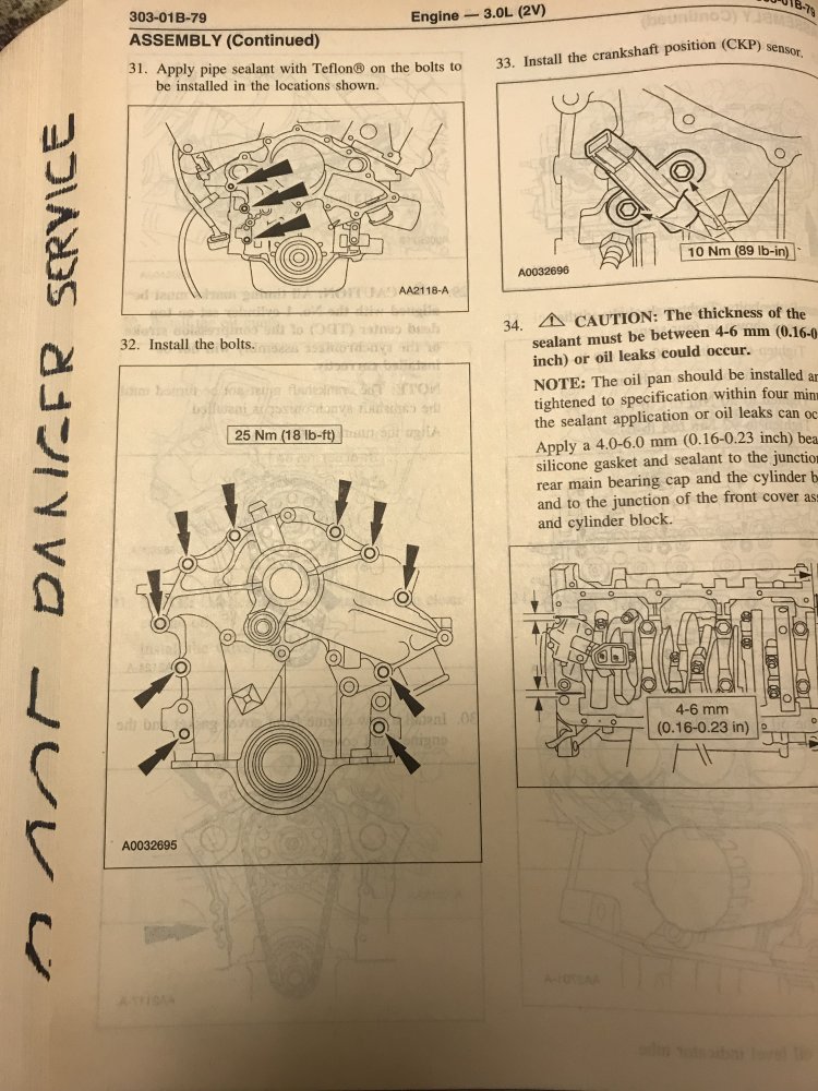

your torque specs are off.
the 7 ft-lbs is ok for the small coolant pump bolts going into the aluminum timing cover. the bigger bolts & studs are 18 ft-lbs.
3 of them use sealant.
Yes, I had the torque specs wrong. According to your diagram some of pump bolts get 18 ft lbs. And I probably didn't use sealant on the bolts. With just the water pump removed I couldn't see where the pump bolts bottomed. They probably looked like blind holes. I did use perma-tex on both sides of gasket. Where can I get a copy of that book you have?
