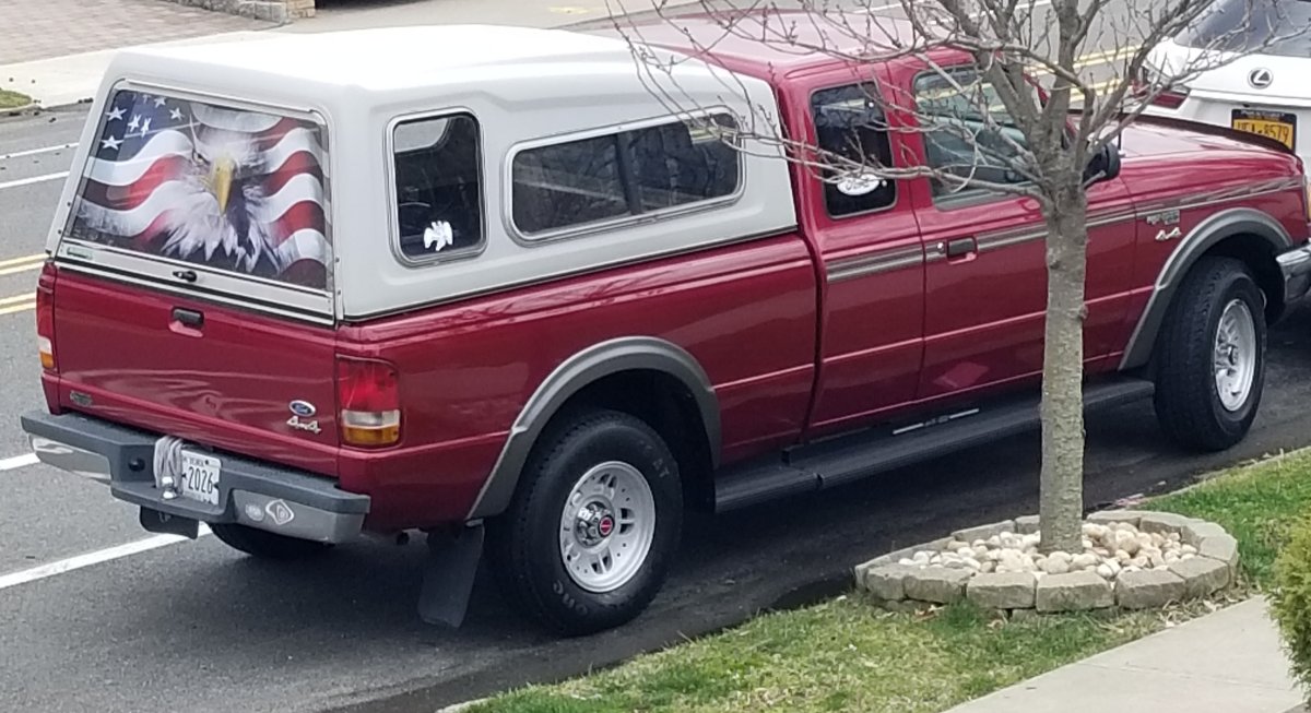

I'm battling with poor gas mileage currently. Stock 93 Ranger XLT Supercab. 4.0 132k miles.
I just did a full tune up, all filters, new wires etc.
I'm still getting a dismal 11mpg city and 16 or so Hwy. Going to replace the 02 sensors for a start. Eventually I may do the Electric Fan. Maybe I'll look into a new MAF etc. What else should I consider? Synthetic Oil...
